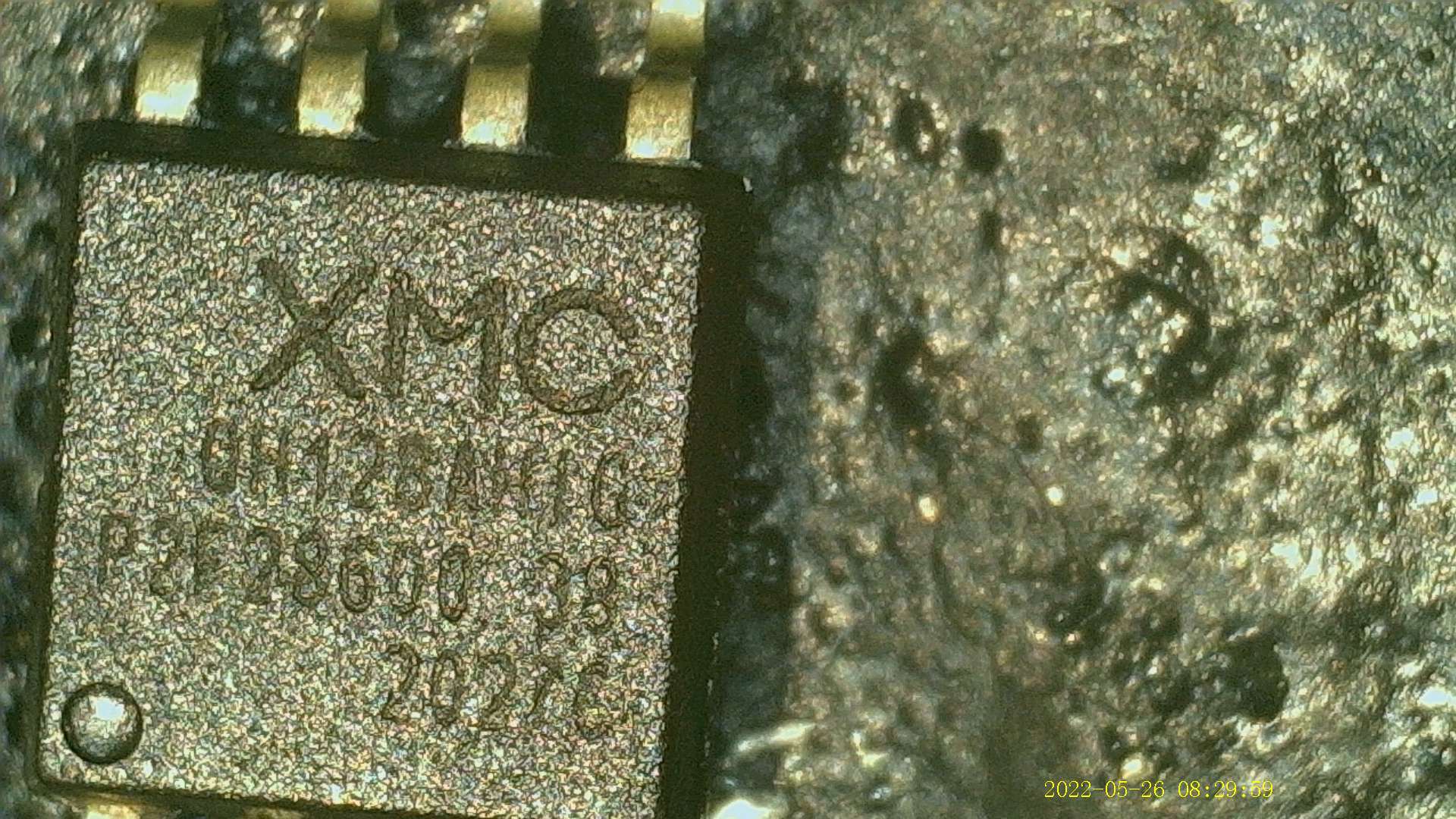

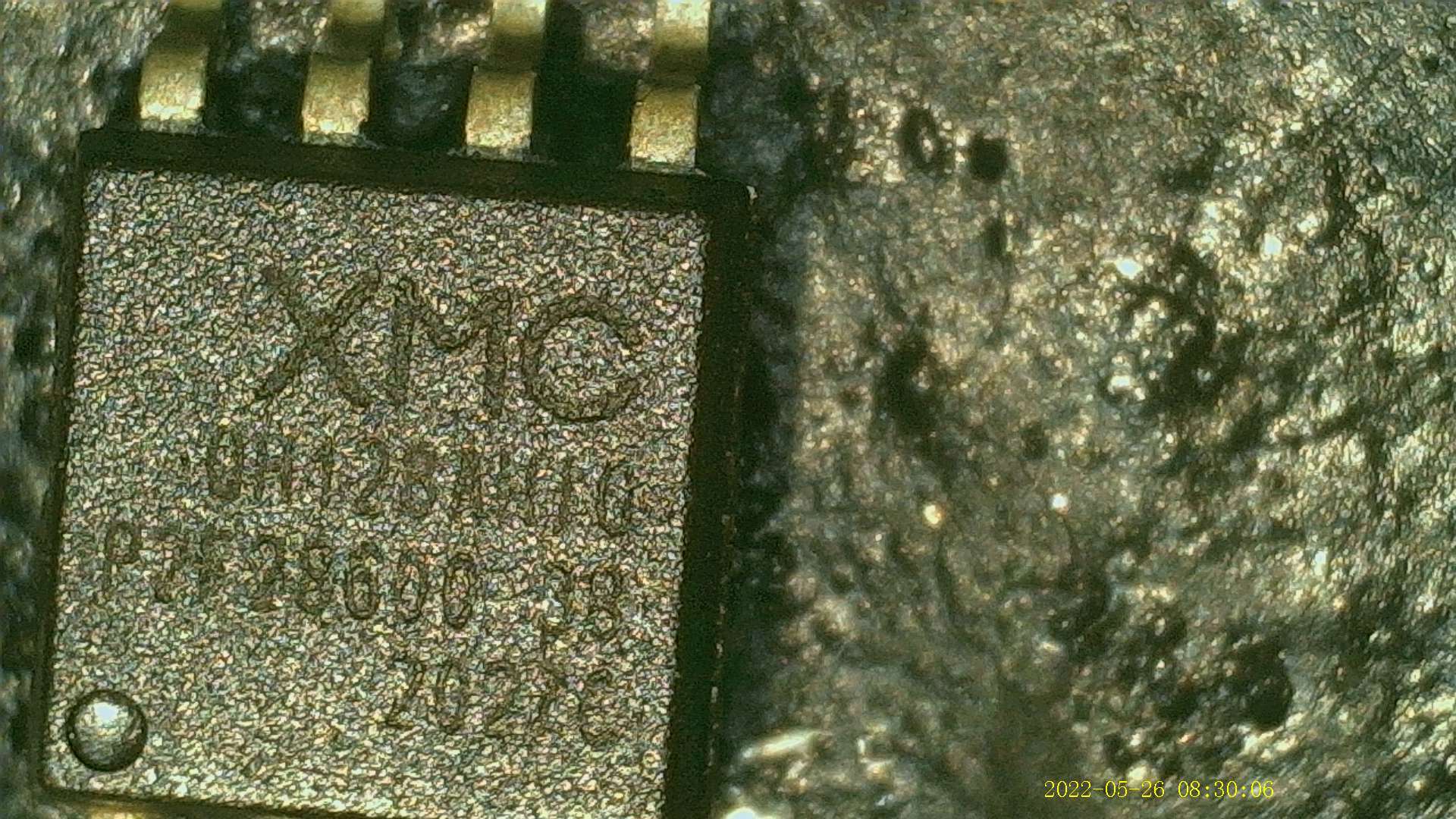

                  #88
                  Originally posted by volinakis View Post
                  your bios file length is wrong, it should be 16777216 bytes. What bios chipset do you have, what is written on it?
                  this is my pic of bios sir..thanks
                    #89
                    yep, read it again, the dump should have 16777216 bytes
                      #90
                      hello is this right ? thank you
                      the orig size if 16mb .. i compress it with rar
