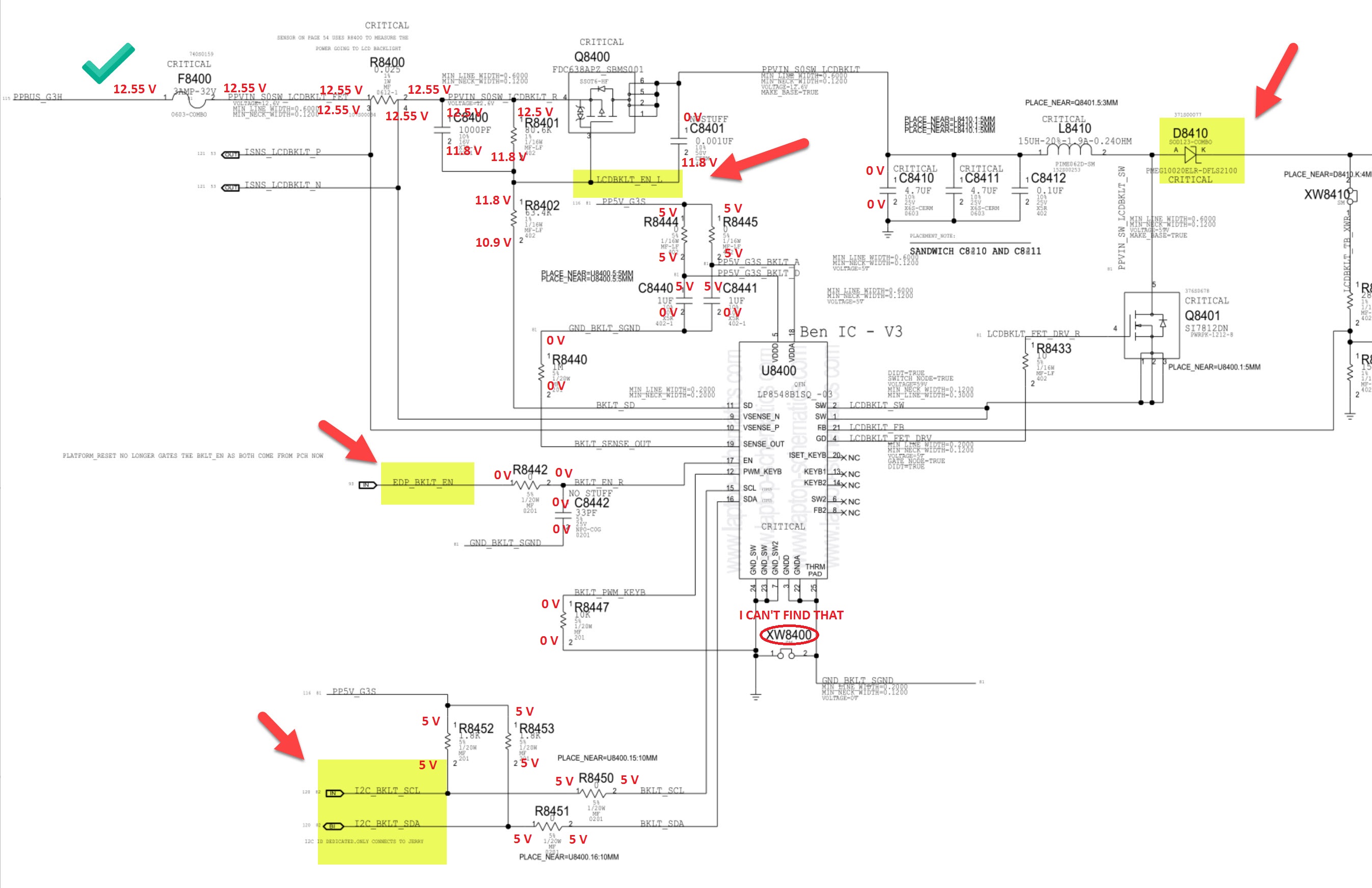

    Originally posted by mon2
    In diode mode testing, the RED lead, yes red meter probe to ground.
    Black meter probe to point to test.
    in diode mode ~545 on both testpoints J0200
    and continuity on VLED J0803

      Re: Macbook Pro A1990 (820-01814) no backlight display
      If the EN of u8400 (backlight) IC is 3v3 then this is good. The logic is wanting to enable the backlight.
      Confirm the voltage of each side of R8402 which is the resistor on the gate of the mosfet for the backlight.
        R8400 has 12.5V on all four pins
        UPD
        my bad, I thought you were talking about R8400
        now I see that you are talking about R8402
        UPD 2
        R8402 have 11.8 V on 1 pin and 10.9 on 2 pin
          No, I did update the post. It is correct as you have just posted.
          Is the EN pin at 0v or 3v3 (earlier post)?
          If 3v3 then backlight is enabled else disabled.
          • XVLZ
            • Nov 2022
            • 45
            • Great Britain
            EN is 0
              Do you still see an image with a flashlight on the display?
              • XVLZ
                • Nov 2022
                • 45
                • Great Britain
                yes

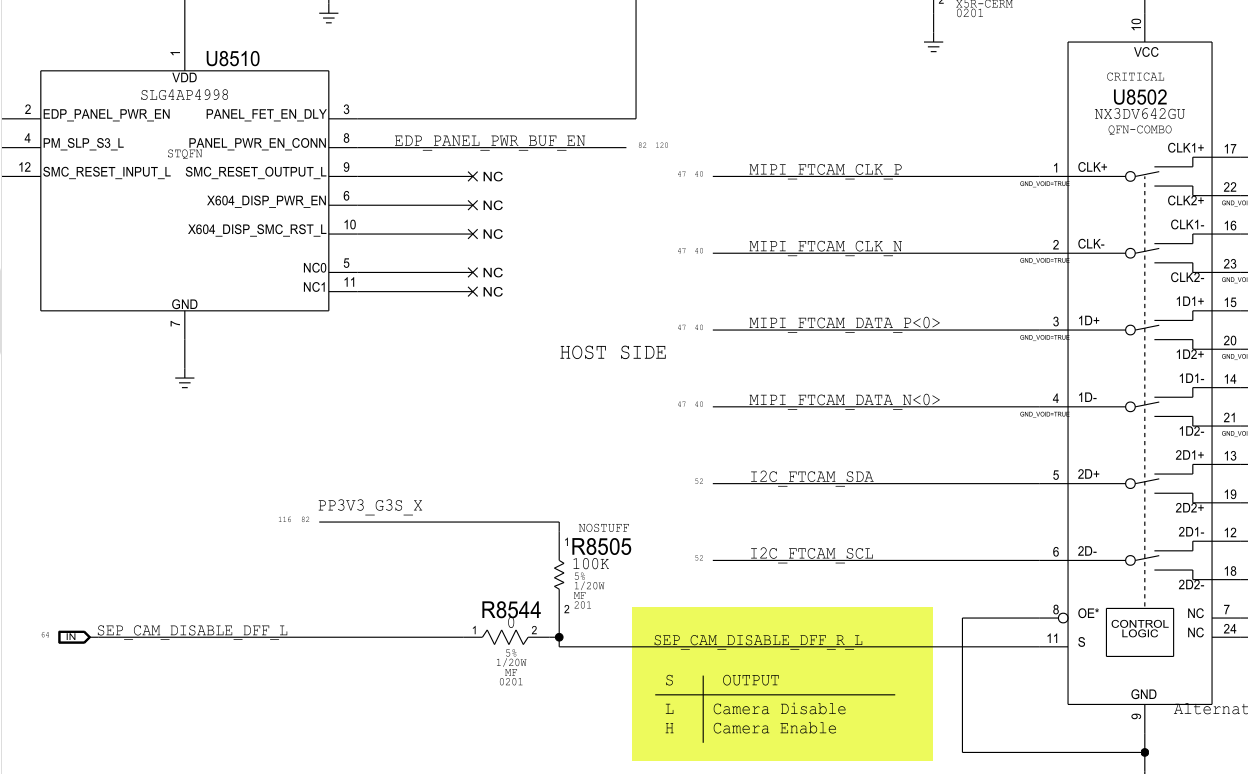

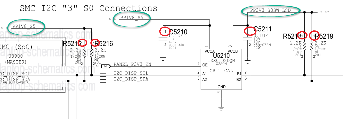

                  What is the voltage to ground for the 'S' pin on the mux (multiplexer)?
                  You can measure at the resistor pads.
                  Update - also check the voltage to ground of the i2C lines as per new attachment.

                    #29
                    the 'S' pin is 1.7 V (I measured 2 pin R8505)
                    upd I saw your upd (xd), so I will do it, I will continue tomorrow, thanks again for wasting your time on my problem

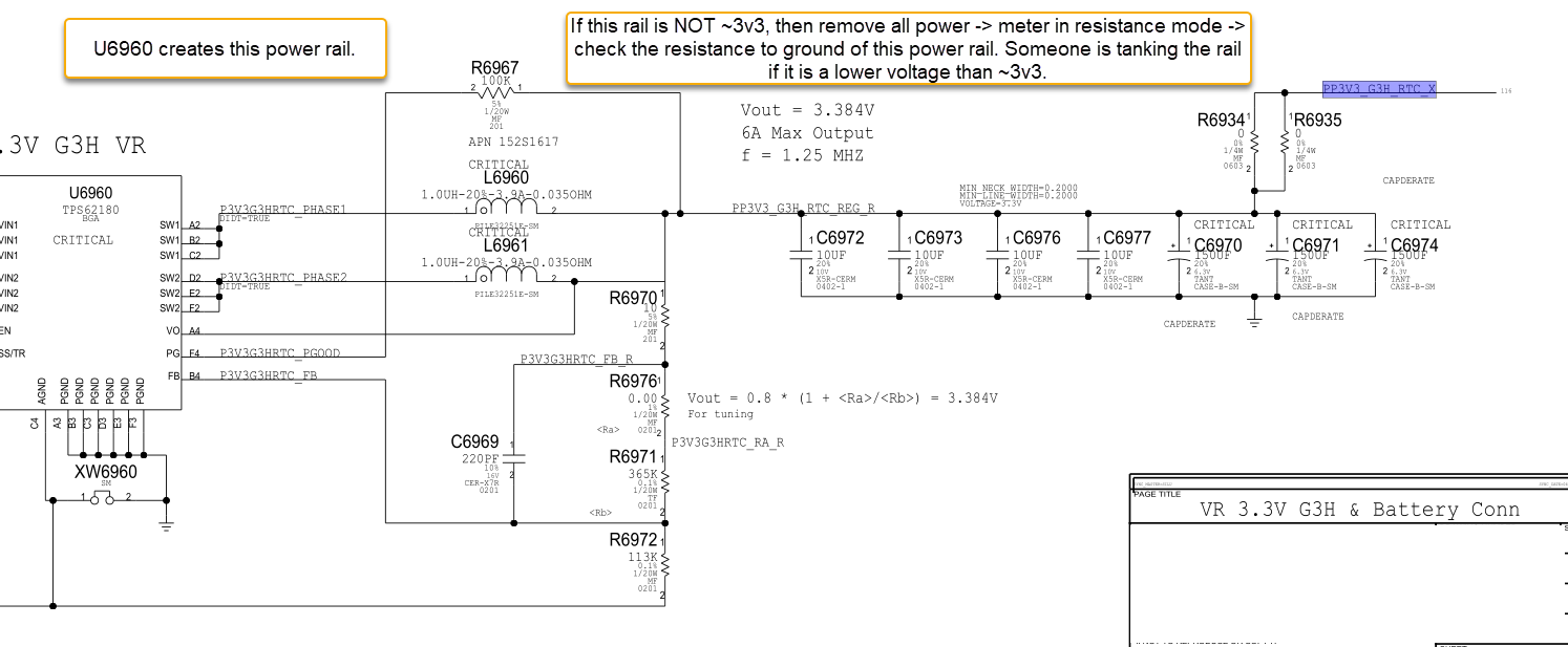

                      What is the voltage of PP3V3_G3H_RTC_X (measure anywhere you can on the board). This rail powers the mux IC you just measured.
                      Adding to your checklist for tomorrow. See attached.
                        PP3V3_G3H_RTC_X
                        R6935 and R6934 test 1 pin = 3.3 V

                          #32

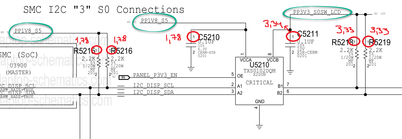

                          hello mr mon2
                          I checked U5210, all pins are 0 V
                          and R5218 & R5219 is 0 V

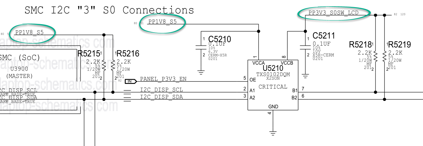

                          • mon2
                            • Dec 2019
                            • 13992
                            #33
                            See attached. Confirm the voltage to ground readings for each of these points of interest.
                            The I2C lines should NOT be @ 0v unless they are being pullled down due to some even OR the pull-up voltage rails are missing.
                            You are checking for the presence of the pull-up voltage rails.
                            I2C is an open-drain design. This means the logic IC can drive the pin LOW = 0v but not a logic HIGH. Instead, when it is a 'high', the trace is floating or high impedance. Respectively, the pull-up resistor(s) must be present AND they must be pulled to an active voltage like you see in the attached diagram.
                            If the voltages are missing, the I2C lines will be parked into 0v state and the interfaced logic will fail to operate (ie. webcam, backlight, etc.).

                              #34
                              i just checked all the lines you mentioned, on all lines 0 v
                              the motherboard was connected, including the charging was connected, but the display cover was closed
                              upd I measured the voltage on the pins in the attachment

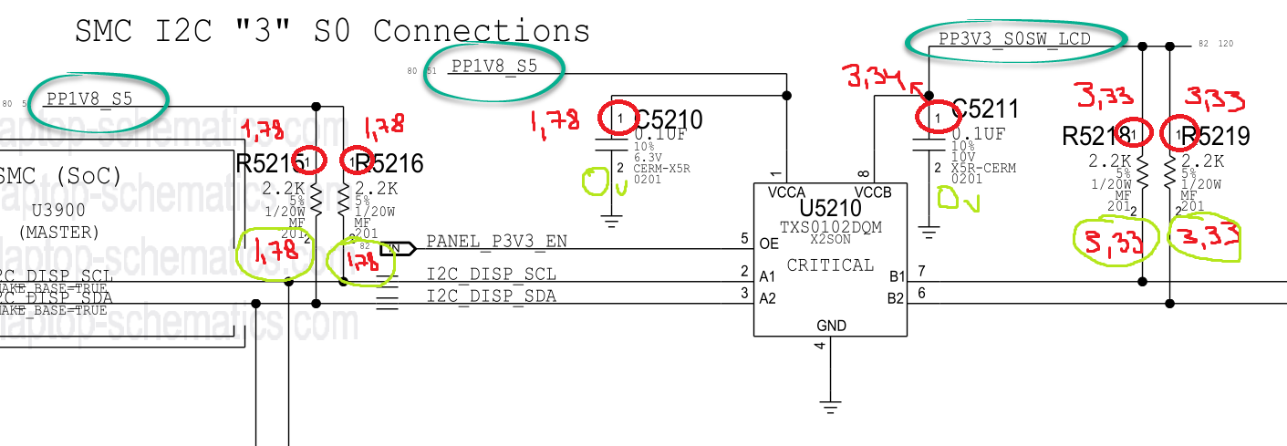

                                  #36
                                  my bad..
                                  see attachment
                                  upd maybe some previous measurements should also be done with the display cover open?
                                  • mon2
                                    • Dec 2019
                                    • 13992
                                    #37
                                    Much better readings. Can you test the I2C lines again with the display lid open? That is, now you are measuring the voltage to ground on the OTHER side of each resistor.
                                    It is important that they are NOT @ 0v when the pull-up voltages are active.

                                      #38
                                      done
                                      • mon2
                                        • Dec 2019
                                        • 13992
                                        #39
                                        These are good readings. These set of I2C lines are ok.
                                        Can you check the EN pin again on the backlight (with the display lid open) ? Do you see ~3v on the EN pin or is it still 0 volts.
                                        If 0 volts, continue to check the mux pins..
                                        See attached. Check the voltage to ground of these lines which are linked to the MUX (multiplexer) that is used to enable / disable the backlight.
