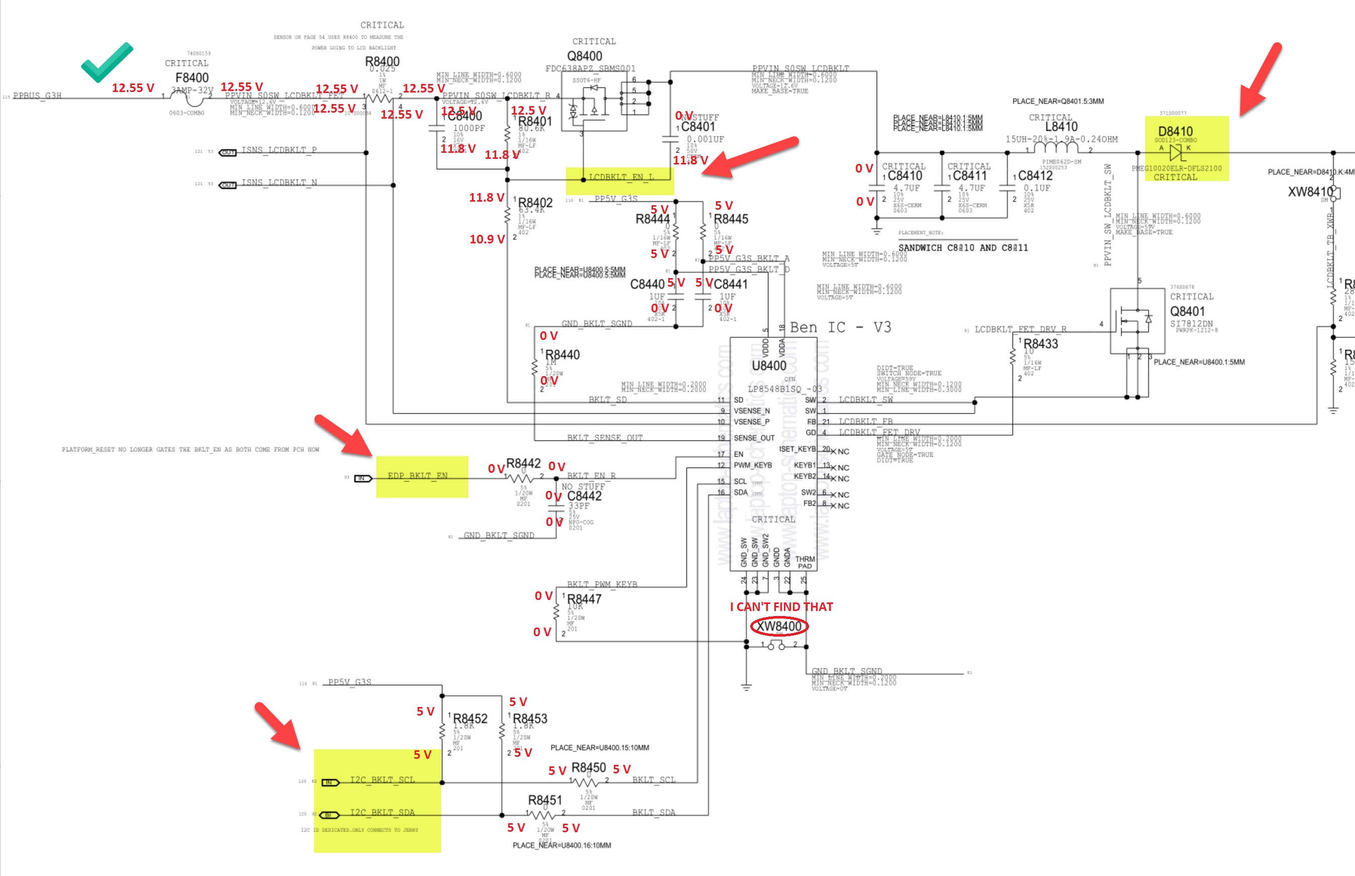

                  I was able to track only 1 pin fuse F8400, because pin 2 does not go to the front side of the motherboard, I attached screenshots
                  I measured C6405 and C6406 on the highlighted pins, and got 12.88 V in DC mode

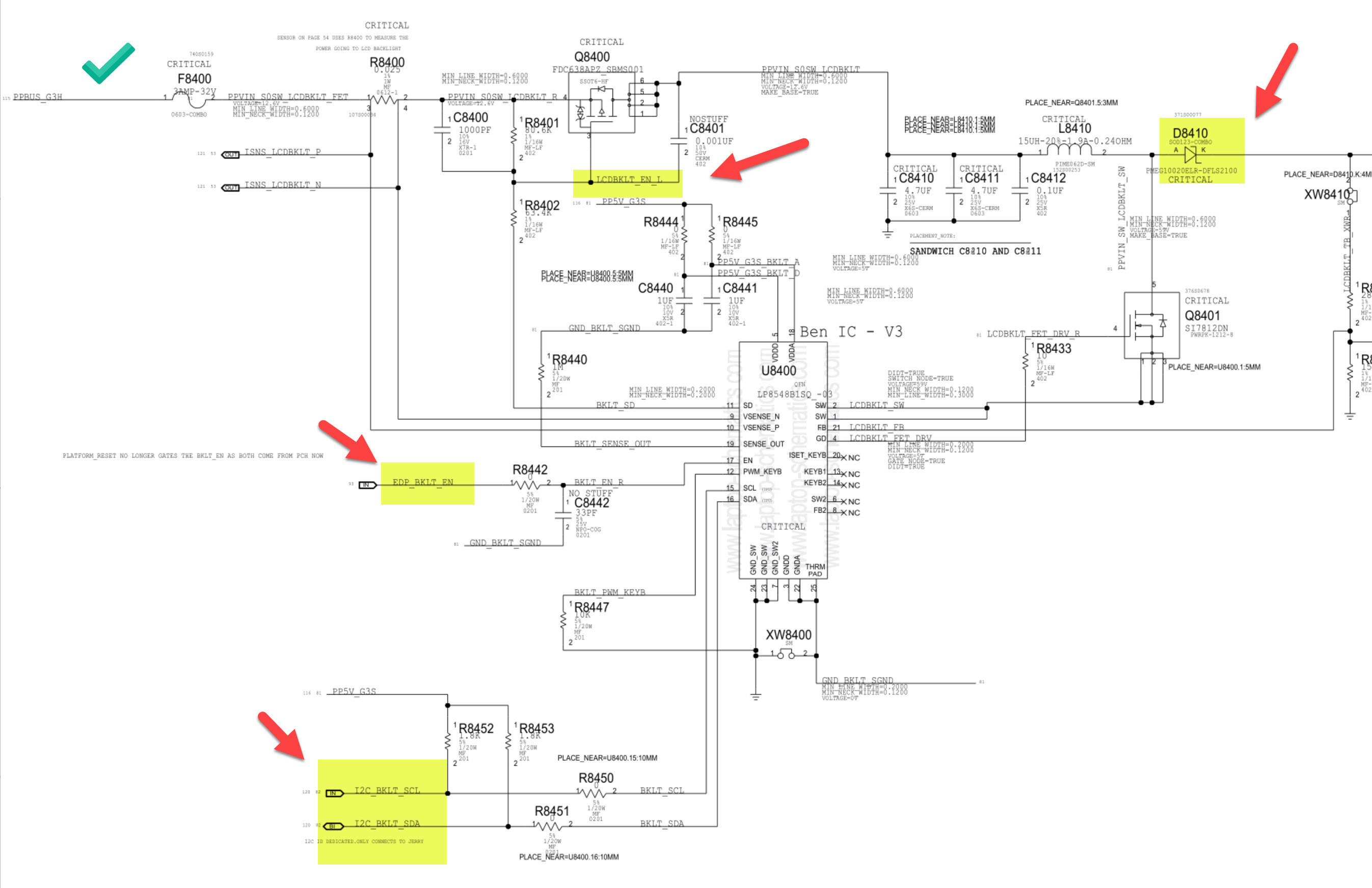

                    See attached. These are the points of interest to measure the voltage to ground.
                    In summary -> fuse has to be present so the source voltage can enter the mosfet above -> if the GATE voltage is LOWER than the voltage passing between SOURCE & DRAIN pins, the mosfet will ENABLE.
                    This is a P-channel mosfet.
                    The boost led IC that you see on this page needs to be ENABLED and the communication with the i2C lines (SDA & SCL) must be present and not being pulled down. This device is an I2C slave and there is a I2C master on the main logic board. When this slave is indexed using an I2C address, the dimming can work.
                    The final boosted voltage is at the output of the diode on this schematic page.
                    Do note that the display has to be detected for the backlight to work.
                    There are many detailed websites and comments from others on the operation of this circuit by @Piernov and others but the above is a short summary.
                    I am flooded with some life sucking repairs and dealing with my first PMIC replacement on an ipad AIR - without a microscope - not fun at all. Do not have the hand stability to solder back 01005 parts. Trying to get the repair out to the customer before a major snow storm hits this region.
                    Post the voltage checks for the requested areas when you can.
                    Start with the ENABLE pin voltage for the backlight IC = pin 17 of U8400. You can measure this voltage @ R8442 or C8442 (only pads are on the PCB; part is NOT stuffed at the factory).

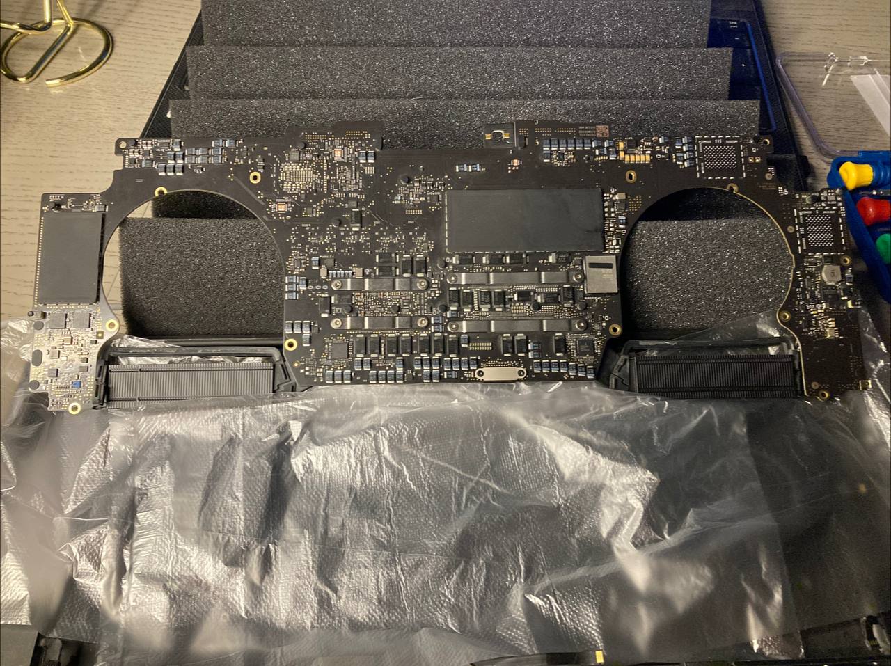

                      Is it enough for me to connect type c charging cables to the motherboard and display cables so that I can measure these elements?
                      at the same time, the motherboard can be removed from the case, but connected to the power supply and the display so that I can get to the necessary circuit elements?

                        I will try to take measurements tomorrow, so far I have measured only the D8410 because it is on the front side of the motherboard
                        the measurement results are in the screenshot

                          On this measurement at the diode, be in DC volts (35 volts or higher).
                          Red probe on diode; black probe to ground.
                          Review what the voltage is on the diode (both sides should be measured).
                          If working, you should see a boosted voltage of 25-45 volts after the diode to drive the LED backlight array inside the display.

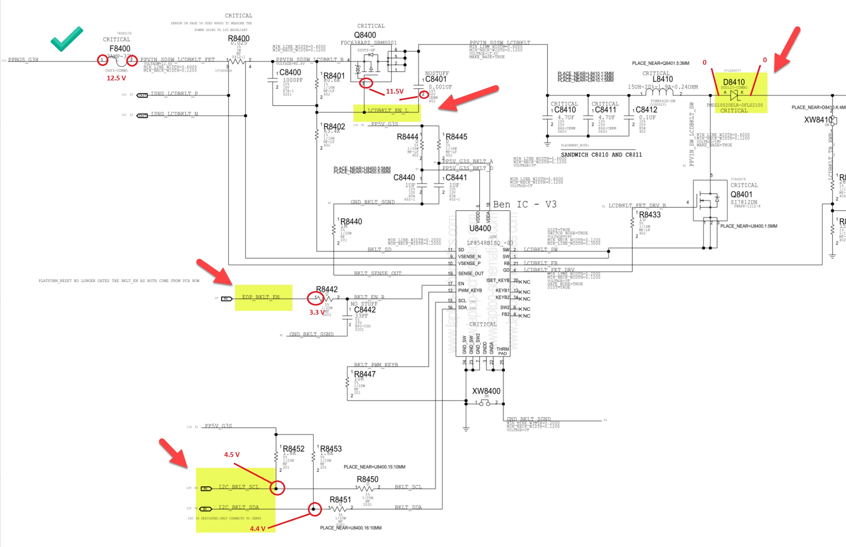

                            hello mr mon
                            I measured only the key parts of the circuit highlighted by you, I am attaching a screenshot. It turned out to be not easy in fact, but I built such a structure for measurements, attached
                            By the way, the multimeter mode used this one, just in case I show it in the attachment
                            Now I will start measuring the ENTIRE circuit step by step, tell me if anyone has measurements of a working board, each of the elements?
                            finally I was able to measure a section of the circuit, that's what I got
                            voltage measurements in attachment

                                Pin 17 of the backlight = EN = is currently @ 0 volts. So this means the upstream logic is requesting that the backlight remain OFF.
                                The fault could be that the display is not being detected due to a faulty cable / connector / mating issue of the cable & logic board connector. Remove all power and confirm that the contacts are clean on the display connector. Use IPA to clean the contacts which is always nice to do.
                                You can also confirm the OPEN LID status which is based on the trackpad and hall effect switches. That is, if the LID is sensed to be OPEN, then the backlight will be enabled.

                                    so.. i found out the following
                                    J0200
                                    not sure if I'm doing it right. in diode mode, two test points rang (black probe on the ground, red on the test point) when the cable is connected, everything is OK, but if you turn it off, there is discontinuity
                                    also I measured the voltage on these test points, both have 5 V (BLDA, BSCL)
                                    J0803
                                    also in diode mode, the test point VLED on J0803 rang, it has continuity to ground (while J0200 was connected)
                                    however, when measuring voltage at VLED 0 V (while J0200 was connected)
                                    I got lost again , what could be the reason? where to look for damage?

                                        In diode mode testing, the RED lead, yes red meter probe to ground.
                                        Black meter probe to point to test.
