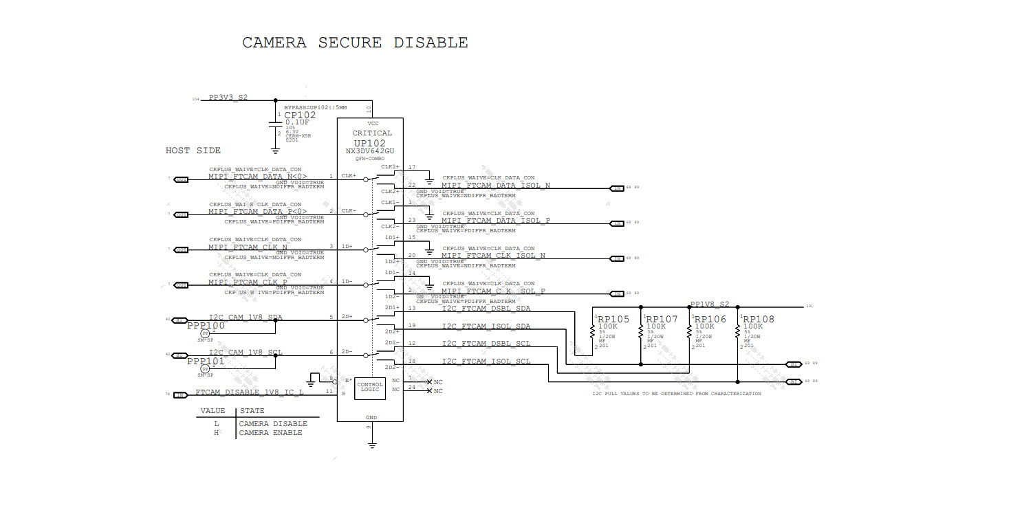

Guys, I am currently working on a A2338 Logic board which showed liquid damage, only initial issue was the Wi-Fi IC was not turning on due to not receiving enable trace, this was an easy fix with jumper wire. Issue I am seeing now is there is no camera showing up in system report as well as facetime option. I have tried (2) Different LCD screens this is not the problem also I am seeing 5v routing through LCD JP600 connection. Looking at the A2338 Schematic only thing I am really finding in reference to camera is UP102, which shows on schematic but is not on my board, kinda stuck here any options for be nice.
Macbook Pro M1 A2338 _ Camera Issues
