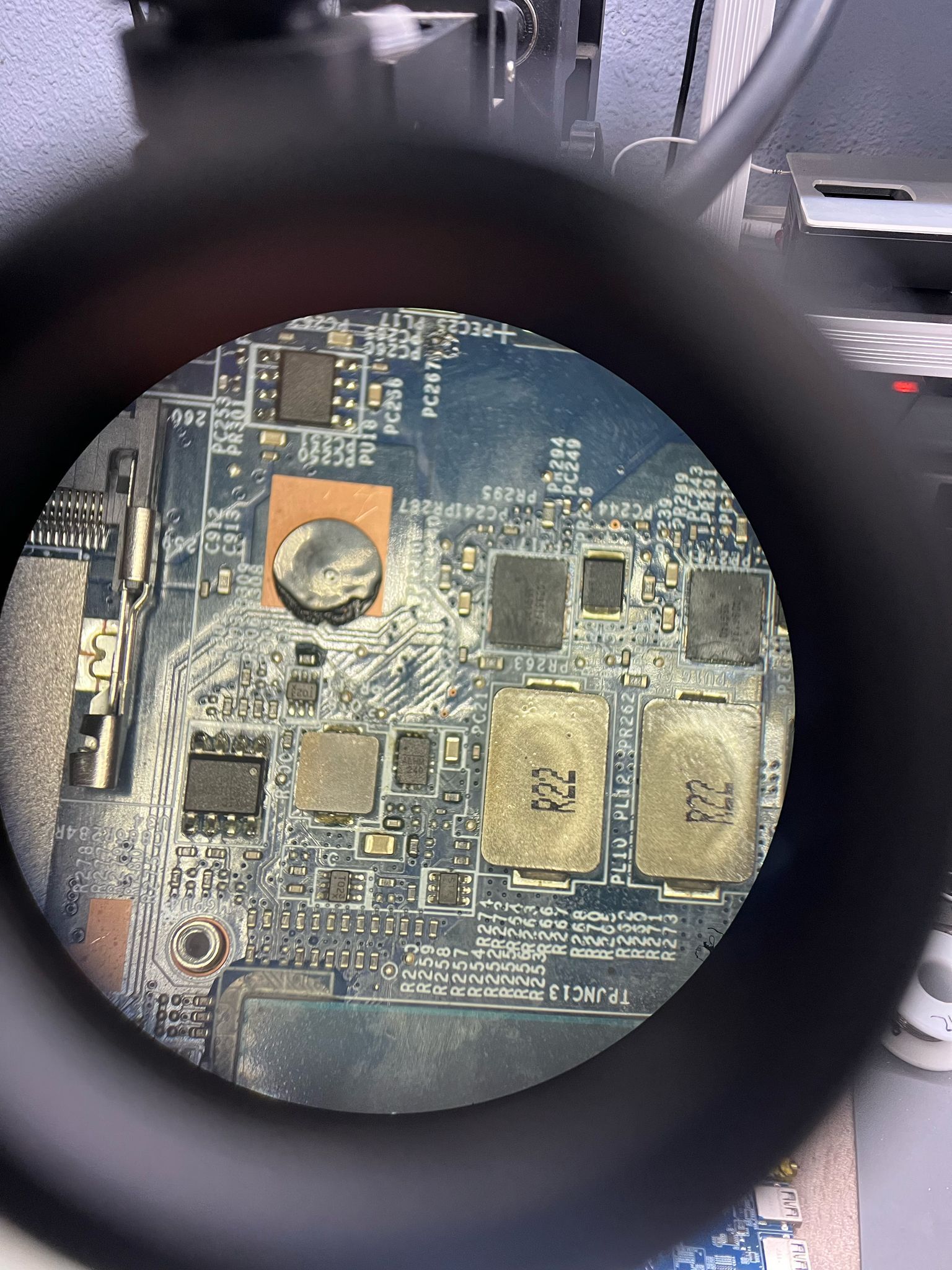

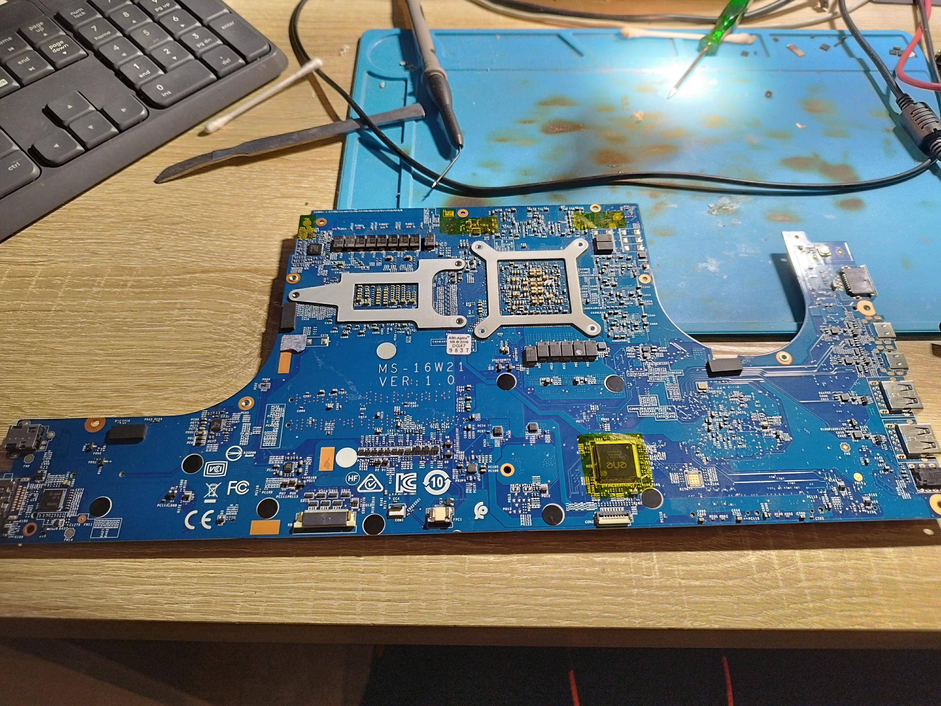

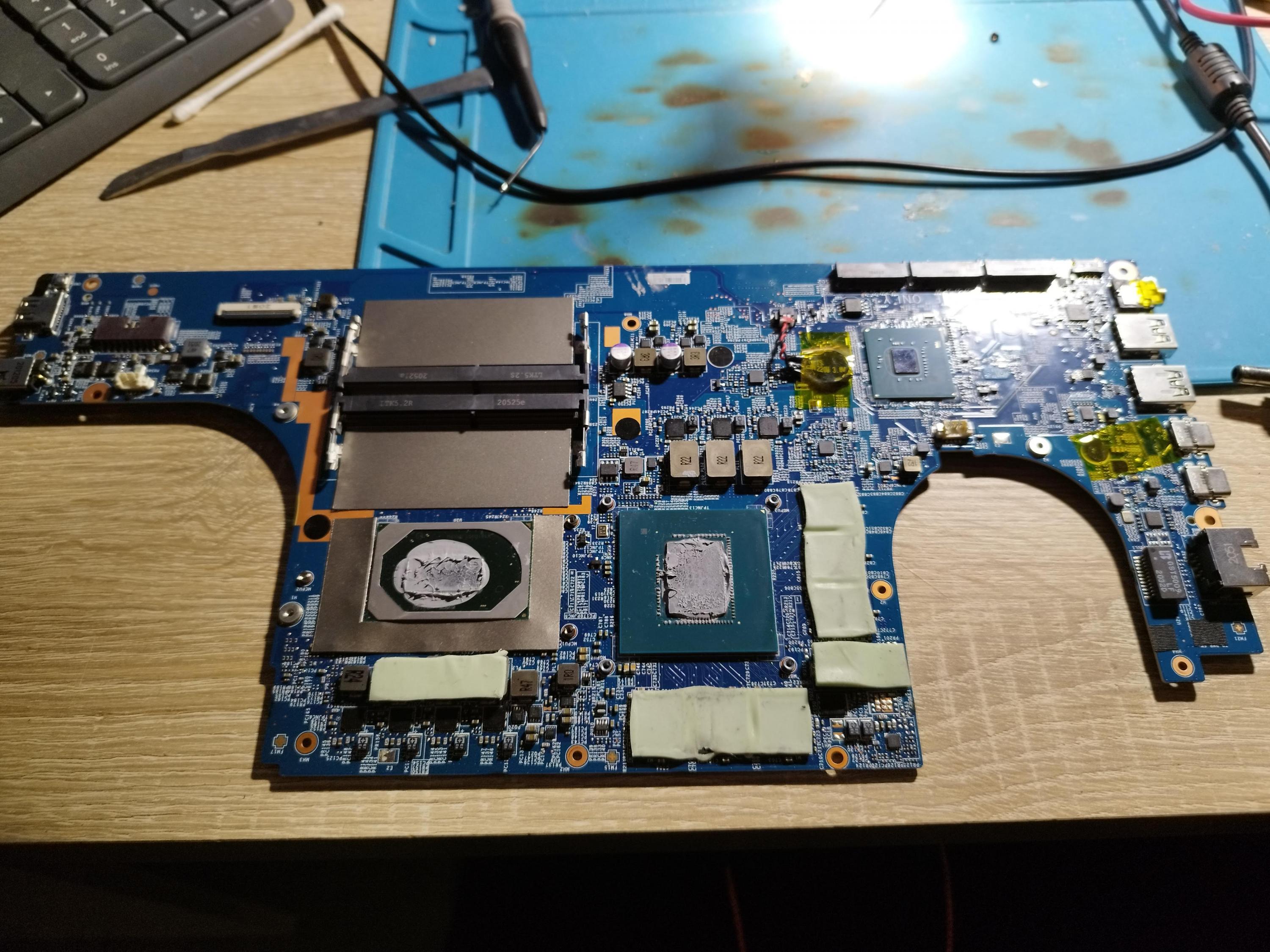

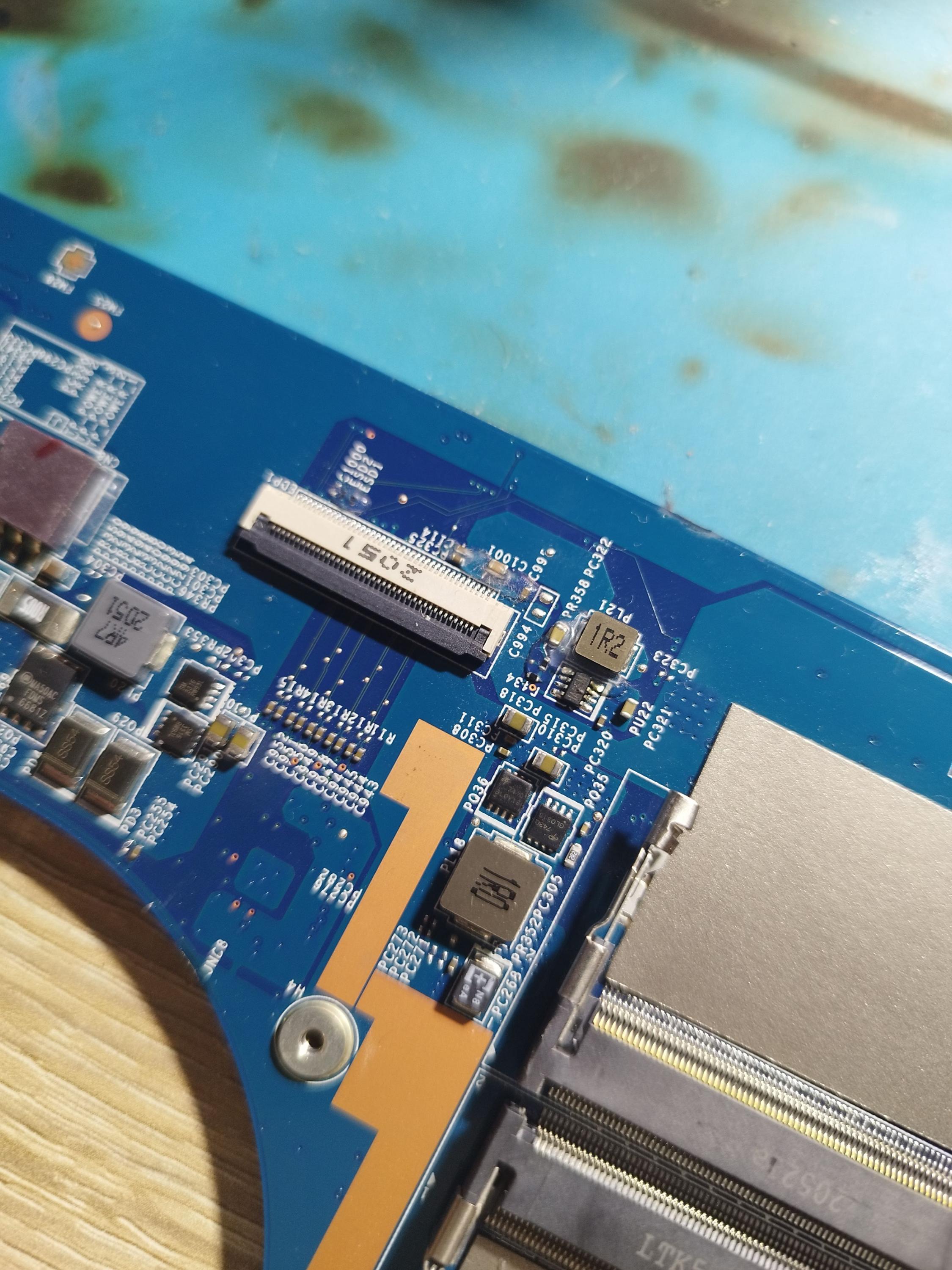

    Hello, guys,
    Have pretty new laptop on desk, board: MS-16W21, it has burn component near LCD connector (PU22, ACEM, see pics) as i cannot find schematic for it, maybe somebody will help identification of this 8 leg chip?

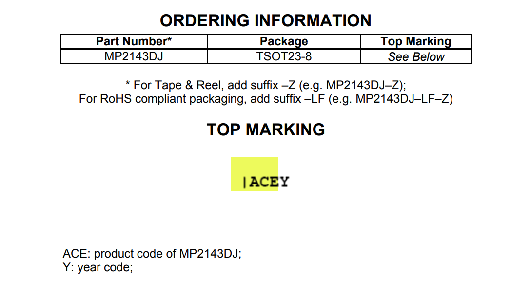

    Re: MSI GF65 (MS-16W21) identification of burned part
    See attached.
    p/n MP2143DJ
      Big thank you, ordered a pack of new ones

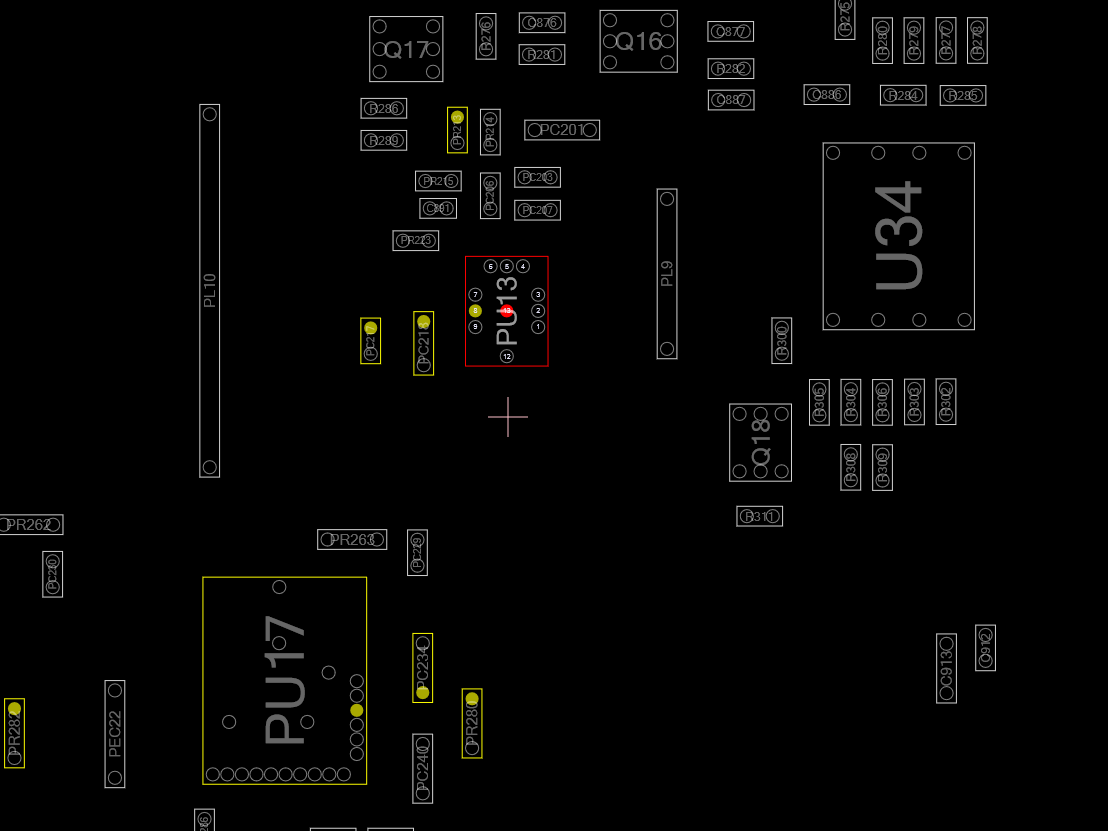

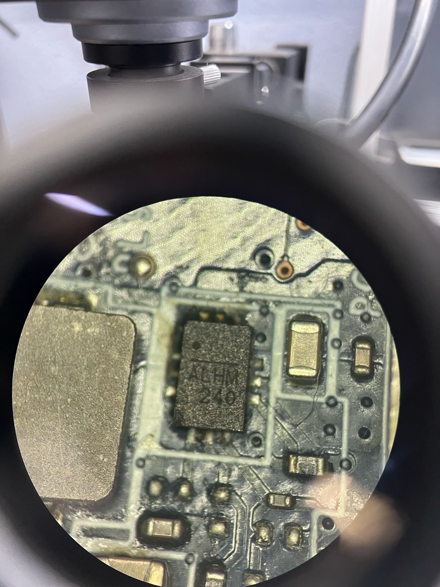

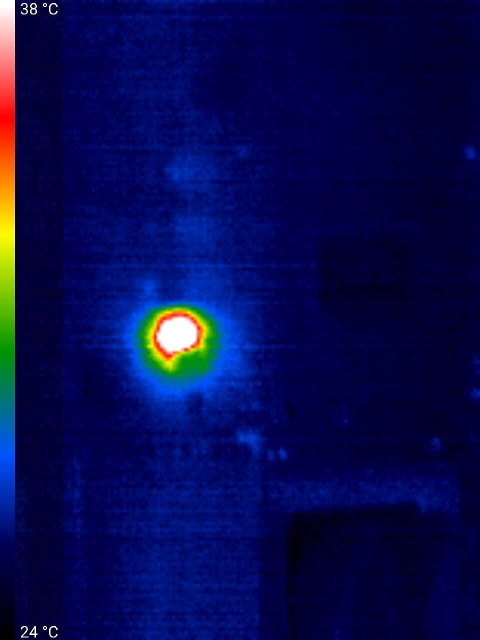

        Hellow, I have the same component burned, I ordered and change the component but the computer Does not start. The line of pin 2 is sorted and a compononent in the same line is hot when I inject a voltage. The line is +5vSUS. The component Hot in the line is PU13 in boardview. I adjunt images of this component.
        Can anybody help me to indentify the component?
        Thank you​
          Thank you​
          pu13 PHASE OUT 2024/7/10 PROCUREMENT REQUEST,IC CONVERTOR,MPS/MP2147GD-Z,QFN-12pin,SYNCHRONOUS STEP-DOWN SWITCHER,RoHS COMPLIANCE
