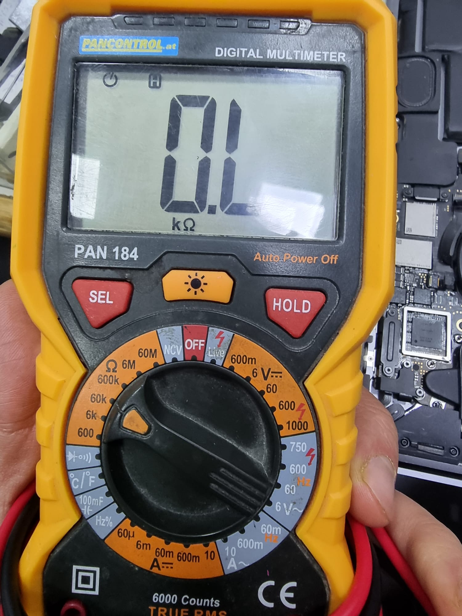

        F7000 and F7001 removed , the voltage on Pin 1 is 12,30V
        All power removed, for the check ground resistance to ground, black wire from Multimeter connected to gnd and red is to PIN number 2 of F7000, but I get evrytime diferent results,
        from 15,00 KΩ and its going up, 16KΩ,17KΩ,18KΩ,19KΩ30KΩ,35KΩ and, and, and.
        my be I do something wrong?

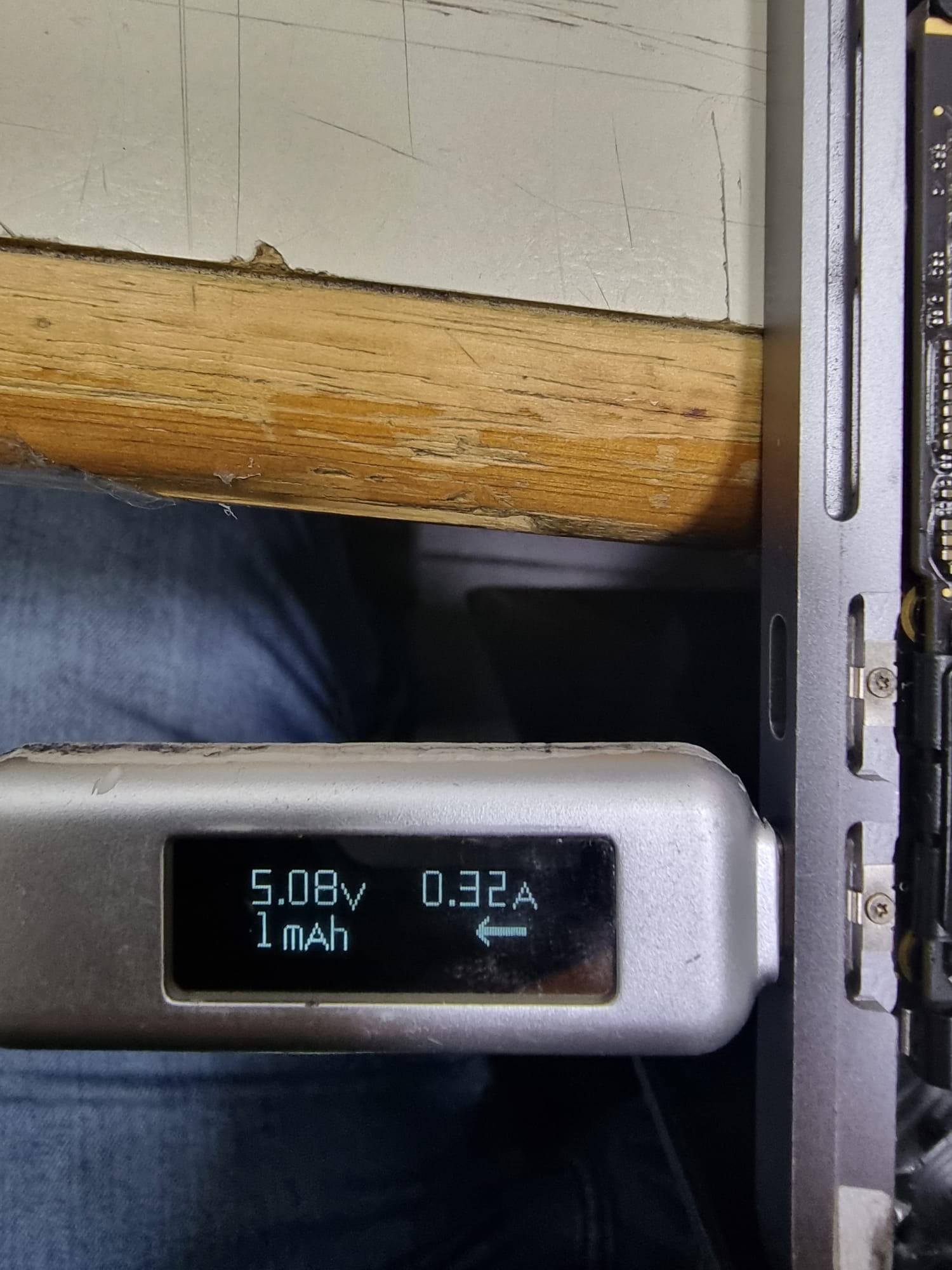

        after I removed F7000 and F7001 , I see on my Ampermeter only 5V, 0,32A, 1mAh.

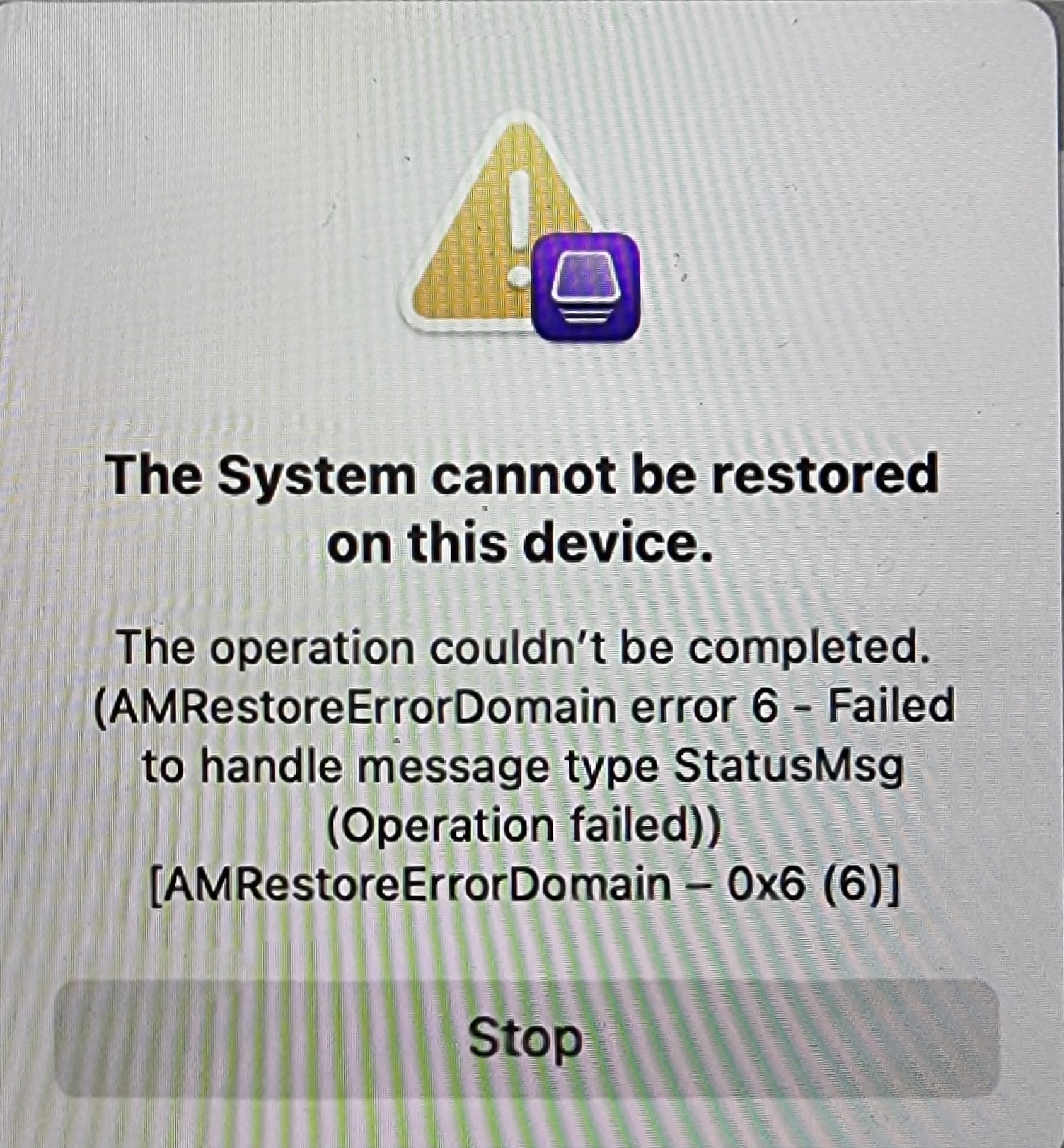

            I put the Fuse F7000 and F7001 back to the plase, and checked this case.
            No Power, PPBUS_G3H at 12.5 V, charger at 20 V cycling from 0–300 mA
            The Macbook was detected, and when I Right click on the box and choose "advanced", and then "revive device" I get after 10 seconds error mesage ( look atachment)

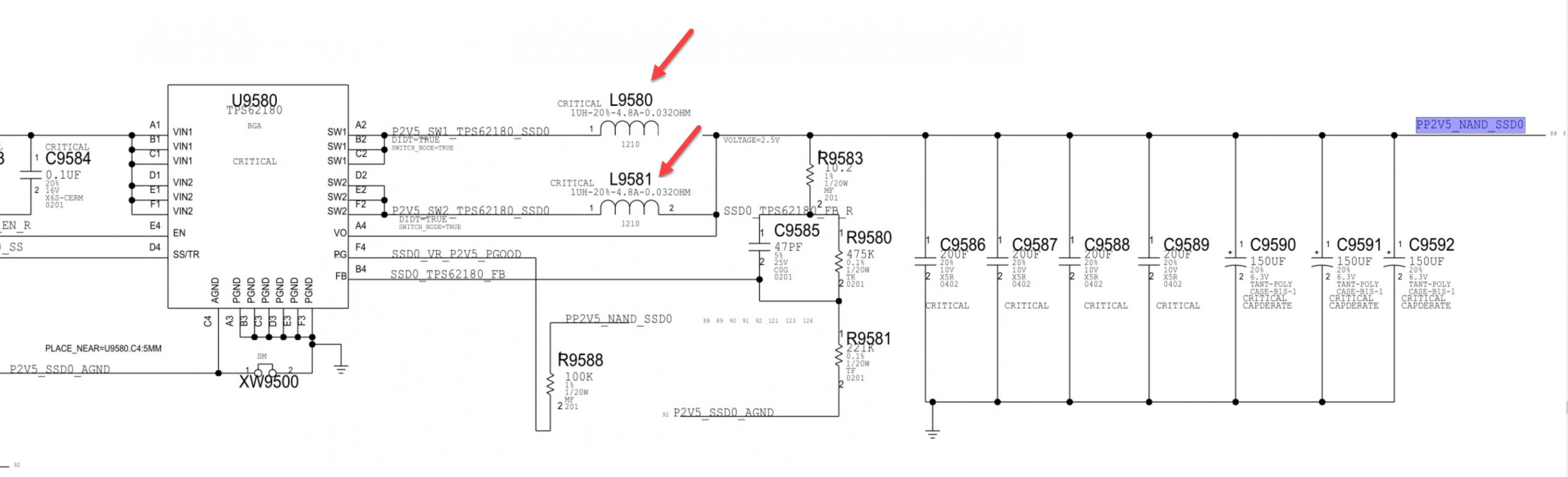

                  Ok. Your fault may be the same as the above wiki link.
                  Remove all power -> no battery -> meter in resistance mode.
                  Check the resistance to ground of PP2V5_NAND.
                  From the above wiki,
                  Found C9586 for PP2V5_NAND short
                  This spot on the board is VERY susceptible to corrosion with no liquid damage. It is placed in the path of incoming cooling air, so dirt and dust build up in this spot causing moisture to be retained, resulting in corrosion. Recommend a conformal coat on this area once repair is done. After removing the short and verifying PP2V5 is present you may find the no power is almost the same, but now taking 20 V, 0–20 mA. If the rest of the board passes visual inspection, and no other shorts are suspected, the next step is to DFU revive (*CAUTION* DFU Revive must never be mixed up with DFU Restore, DFU revive keeps data on the drive, DFU Restore erases all data)
                  Review if you have the same fault. A quick test is to flux and remove this capacitor. Measure the resistance to ground again after this cap is removed.

                    Re: Macbook A2141-820-01700 No Power
                    PP2V5_NAND_SSD1 is 130Ω and its goin up.
                    but PP2V5_NAND_SSD0 is 0,00Ω and its shurted to the ground.
                        Yes I removed the C9586, but the shurt to gnd still stay, PP2V5_NAND_SSD0 is shurted to the GND

                          Do you have an adjustable power supply ?
                          If yes, you can consider to inject 0v8 onto either side of the inductor (coil) @ L9580 or L9581. Then check who heats up.
                          If it is the SSD0 chip then you will have to search out the same from a donor board. Wait on others to comment. With some luck, one of the caps could be shorted and will heat up. That cap will then need to be removed and/or replaced.

                              Apply flux and reflow the bga ics linked to this power rail.
                              The inductors must be not cracked and working for the power rail to function.
                              Repair each and test again. If required, replace the power ICs. Proceed with care so the bga pads are not damaged.
