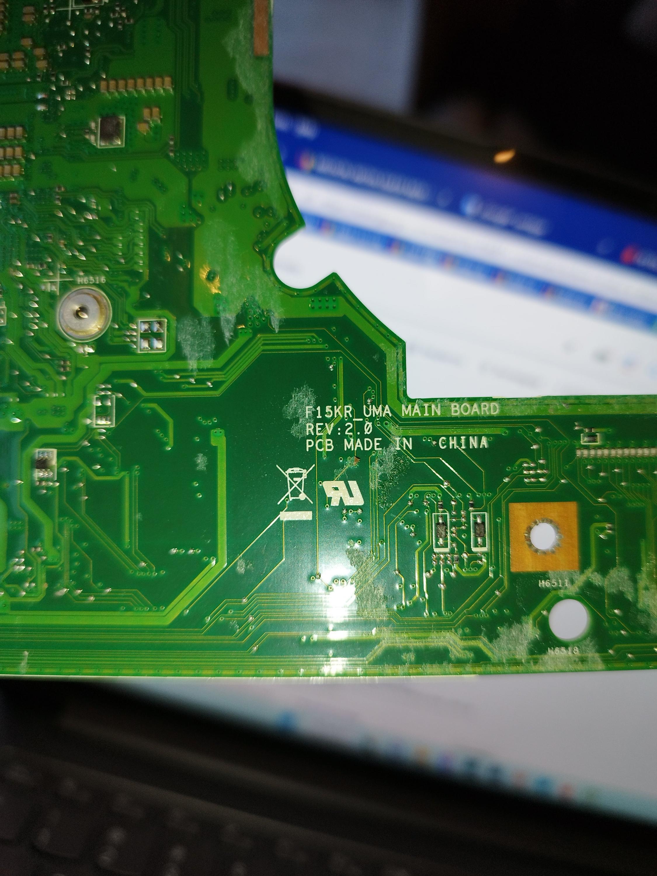

    Medion E6439
    Medion E6439 MD61188 MSN30025326
    Board: F15KR_UMA , Rev: 2.0

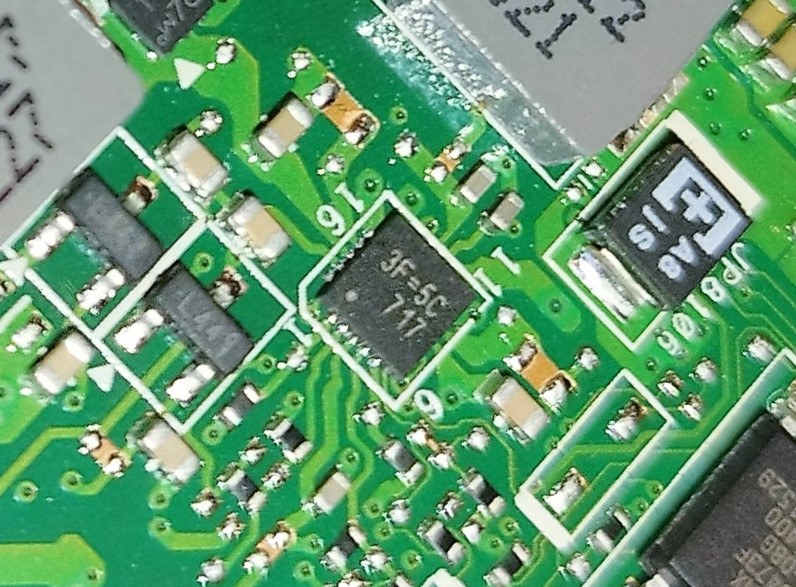

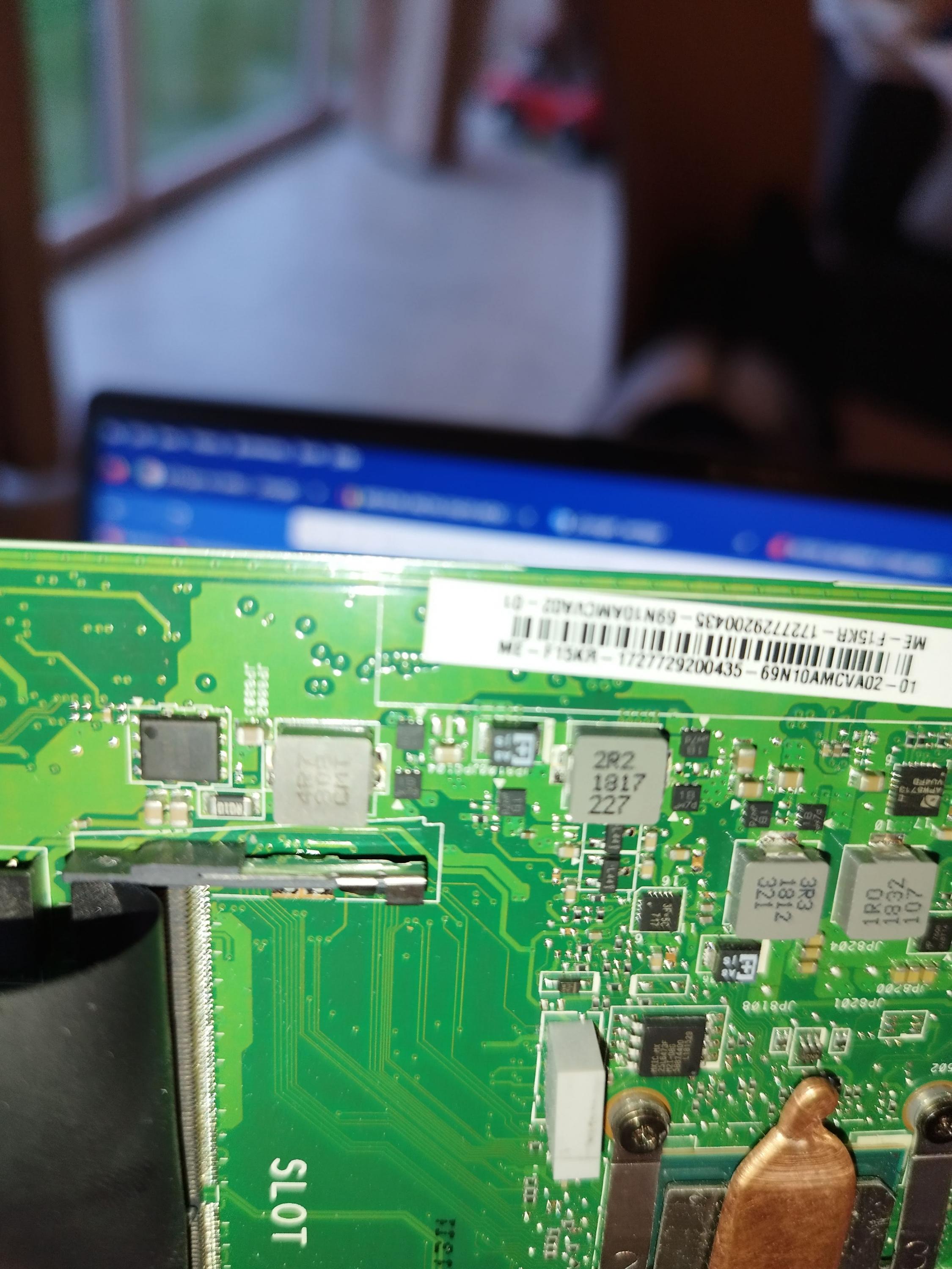

    How to recognize probably 3v and 5v controller that has marking: 3f=5c 717? Adding some photos.

    Re: Medion E6439
    Hi, 3F= is Richtek RT6575B.

      Re: Medion E6439
      Thank you very much
