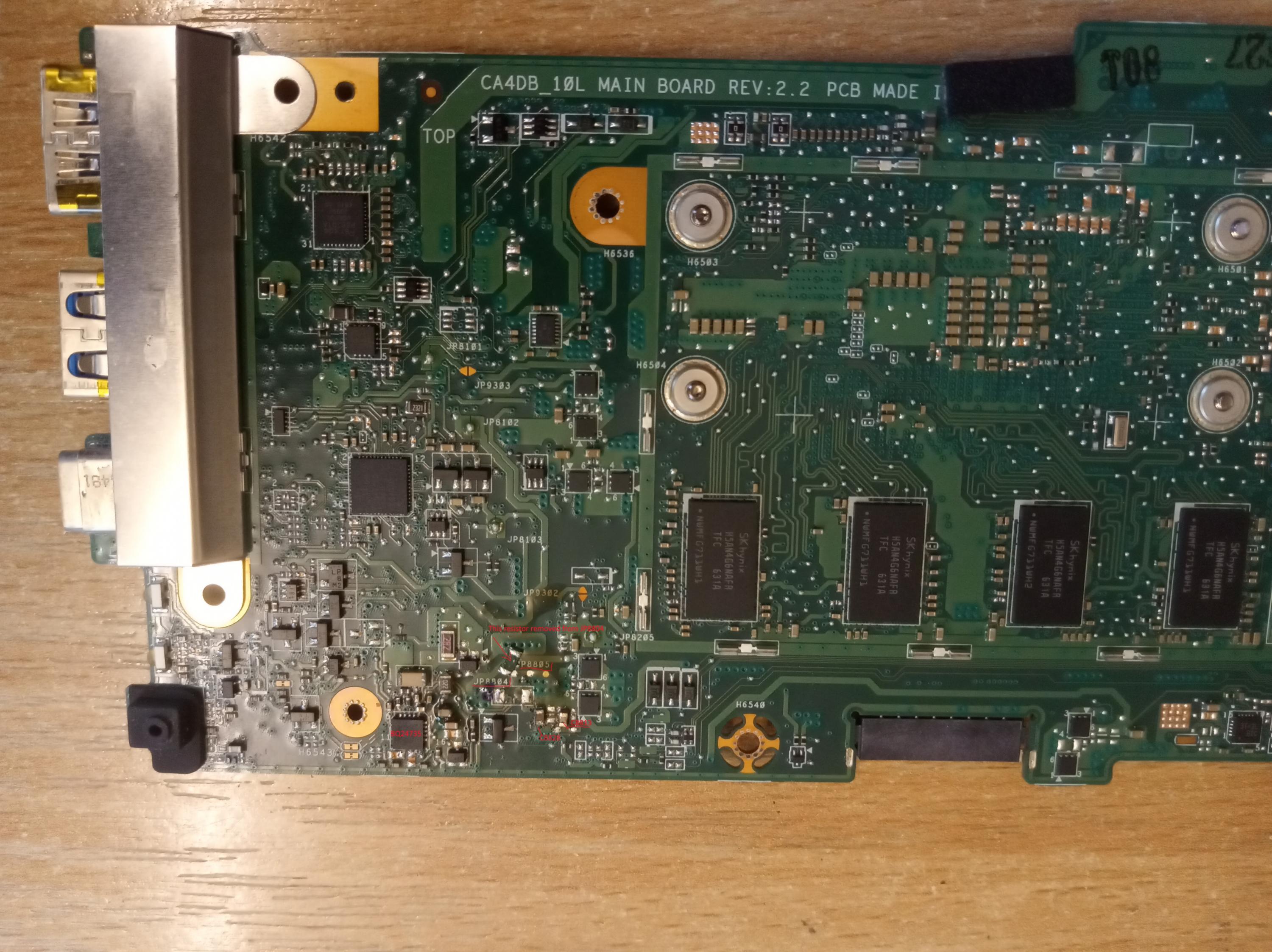

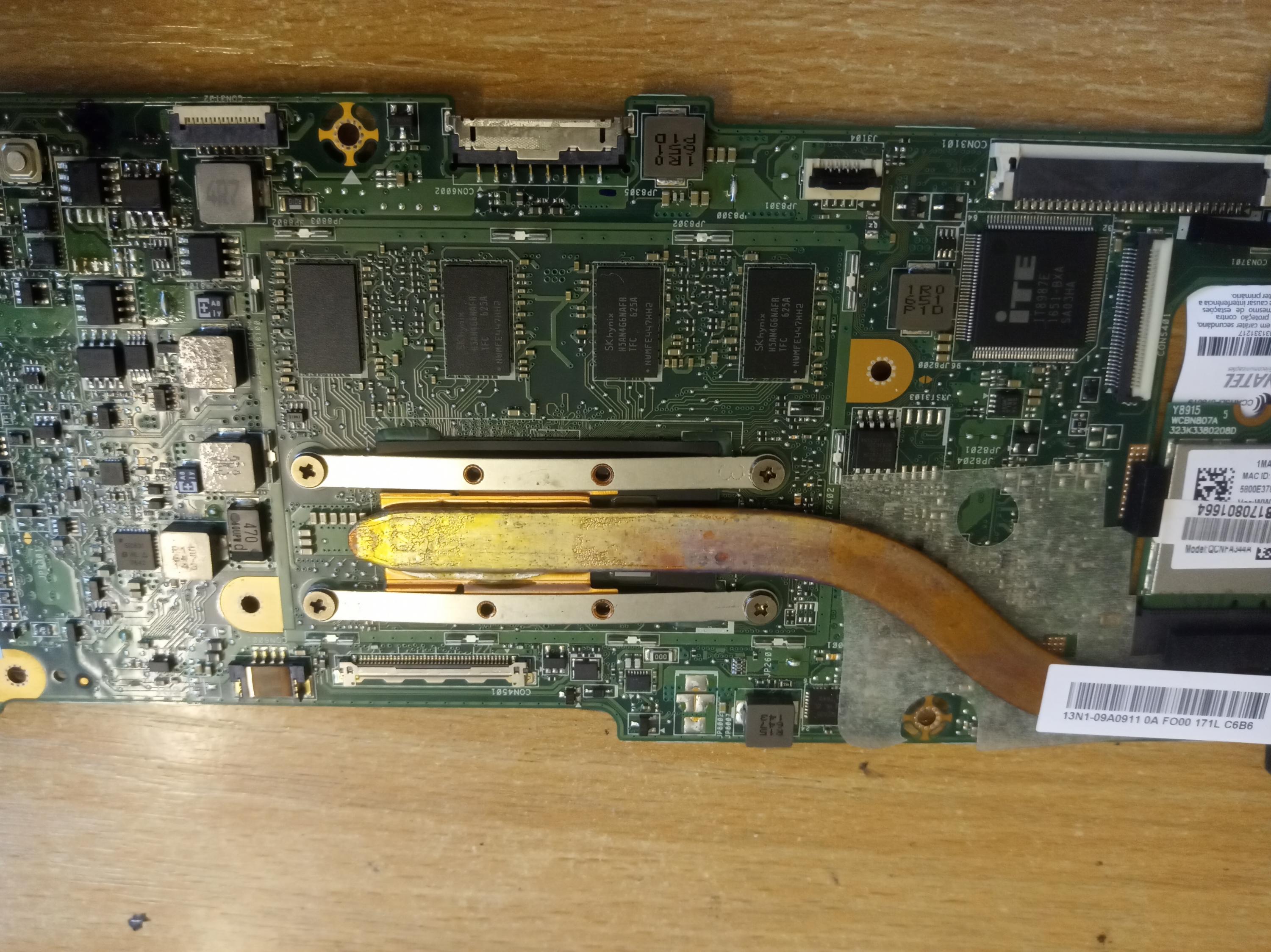

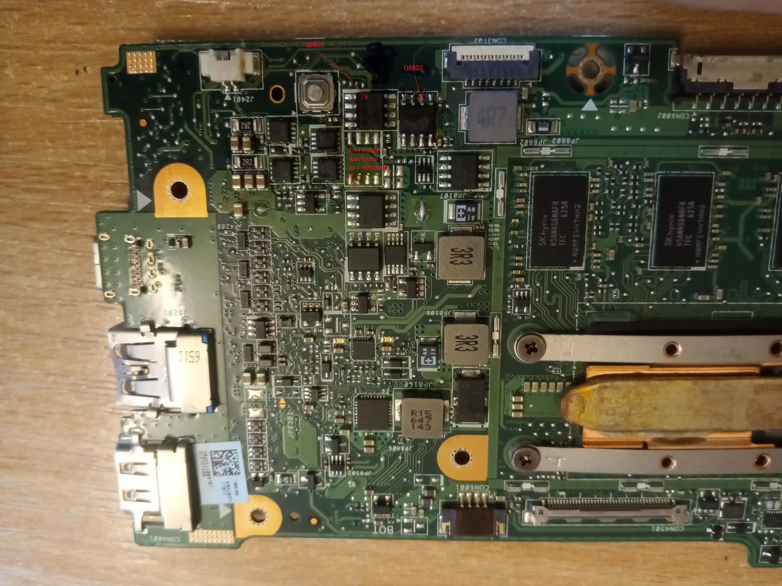

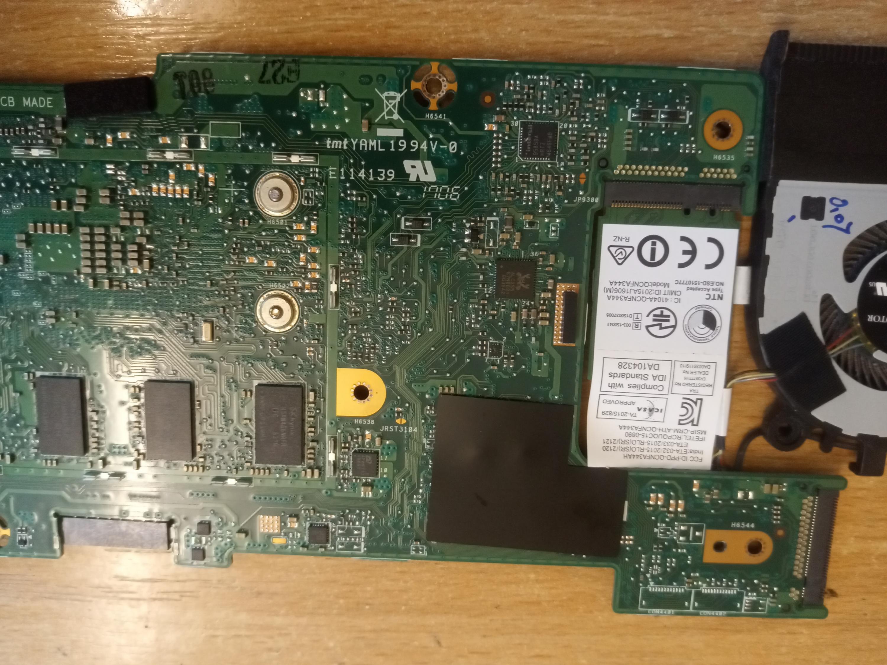

          • Jane
            • Aug 2010
            • 189
            Re: BQ24735 - faulty?
            Here are some pictures of mainboard.
            Both top and bottom sides have two pictures
            Part1-a.jpg shows part where BQ24735 is and Part1-b.jpg is the opposite side where mosfets are.
            Part1-b.jpg is the other part of side where BQ24735 is and Part2-b.jpg is the other part where mosfets are .
            IN red ink I made few notes there
            Thank you for advice how to continue with the repair.
