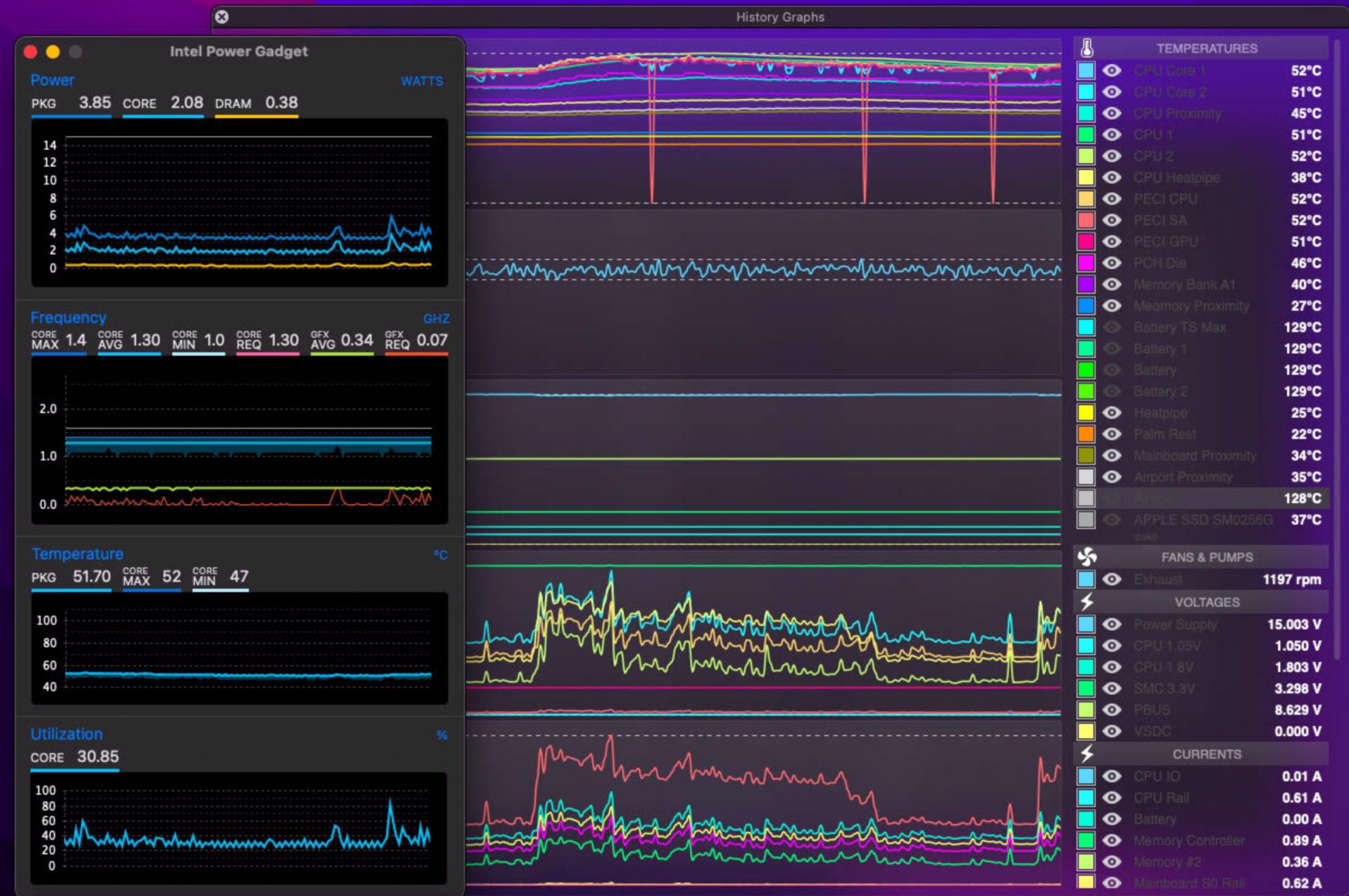

    I wonder how come the CPU throttling differs. During multiple restarts it is either 0.9 or 1.4 but goes to 2.7 in smc bypass.
    Attaching screenshot of hwsensors - the only thing that flips is PECI SA.
    What determines 'the amount' of throttling?

      Re: A1466 820-00165 intermittent shutdown
      MacBooks will not reach full boost clocks without battery.
        that 2.7 in SMC bypass is without battery.
