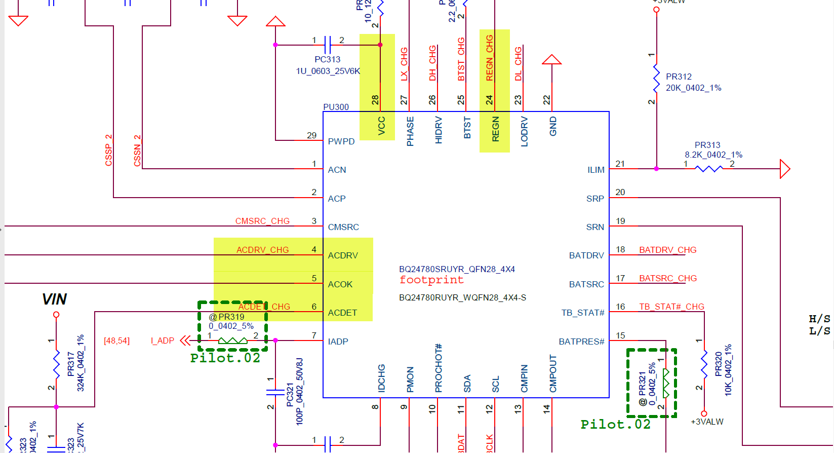

    LA-D993P No power no charging
    hello
    When you press the power button, the light turns on and off. It was working normally until a day ago. +3VALW ,+5VALW and power_sw have 5 volts, won't charge and won't turn on
    P65F
    LA-D993P REV 1.0

        Re: LA-D993P No power no charging
        See attached.
        1) Start with the charger IC @ PU300.
        Attach a known good power adapter -> meter in DC volts scale (30v or higher).
        Carefully (!) measure the voltage of each of the highlighted IC pins.
        Interested in:
        Vcc (pin #28)
        REGN (pin # 24)
        ACDET (pin # 6)
        ACOK (pin # 5)
        ACDRV (pin # 4)
        Post each measurement.
          Vcc (pin #28) = 19.7 Voltage
          REGN (pin # 24) = 6 Voltage
          ACDET (pin # 6) ACOK ( = 2.7 Voltage
          pin # 5) = 3.3 Voltage
          ACDRV (pin # 4) = 25.8 Voltage
            1) Charger IC voltages look good.
            2) The mosfet resistance readings are not ok if the readings are indeed in ohms.
            3) Remove all power and with flux and hot air, remove PQ302 off the board. Careful of the air pressure so that other tiny nearby parts do not go flying.
            Then wait for the removed mosfet to cool and check the resistance in the same way of the part that you have removed.
            Is the removed mosfet still with these very low readings?
            Also check the resistance values of the PQ306 mosfet (now that PQ302 is off the board and should not influence the measurements).
