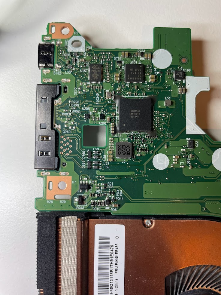

    Re: Lenovo Thinkpad T480 no charging

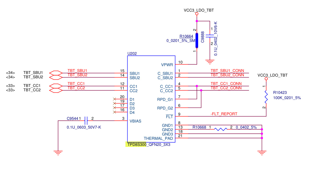

    Locate U202 - see attached.
    This is a single device ESD / surge protector for the USB-C connector.
    The power delivery negotiations may be halted if this component is damaged.
    • jamesportman
      • Sep 2022
      • 14
      Thanks,
      I did see one of those next to each of the ports, just marked 8S30 but I guessed they would be TPD8S300 like you say.
      I checked the FLT (fault) pins of both of those chips with power cable connected and they are both still high at 3v due to pull up resistors. Apparently if faulty these pins are pulled low.
      They both seem to be passing through whatever is on the four input pins to the output pins.
      There is approx 1.7v and 0.1v on the CC pins depending which way around the cable is plugged in, nothing on the SBU pins that I can see - maybe they are the higher power pins - "sideband use"?
      Are those voltages sensible?

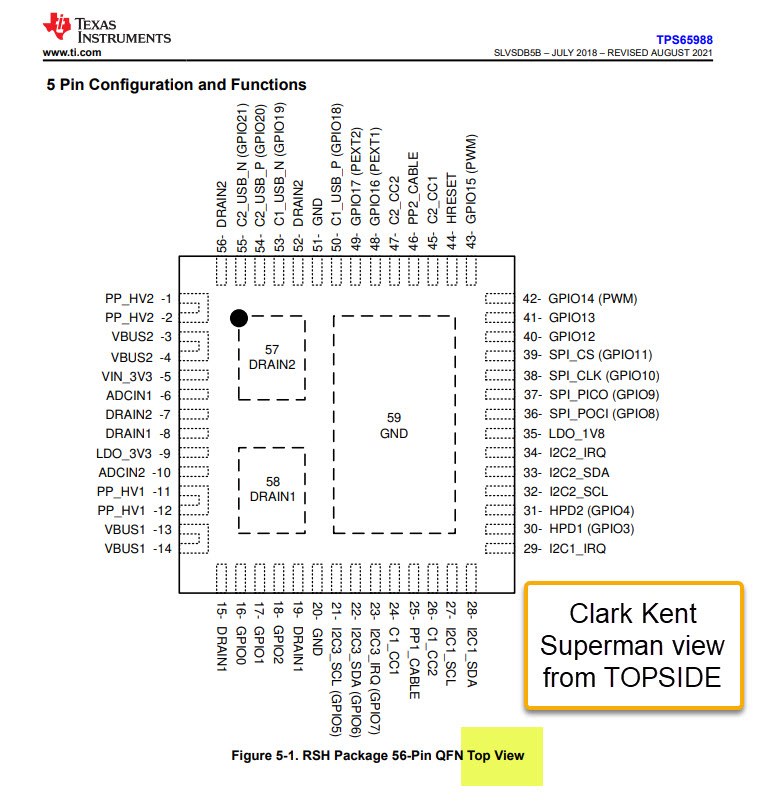

          Pin 51 should be grounded.
          Remove all power -> meter in (lowest) resistance mode -> meter probe on pin 51 (either color) -> meter probe to ground.
          What is the resistance ?
          It should be ~0 ohms. If not, check for PCB traces that may be broken / damaged.
          Plan B is to use wirewrap wire to solder directly from ground to pin # 51.
          Be 110% sure that you are truly on pin # 51 of this device. As this is a QFN package, each side can look the same as the others.
          See attached for the full datasheet -> locate the dimple for pin # 1 and then confirm again, that you are truly on pin # 51.

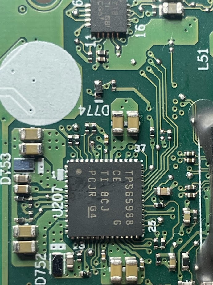

            You have me doubting myself now but top view being - a component installed onto the board, looking down on top of it?
            I am definitely looking at the same datasheet, and assume the central pads are under the chip.
            Dot in the corner for pin 1, also makes sense being bottom-left of the text on the chip, then anti-clockwise around it.
            It looks like they've tried to make it clear by marking partial pin numbers but they are actually for a 48-pin chip?
            Picture attached.
            However, I see the two pairs of caps top and bottom go to the 6th pins in from the right, and those are definitely grounds.
            Is this a horizontal mirror image of the datasheet? e.g. upside down like you hinted.
            Are the chip markings wrong? Surely dot should be top right of the picture if this is the case?

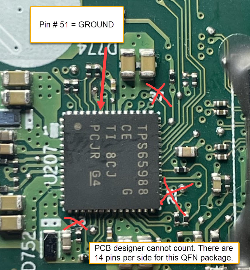

              See attached.
              1) PCB designer cannot count - the silk screened pin numbers are not correct.
              2) Confirm again that you are indeed on pin # 51 which should be ground. Is the solder on the actual pin #51 intact ? You can confirm it with a resistance check to ground.
                Sorry yes that pin 51 and pin 20 are the ones I meant in first post that seem wrong.
                And yes I went for the pin 51 you marked. You can see I marked above it by probing.
                One of those two pins is 70k to ground, one is 130k to ground.
                I think we both have the wrong datasheet or the datasheet pinout is a bottom view, or the chip is installed flipped horizontally?
                If you look at what would be pin 23 and pin 48, they are both 100% grounds, 0 ohms.
                There are even a few caps using the trace/areas as their ground side.
                I’ll try checking voltages tomorrow with the view of the datasheet being a bottom view and see if it makes more sense

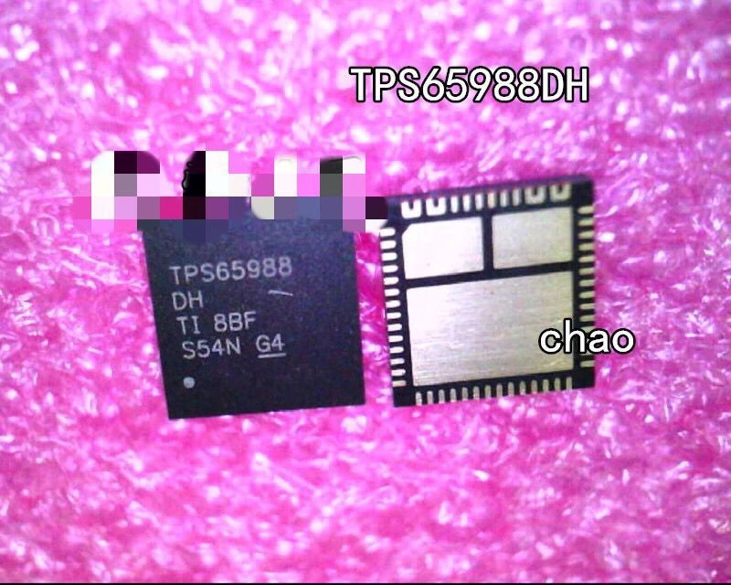

                • piernov
                  • Jan 2016
                  • 4437
                  • France
                  TPS65988DH and TPS65988CE pinouts are not compatible. Refer to schematics.

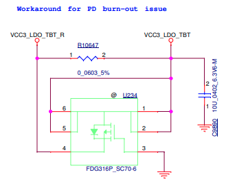

                      Maybe a sidetrack but I found the attached in motherboard schematics, "Workaround for PD burn-out issue".
                      The 0 ohm resistor is already there on my board but the mosfet is not.
                      I'm not sure what installing the mosfet would achieve, it is already bridged with the 0 ohm resistor, and that is still there in the workaround.
                      If the mosfet turns on is it just going to connect the same things that the 0 ohm resistor already is?
                        • 21439
                        It has an @ so its not installed
                        • jamesportman
                          • Sep 2022
                          • 14
                          Ah thanks, my board is already set up like the workaround in that case.
                          So originally they might have installed the mosfet without the 0-ohm, then had issues with it burning out? So now the workaround fix as a revision?

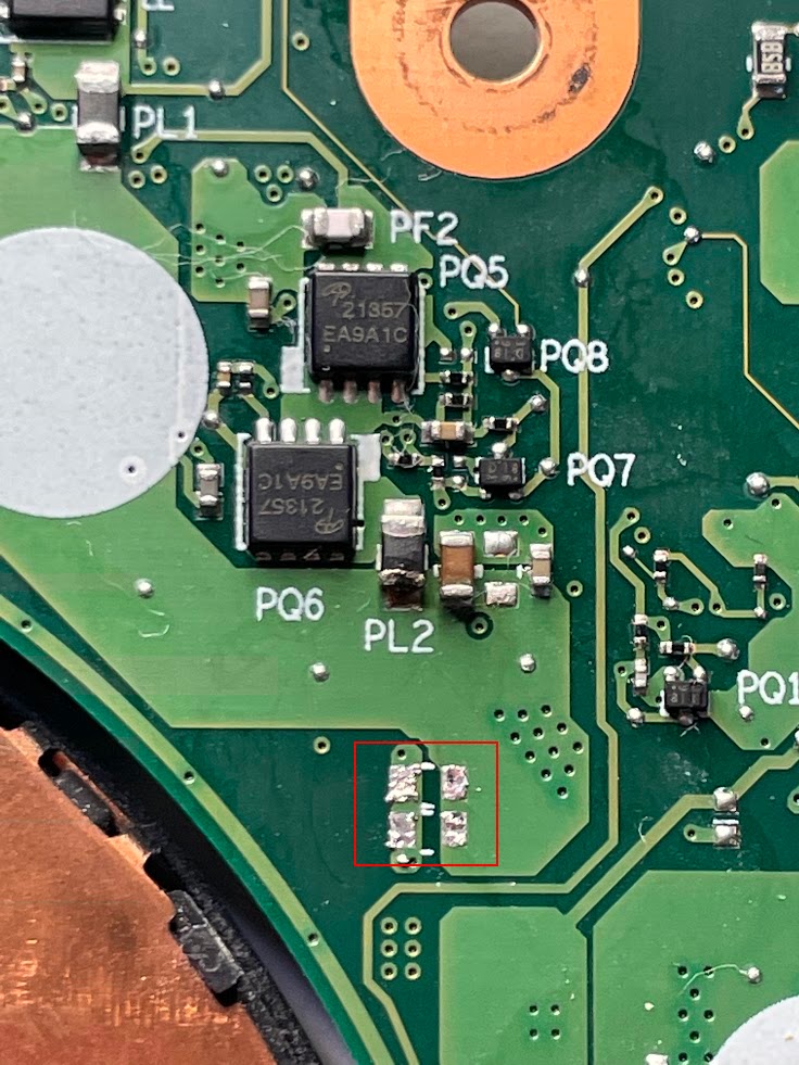

                              OK "fixed" it.
                              In case it happens to someone else..
                              I went off looking at the 20v lines since they were not working but the comms chips seemed OK in general.
                              Had to inject voltage and use iso alcohol to see it evaporating much faster.
                              It was a cap from the 20v line to ground that was almost 0 ohms resistance.
                              This showed up as the 20v input from charging circuit "VINT20_IN" towards the main power section showing as almost no resistance to ground.
                              Picture attached.
                              Both of those were getting hot so I removed both, tested, put the good one back.
                              Datasheet shows 6 caps from that area, so I've lost one.
                              It was one of 4 that were the same size so I think it must be 10 microfarad.
                              There are 2 more smaller ones that will be the 0.010 uF.
                              Powers up just from the AC adaptor now, will check batteries now charge also.
                              Thanks for help
