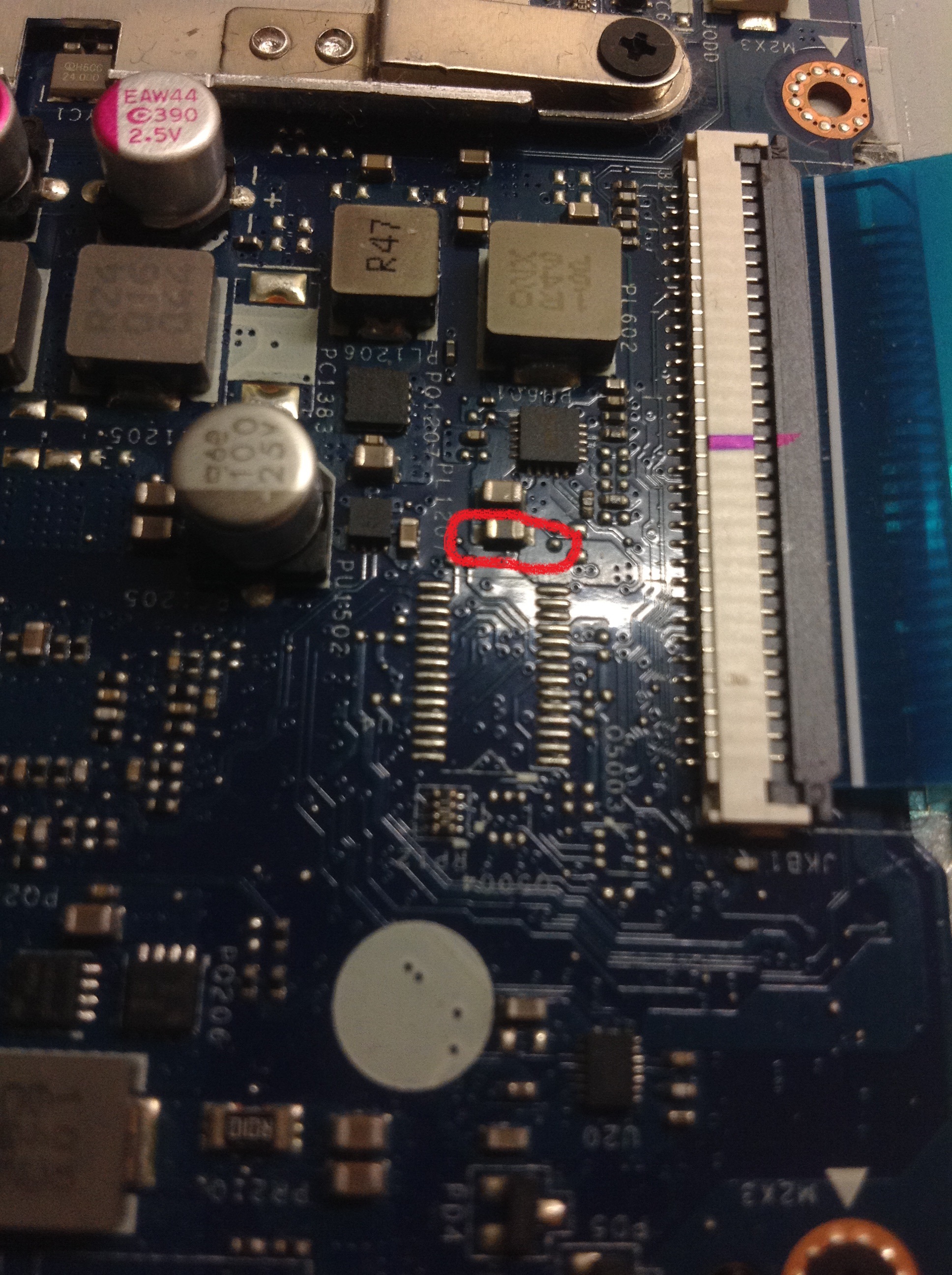

Can anyone identify the component circled in red, from a REV4.00 board, i have searched for a schematic, but unable to locate one, removed blown component but board still not powering up.
Bdl50 la-d704p rev 4.00 question
Tags: None
Re: Bdl50 la-d704p rev 4.00 question
You should try to make a better picture where the colours are more clear. But from what I can see it should be an inductor and also the only one on this rail so obviously really important.
However you should also make sure that the load side of the attached buck converter is healthy
