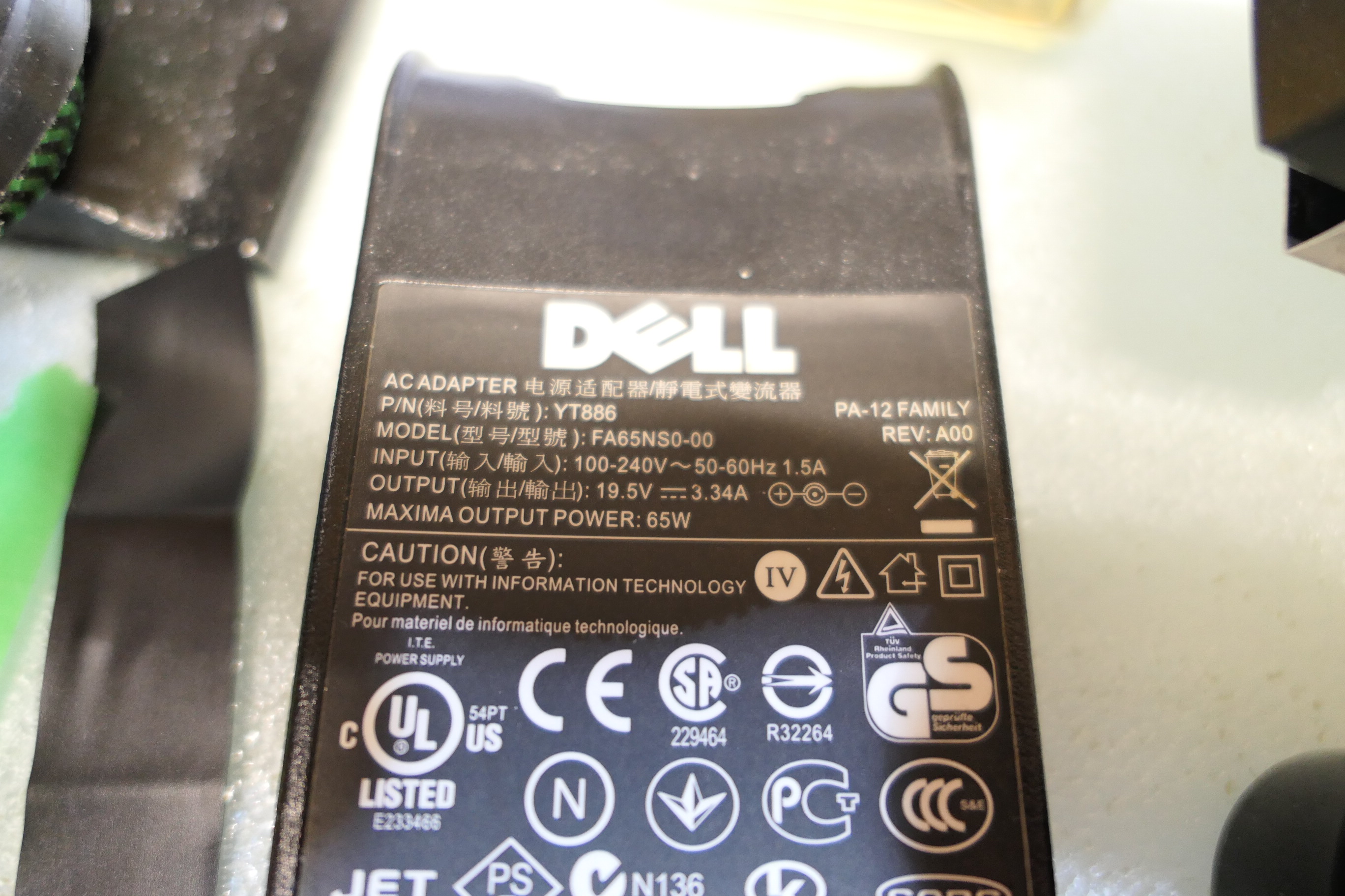

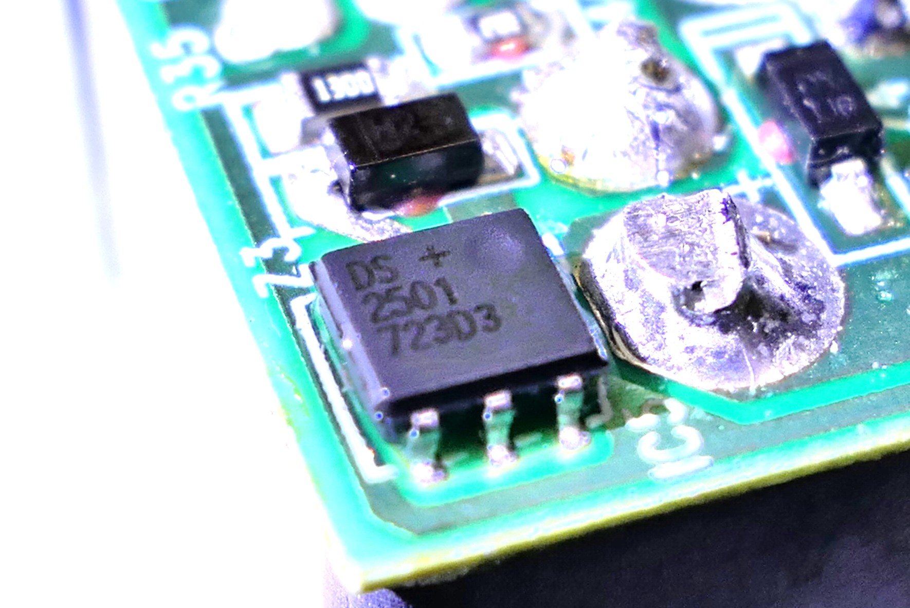

    Trying to identify this chip which is part of the circuit that sends a signal to the middle pin of the power supply to tell the laptop this is a Dell power supply.
    Markings are: DS+ 2501 723D3
    Many thanks for your help!
    Ray

    Re: Trying to identify chip in a Dell FA65NS0 power supply
    Hi, it's a DS2501 from Dallas Semiconductor. More informations from this post.
    https://www.badcaps.net/forum/showthread.php?t=21661
