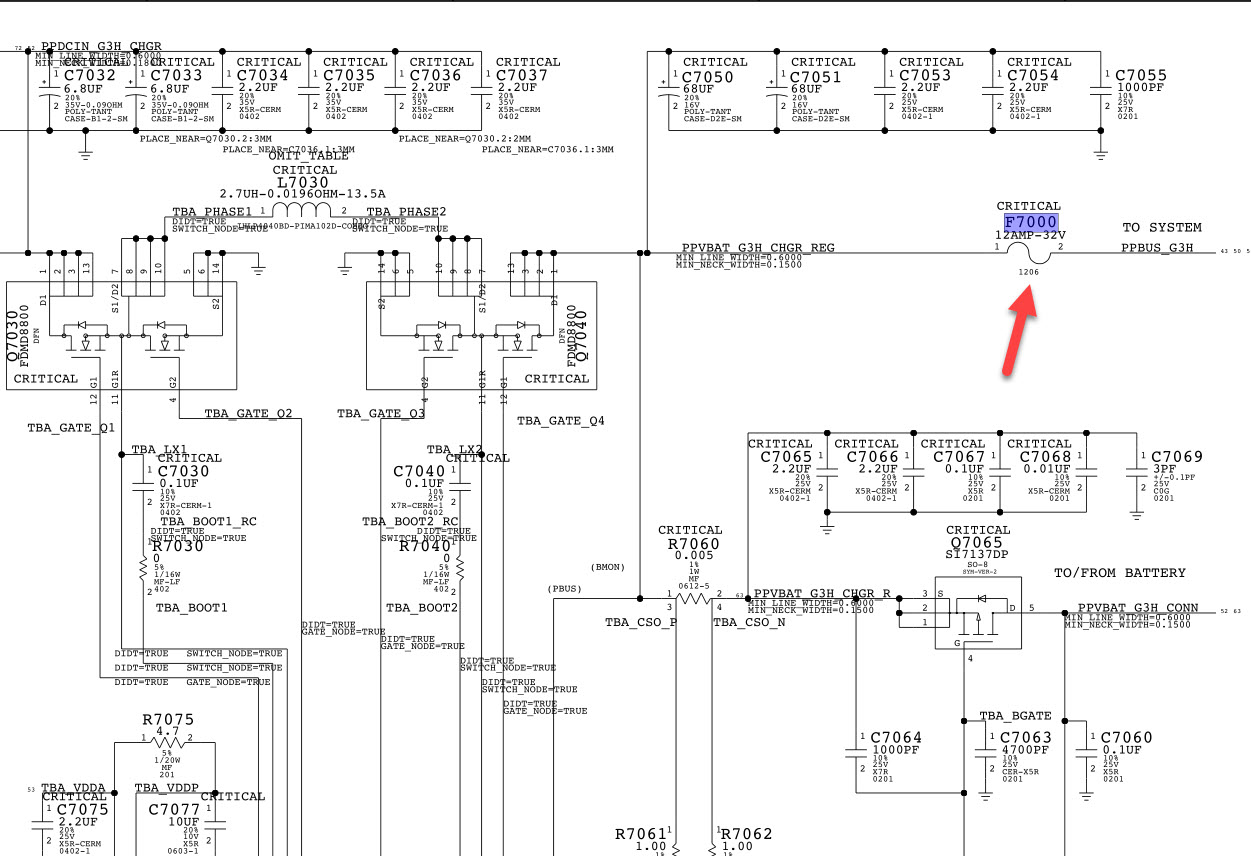

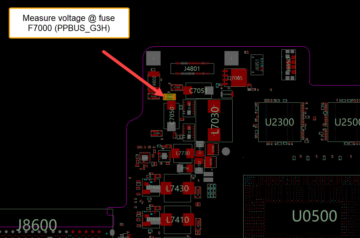

        Download the schematic from here:
        https://www.badcaps.net/forum/showth...0840+schematic
        See attached -> measure the voltage on both sides of fuse @ F7000.
        This is a critical power rail for the logic board = PPBUS_G3H.
        Meter in 20V DC scale.
        Red meter probe on F7000 (pick either side) + Black meter lead to ground.
        Then check the other side of the fuse with the red meter probe.
        This should be with the external AC power adapter (Apple original).
        Post your measurement.

            Re: Macbook Pro A1708 blown cap...
            Unfortunately it's not the fuse. Getting 12v either side of it.
              What is the exact voltage of PPBUS_G3H ?
                  On such logic board designs, the decimal place accuracy of the voltage reading is important.
                  See here about PPBUS_G3H:
                  https://logi.wiki/index.php/PPBus_G3H
                  So is it 12v2 or is it 12v6 ?
                  The 12v6 kicks in once the SMC controller has requested the regulator to boost the voltage rail. The exact voltage on this rail will help to decipher how much of the logic board is working.
