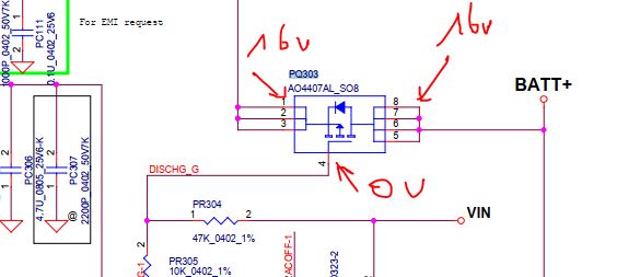

          Review the main power rail with only the charged battery. What is the voltage?
          This voltage travels from the battery to the main rail through the 'battery mosfet'. It may be defective but check the voltages on the mosfet pins.
          Interested in the following:
          Pin 1-2-3 = source pins.
          Pin 4 = gate pin.
          Pin 5-6-7-8 = drain pins.
          Check the voltage to ground of this mosfet.

            I check the mosfet PQ303
            sourc and drain = 16v
            gate =0v

                a) PQ303 appears to be allowing for the battery voltage to reach the logic board.
                b) without the AC adapter, using only the battery, allow for the logic board to turn ON. After it turns off, measure again the voltages on PQ303.
                Post the readings.

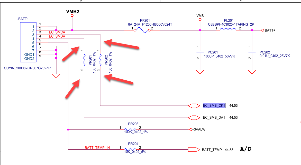

                  Confirm again the voltages of the SMBUS signals - check the voltages BEFORE and AFTER each of the series resistors.
                  If the logic board is not able to detect the battery, then most likely the SMBUS communications is failing. SMBUS (I2C) is used to communicate with the BMS (battery management system) logic board that is inside the battery pack. This BMS board holds the model / serial # / # of charge cycles / configuration of the battery pack.
                  If you allow for the logic board WITH the battery & AC adapter to boot into Windows -> does Windows show detection of the battery ?

                    i use only the battery the voltage on PQ303 source and drain = 16v gate=0v

                      the voltage ON SMBUS=3.3V
                      yes windows detect the battery and the percent of charging .
