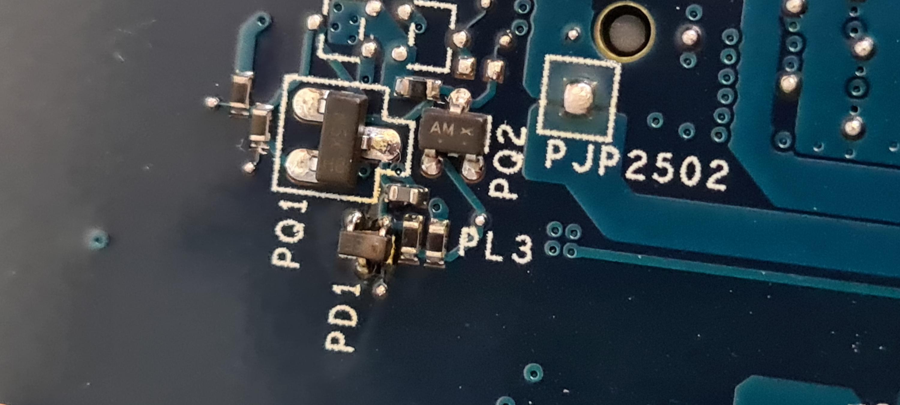

    Can anyone help me identify the PD1 component on LA-K001P motherboard?
    • 31289
    Re: DELL 15 3505 LA-K001P PD1 - Identification Needed
    probably a diode - what does it say on it?
      It's damaged so, I can't see. Any ideas?

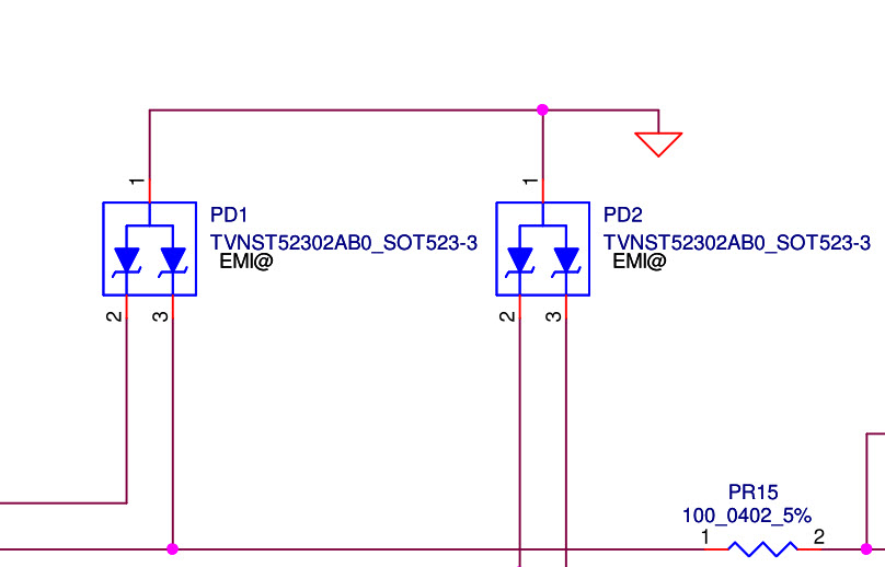

        Unable to locate schematics for this Dell board.
        In checking OTHER Inspiron schematics - found the attached for PD1. It is very possible that this is the same component as yours.
        Review if the common ANODE (pin # 1) is GROUND on your board.
        p/n TVNST52302AB0 (SOT523 = looks the same size as on your board)
        Dell (Foxconn) likese to use this exact component on many other logic boards they manufacture.
        Datasheet is attached. It is a common part that can be replaced by many other vendors.
            Hi, thank you for your help. I just checked and pin 1 is connected to the ground.
                TVNST52302AB0_SOT523-3 this works ok. thanks you
