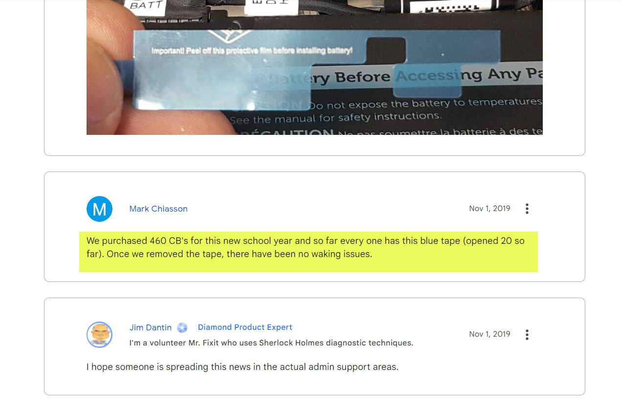

    The attached appears to be the 'fix'.

      I have a handful of students who consistently have this issue, I'm going to crack open their Chromebook and check the battery to see if it has that blue film on it. Fingers crossed! Thanks for the reply!

        From the above thread - they ALL have this blue film. Appears to be a production fault. Curious to know of your results.
