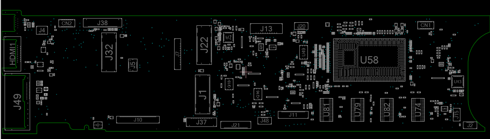

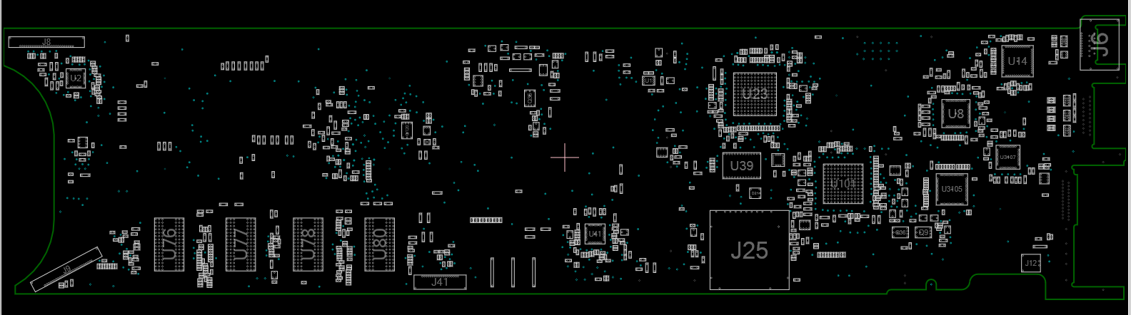

            Does your board look like the attached?

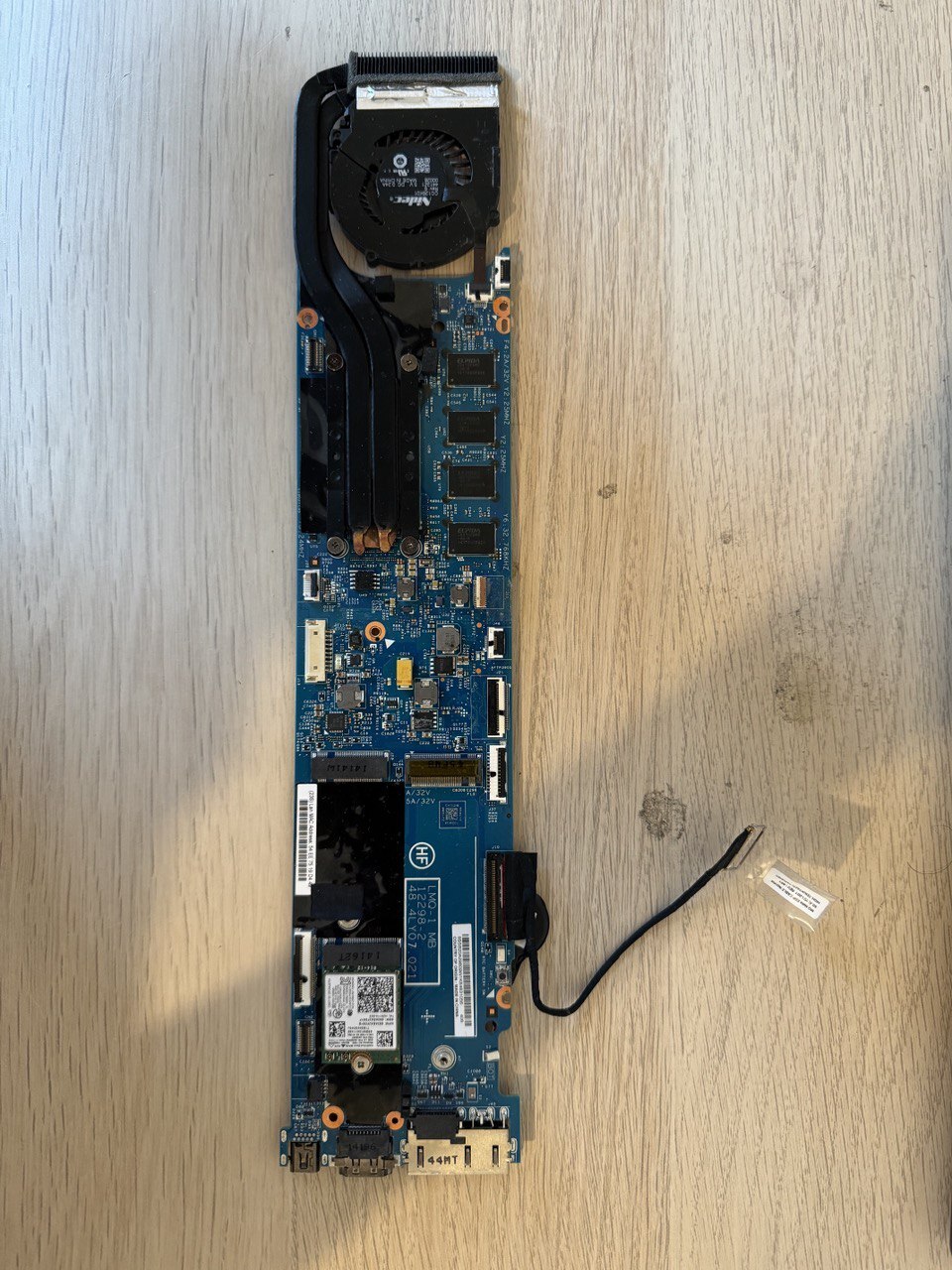

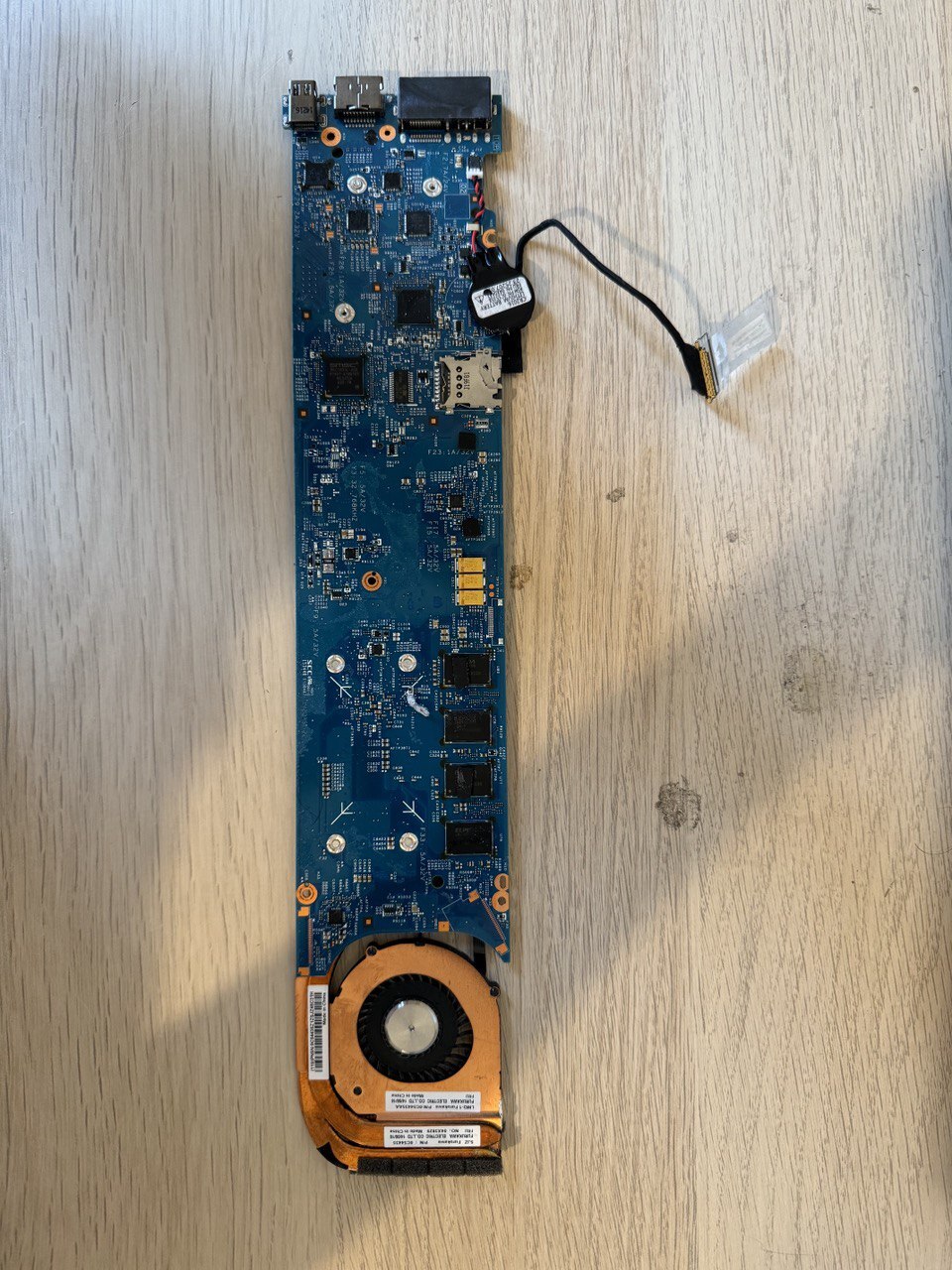

              Yes, it is exactly the same board. You can also see photos in the attached

                  Try these:
                  Boardview & Schematic Lenovo Thinkpad 12298-2 - Badcaps
