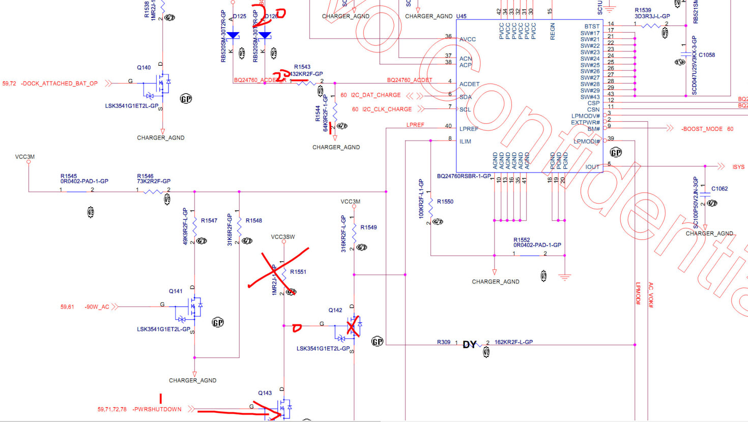

    I assume that the "gate" of this mosfet should be "low" if "DISCHARGE" is "low" and "-PWRSHUTDOWN" is "high". I've checked "DISCHARGE" and it is 0V (Good). Then checked "-PWRSHUTDOWN" but that's also 0V (Problem). "-PWRSHUTDOWN" (coming from U101 which I assume is the Power Management Hub) should turn "high" if "VCC3SW" is present by a pullup resistor. I have checked "VCC3SW" and it's present (3.3V) on the board. Based on the schematics, the pullup resistor is R1101. It's measuring 32.4K.
    ...and now I don't know what should I check next

    Still haven't figured out what causes "-PWRSHUTDOWN" to be 0V but after some digging, I came across a post in a Chinese forum which when Google translated to English has some promising information.
    The post starts with the "VINT20" generation sequence. (As far as I know, "VINT20" should be present on a working motherboard when a charger is plugged in but we know it's not present on mine because "CV20" is 0V) What caught my eyes here is every single component (diodes, mosfets, resistors and the chips) that is mentioned in this section has the same marking as in the motherboard (LMQ-1 MB 12298-2 48.4LY05.021 motherboard) I'm trying to fix. Either it has been written for the X1 Carbon or other Thinkpads use the same circuit (more likely to me).

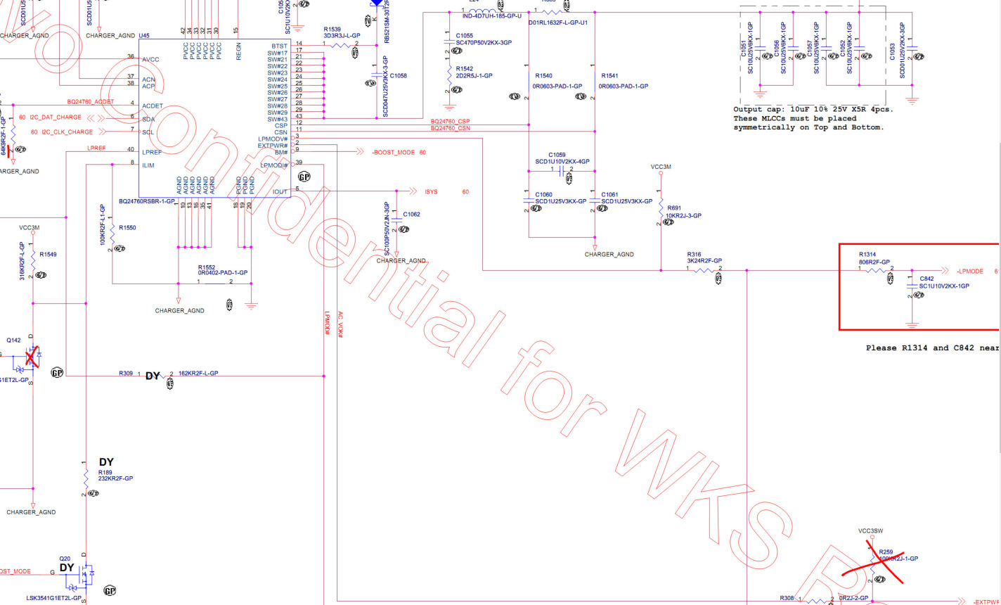

    Anyways, it has a section that lists the possible reasons why "-PWRSHUTDOWN" could have no voltage. After Google translating it, it has the following to say:
    1. VCC3SW causes the -PWRSHUTDOWN pull-up resistor to have no voltage. If D6 is disconnected, if there is still voltage in VCC3SW, the parts connected to U58 or RTCVCC may be defective. Defective parts connected to C611 or VCC3SW.
    2. The thermistor causes -PWRSHUTDOWN to have no voltage. Use an oscilloscope to measure the instantaneous voltage of U101 PIN98 when it is powered on. If there is a voltage, the thermistor is bad. Use a multimeter to measure the resistance of the thermistor to find the bad location.
    3. If the above is OK, use a multimeter to measure whether the capacitor C606 and diodes D64, D8, D56, D62 are broken down (the diode is unidirectionally conducting) or the U101 is bad. If the above is still OK, you can pry open the U101 PIN96 to make the PWRSHUTDOWN voltage normal (the VINT20 voltage is also generated normally), and then measure whether the motherboard voltage is abnormal and the maintenance is OK.
    1. Not sure if I fully understand this one. Should I desolder D6, plug in the charger and see whether VCC3SW is still present? Is this safe? RTCVCC is present, it's 3.3V. Checked D6 with my multimeter (diode test) and it seems to be okay.
    2. A thermistor? I did not find any on this motherboard or I don't know where to look Boardview shows no component marked with TH<number>. I can imagine the battery having one but the battery is disconnected.
    3. C606 is not present on this motherboard (even though it also shows up in the boardview), all of the mentioned diodes (D64, D8, D56, D62) are okay.

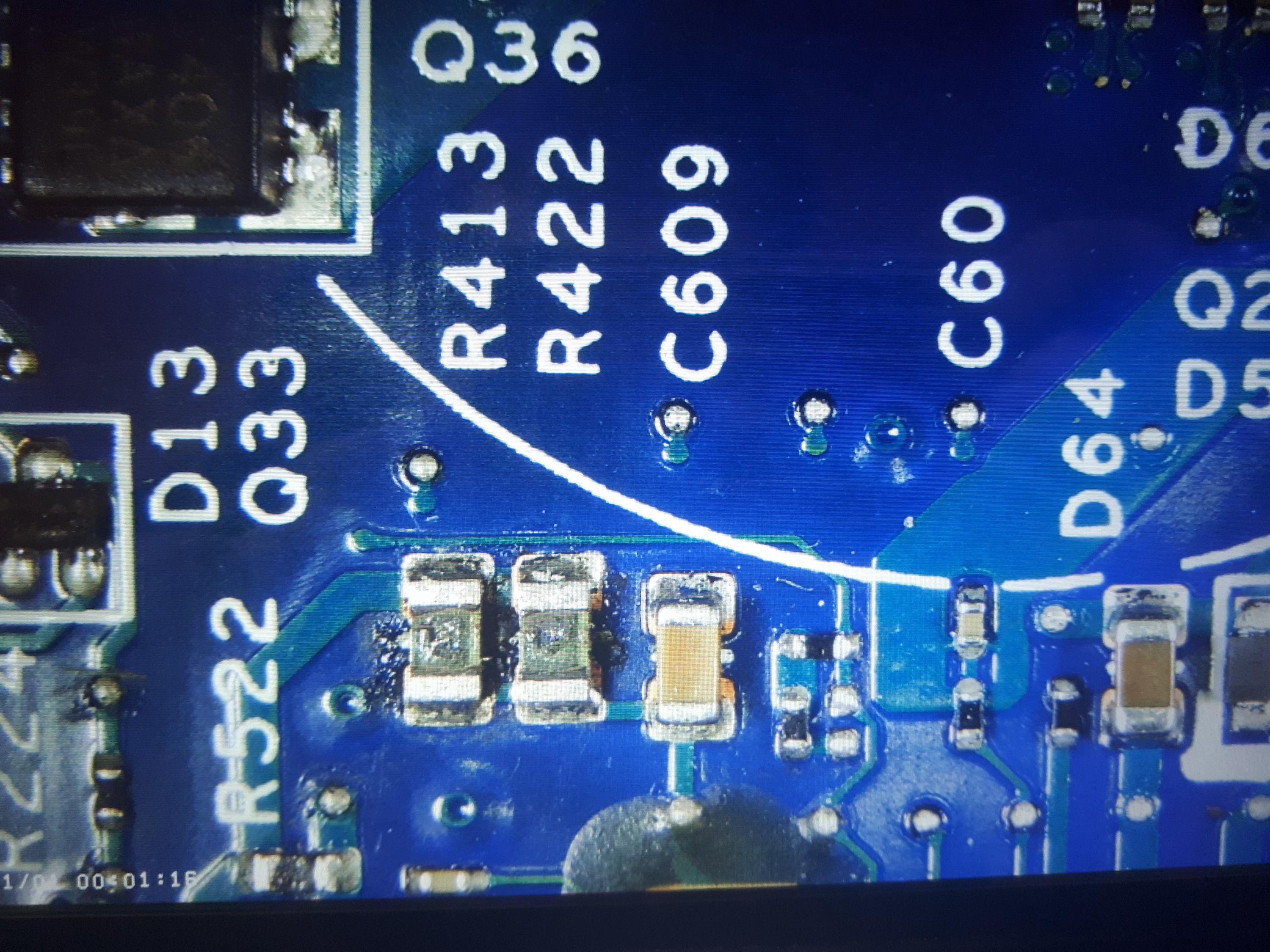

        1. I have realized that the resistors marked "R413" and "422" (both are "20R3J-5-LL-GP" according to the schematics) are burned. I haven't noticed this before as "VREGIN20" were present and showing the correct voltage (19.7V). Based on what I've read these are "anti-surge" resistors. They should be 20 ohm each. Of course its impossible to get such resistors locally in my country and I didn't find them on Aliexpress either.
        I went with the next best thing which is to get a donor motherboard that has them. Didn't find any X1 Carbon motherboards for sale but it seems like (based on the schematics) other Thinkpads are also using ones with the same specs so I've bought a broken T420s motherboard (no power) which should arrive next week. I hope that I can re-use the ones from there.

          The faulty T420s motherboard has arrived and I have successfully replaced "R422" and "R413" with the ones found on this board. Checked the ones removed from the X1 carbon motherboard and one of them measured 12.7 ohms while the other was 15.4 so they were indeed damaged. The resistors extracted from the T420s motherboard were both 20 ohms.
          Surprisingly after that I was back to step one: "no power". The gate of Q9 was 19.90V again. So I have measured the voltage on the TH_DET "leg" of U101 and it was 1.2V. (Through the "TH_DTCT_TE" net) According to what I've managed to found, this should be much lower...so I have started measuring those thermistors again (RT1-RT6) but this time I've measured their resistance to ground (because one topic I've found suggested this) and RT1 come up with like 1.2 MEGAohms. Checked the other (RT2,RT3,RT4,RT5,RT6) and all of them were between 0.56k and 3.52k which is much lower. I went back to check RT1 again but this time it was 4.33k...and I have no idea what has changed.
          Anyway after the measurements I have plugged in the power supply and the gate of Q9 became 6.68V (from 19.90V), "TH_DET" is 0.30V (from 1.2V) and I'm back to the issue where I was stuck before I've replaced the damaged resistors (The laptop shuts down immediately after I press the power button).
          I feel like this board is trolling with me.

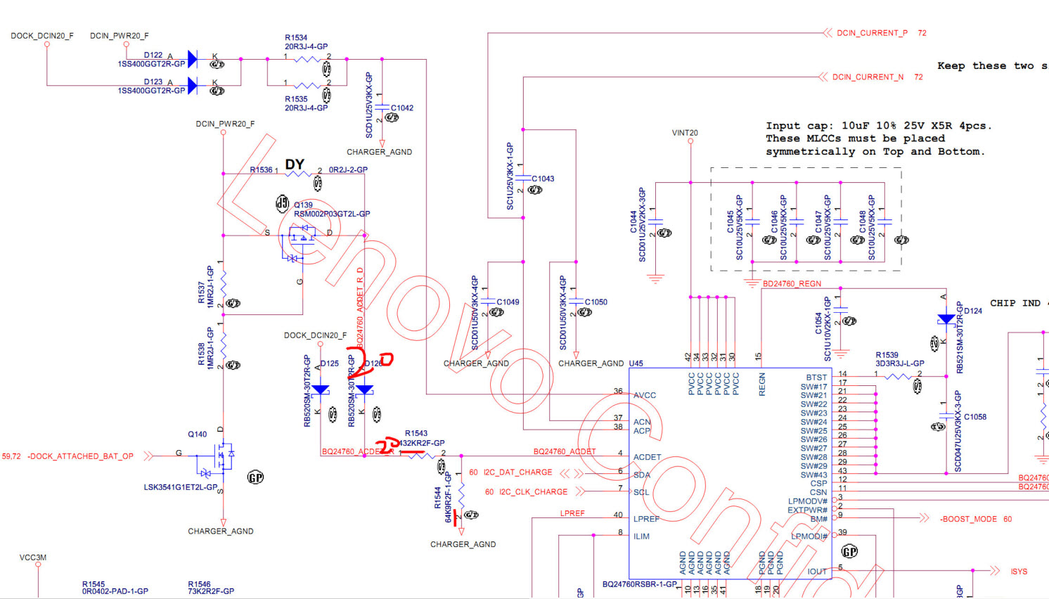

                    So the 24760 is yet another charger IC built by TI under private label. Must have been as successful as their OMAP processors
                    The idea now is to review how the 24760 is wired and attempt to review the measurements against other TI charger ICs with public documentation.
                    See attached on a schematic found that uses this IC.

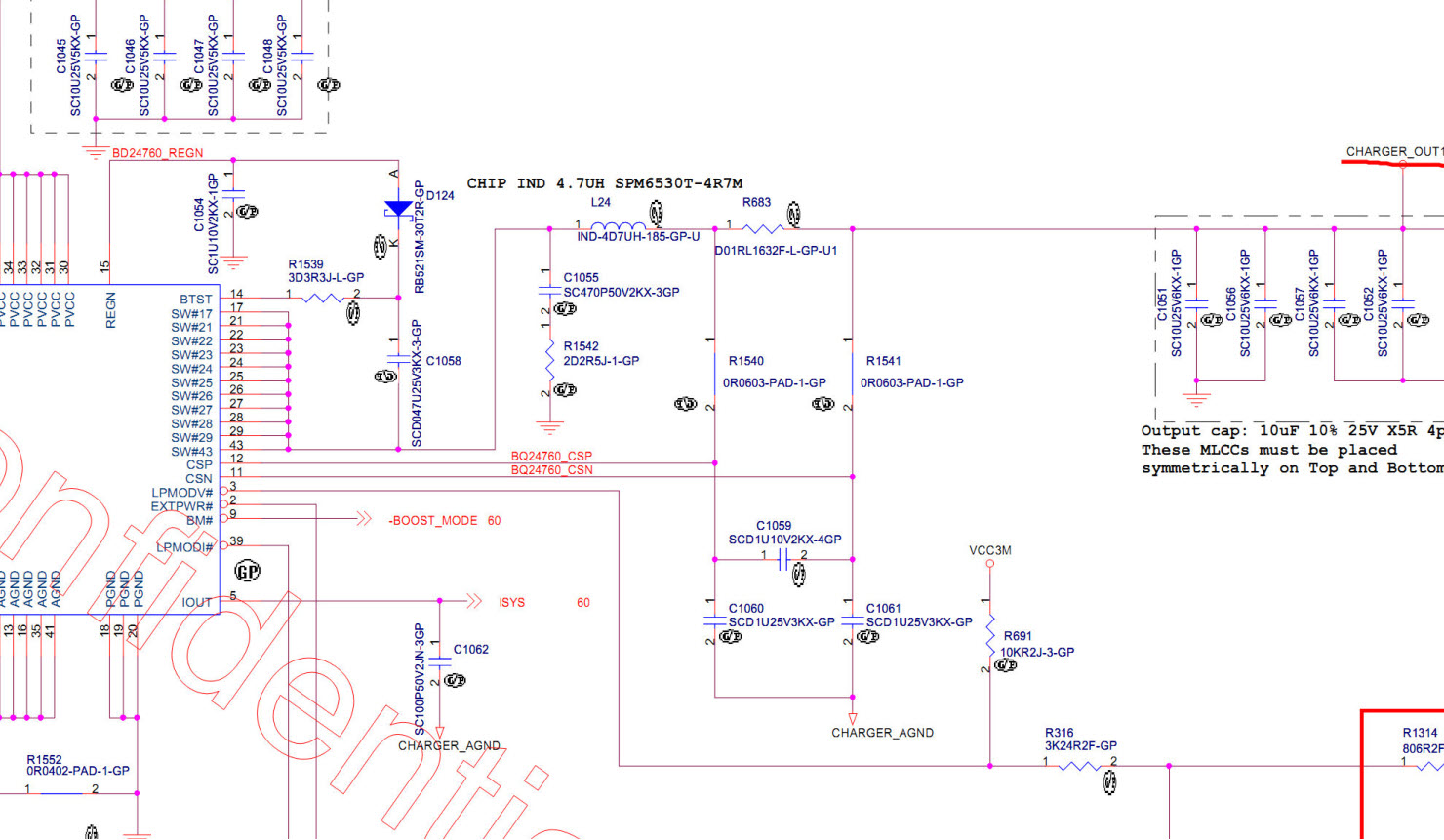

                    Start with carefully - very carefully measuring the voltage of the following pins:
                    ACDET (pin #4)
                    REGN (pin # 15)
                    CSN (pin # 11) ; charger current sense
                    CSP (pin # 12) ; charger current sense
                    what are the voltage readings ? Red meter lead on the pin; black meter lead to ground. Be sure your probes are fine tip to support these measurements.
                    Post the readings.

                      Here are the measurement results:
                      ACDET (pin #4) => constantly changing between ~0.56V and ~0.80V
                      REGN (pin # 15) => 6.16V
                      CSN (pin # 11) ; charger current sense => 0.61V
                      CSP (pin # 12) ; charger current sense => 0.61V
                      pin#11 is called "CHARGER_OUT12" by the boardview all other pins are having the text (ACDET, REGN, CSP) in their name that you are refering. Might not matter.

                        The ACDET reading is not good.
                        Typically, the design will use 2 resistors as a voltage divider to lower the very high voltage (ie. DCIN from the adapter) to a safe value that the charger IC is able to read as a 'good adapter voltage present' value.
                        So remove all power. Trace back this pin # 4 and locate the 2 resistors that should be close by. One resistor will go to the DCIN adapter voltage.
                        Then the same pin # 4 will have a resistor to ground. The combination of these 2 resistors = voltage divider.
                        Use your meter in resistance mode - start with a high scale. Then measure the resistor value that is between this pin # 4 and the DCIN adapter.
                        Then measure the resistor value between this pin # 4 and ground.
                        Post both readings. From your readings, we can calculate what the proper expected voltage should be at this ACDET pin.
                        From the last post, the ACDET is too low for the charger to believe that an adapter is even connected to the logic board so nothing to do...
                        Late PS: Do you have schematics for this thing? If yes, can you post them here ?

                          Anyway what you said in your previous post about the typical design seems to be true for this motherboard.
                          Pin#4 is connected to "R584" and "R227".
                          The other side of "R584" is part of "DCIN_PWR20_F" so I think that this is the resistor we are looking for. Measured it and it's 407k. Measured "R227" as well and that one is 64.4k.

                            Okay, I've just realized something important.
                            I made a leep of faith and (under my microscope) measured the voltage on "R584" (on the side that is connected to the IC) and it's a stable 2.64V. I have no idea how the test point shows a constantly changing voltage under 1V when both are in the same net. Anyway I've learned the lesson, I will measure components whenever possible.
                            Is 2.64V still bad for ACDET?
                            • mon2
                              • Dec 2019
                              • 14360
                              Re: Thinkpad X1 Carbon gen2 (LMQ-1) no power
                              Sorry, my bad - I recall your post from before but into too many threads. That and still not 100% recovered from covid but almost there so that is my excuse
                              This is a good value (based on readings from other TI charger ICs).

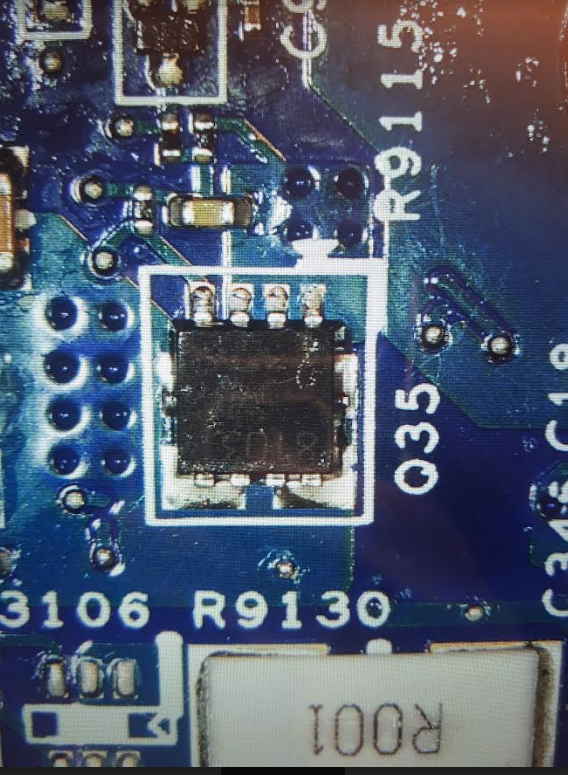

                              1) Measure and post the readings for the I2C bus lines = SDA & SCL = pins 6 and 7 of the charger IC. The I2C bus is a 2 wire interface used by the host CPU (BUS MASTER) to communicate with slaves (charger ic, etc.) with unique addresses. Using the clock to shift data INTO / OUT OF the slave, the data lines then spit data back and forth to configure the parameters of the charger IC (in this case).
                              If either of these lines are 'stuck', then no communication can occur.
                              Interested in the voltage readings of each of these 2 pins. Do measure with care.
                              2) Next, remove all power. Measure the resistance values on the battery mosfet @ Q35 like before. Post the readings for each combination of the mosfet pins.
                              source (1-2-3) & drain (5-6-7-8)
                              source (1-2-3) & gate(4)
                              gate (4) & drain (5-6-7-8)
                              Meter in lowest scale. If you see '1' or 'OL' then the scale is too low so use the next scale setting.
                              Searching for a low resistance = mosfet is defective.

                                2)
                                I'm a bit puzzled about this one as the boardview shows that Q35 has 8 legs while I can see 10 when viewing this mosfet from the top.
                                As the readings are pretty consistent I didn't worry much about it.
                                1 - 5 => ~14 Megaohm
                                1 - 6 => ~14 Megaohm
                                1 - 7 => ~14 Megaohm
                                1 - 8 => ~14 Megaohm
                                2 - 5 => ~7.5 Megaohm
                                2 - 6 => ~7.5 Megaohm
                                2 - 7 => ~7.5 Megaohm
                                2 - 8 => ~7.5 Megaohm
                                3 - 5 => ~9.2 Megaohm
                                3 - 6 => ~9.2 Megaohm
                                3 - 7 => ~9.2 Megaohm
                                3 - 8 => ~9.2 Megaohm
                                1 - 4 => 476k
                                2 - 4 => 476k
                                3 - 4 => 476k
                                4-5 => OL (even on 20M setting)
                                4-6 => OL (even on 20M setting)
                                4-7 => OL (even on 20M setting)
                                4-8 => OL (even on 20M setting)

                                    By the way, is that charging IC mosfet okay based on my measurements?
