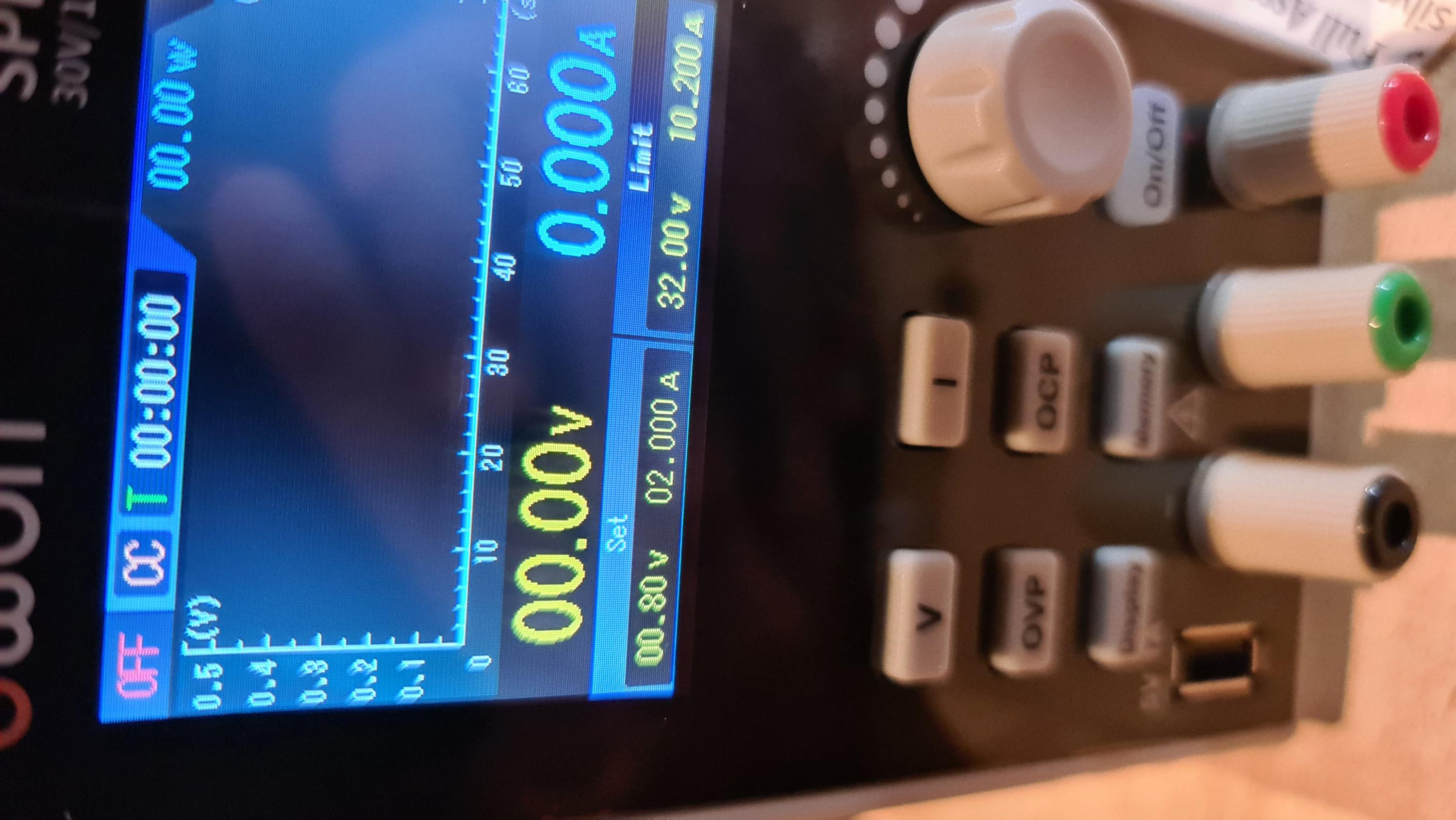

      Hi mon2, I get the power supply now. should I now set 0.8 volts and 2 amps? br
      • mon2
        • Dec 2019
        • 14003
        Re: MacBook Apro 16" A2141 Just 5,181Volt
        Sounds good.
        • Strolch
          • Nov 2017
          • 237
          • Deutschland
          A picture of my beautiful power supply ;-). I think so its right 0,8+2A
          • mon2
            • Dec 2019
            • 14003
            It is nice ! Congrats on your new baby
            I would check the output with a multimeter and confirm it is 0v8 when the outputs are ON. Just to be safe before use.

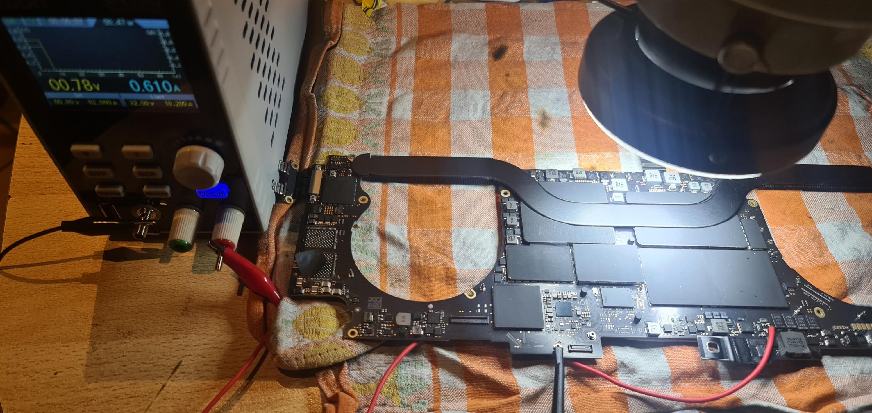

                      H, I'll solder one wire to pad 2 and stick the other to ground. I don't have a thermal imaging cam yet. But that's coming. But I have alcohol. At 0.8 volts and 2A nothing got warm yesterday. can i take more
                      • mon2
                        • Dec 2019
                        • 14003
                        #31
                        yes, you can increase the current. When you do this process - do you see the current peak to the set value on your power supply ?
                        leave the voltage down for now as we do not know if there are other possible shorted mosfets which can kill the CPU.
                        • Strolch
                          • Nov 2017
                          • 237
                          • Deutschland
                          #32
                          Yes, I have the adjustable power supply ;-)
                          • Strolch
                            • Nov 2017
                            • 237
                            • Deutschland
                            #33
                            I think 0.8V is not enough. I can't find a warm spot. br. I Hope ist right so ;-) br
