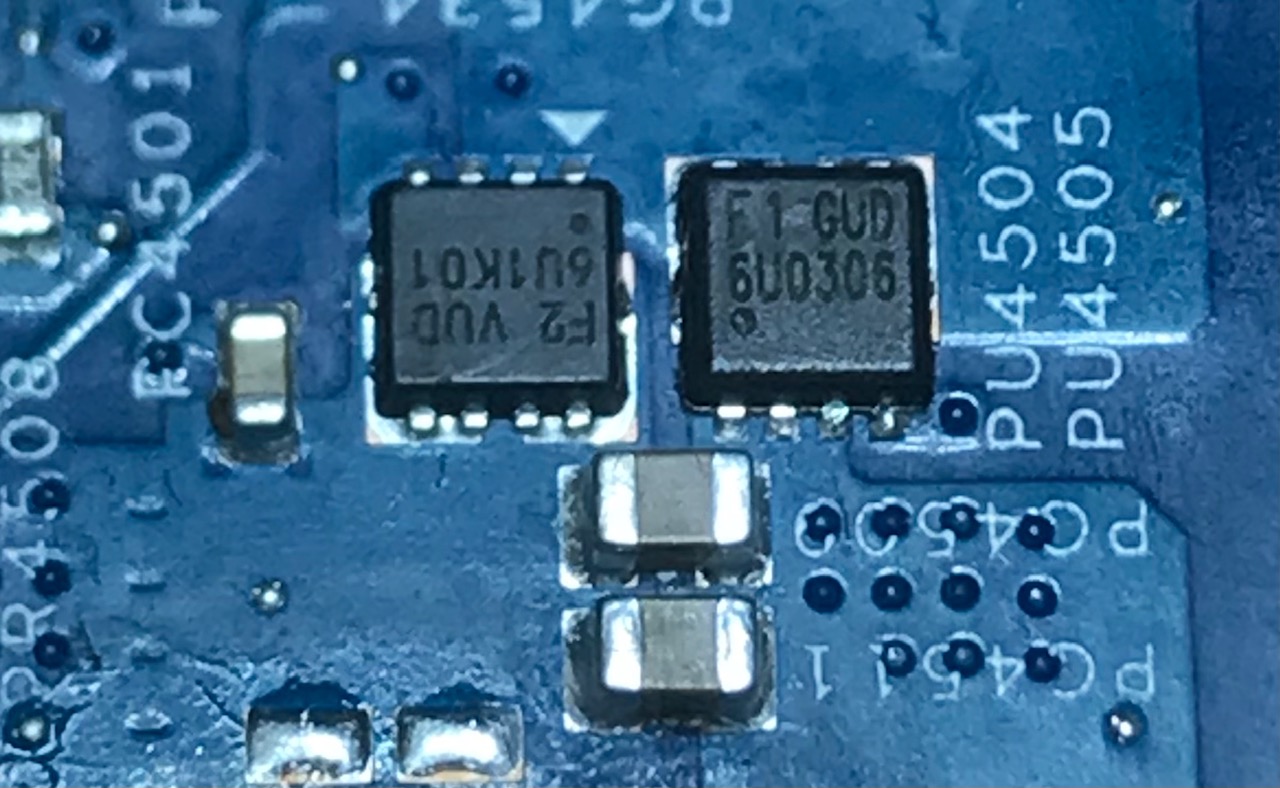

    Hi there!
    can someone help me with some infos about these 2 components. i think there are mosfets? but no idea to search them from the markings. if someone more experienced could help me with some details to find them or find some replacements I will appreciate!
    both of them are shorted and need to be replaced
    markings :
    F1 GUD 6U0306 & F2 VUD 6U1K01
    many thanks!

    What is the motherboard part number,have you looked for a schematic

      HP Envy 17 - Haymitch 2G MB - 17888-1
      but i didn't find any schematic or boardview...not available yet

        I think they`re made by NIKO-SEM but havn`t found the part numbers yet
        Edit: F1 *** PE600BA http://nikosem.webdo.cc/manager_admi...ad&Pval=498897

          F2 - Mosfet PE606BA

            and for the F2? should I use same ? PE600BA? or PE606BA ?

                For F2 you must use the same part PE606BA .For F1 you must use the same PE600BA

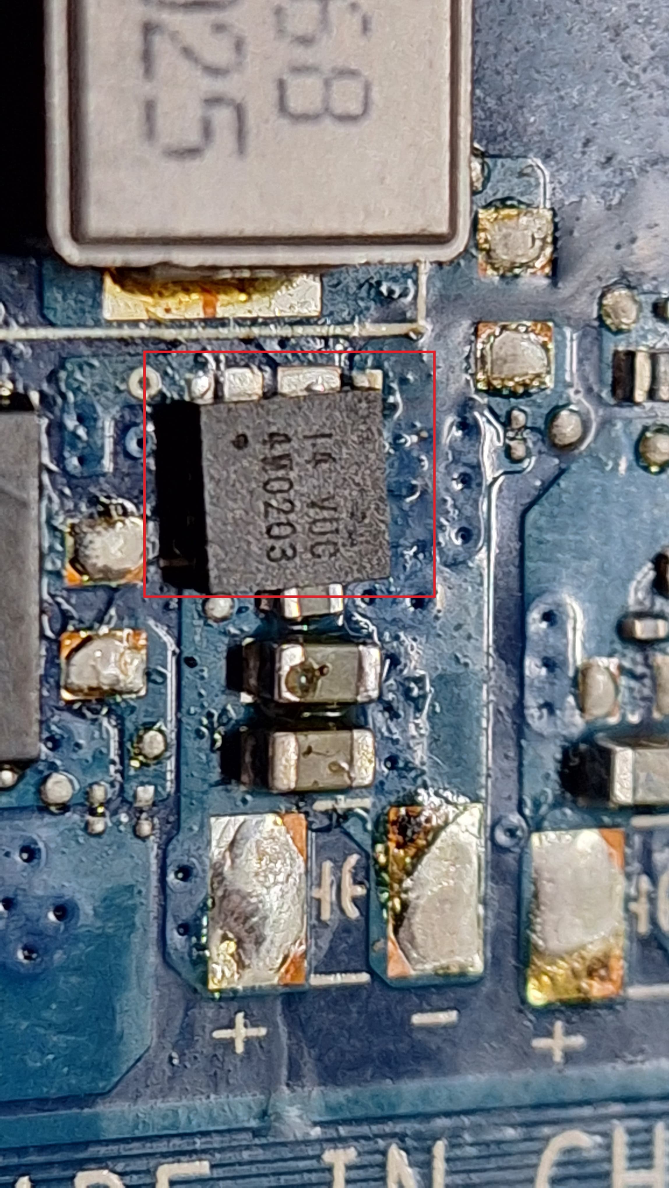

                  hello everyone, please help to identify this component I4 VUC
