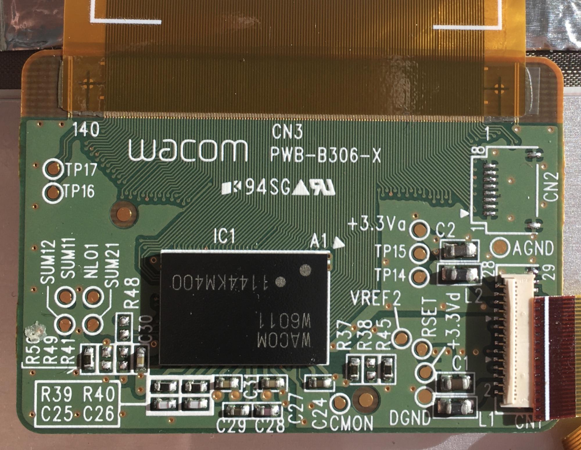

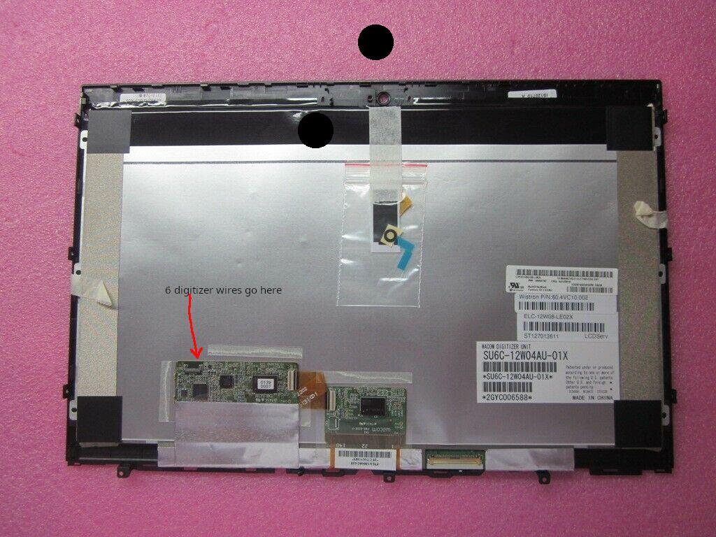

    I was working on my ThinkPad X230 Tablet and accidentally cut one of the very thin wires (0.2mm thickness). It turns out it was the ground wire (GND) for digitizer. There are 5 thin wires for digitizer and here is the schematic for it:
    pin description
    23 USBP4+
    24 USBP4-
    25 STOP
    26 VCC3BLEDBD
    27 GND
    I turned the laptop with wires 23-26 all active and flowing to digitizer board BUT ground wire not connected (cut). Now when I turn the laptop on, neither touch nor pen is working. I tried and soldered wire 27 back together and turned the laptop on. Same, no finger touch or pen. They are not recognized under Windows either. I have attached high quality photos of both finger touch and pen/stylus PCBs.
    I was wondering what happened? Have I fried the digitizer pcb? Anyway to identify which component got damaged and fix it? Any pointers are welcome. Thank you!

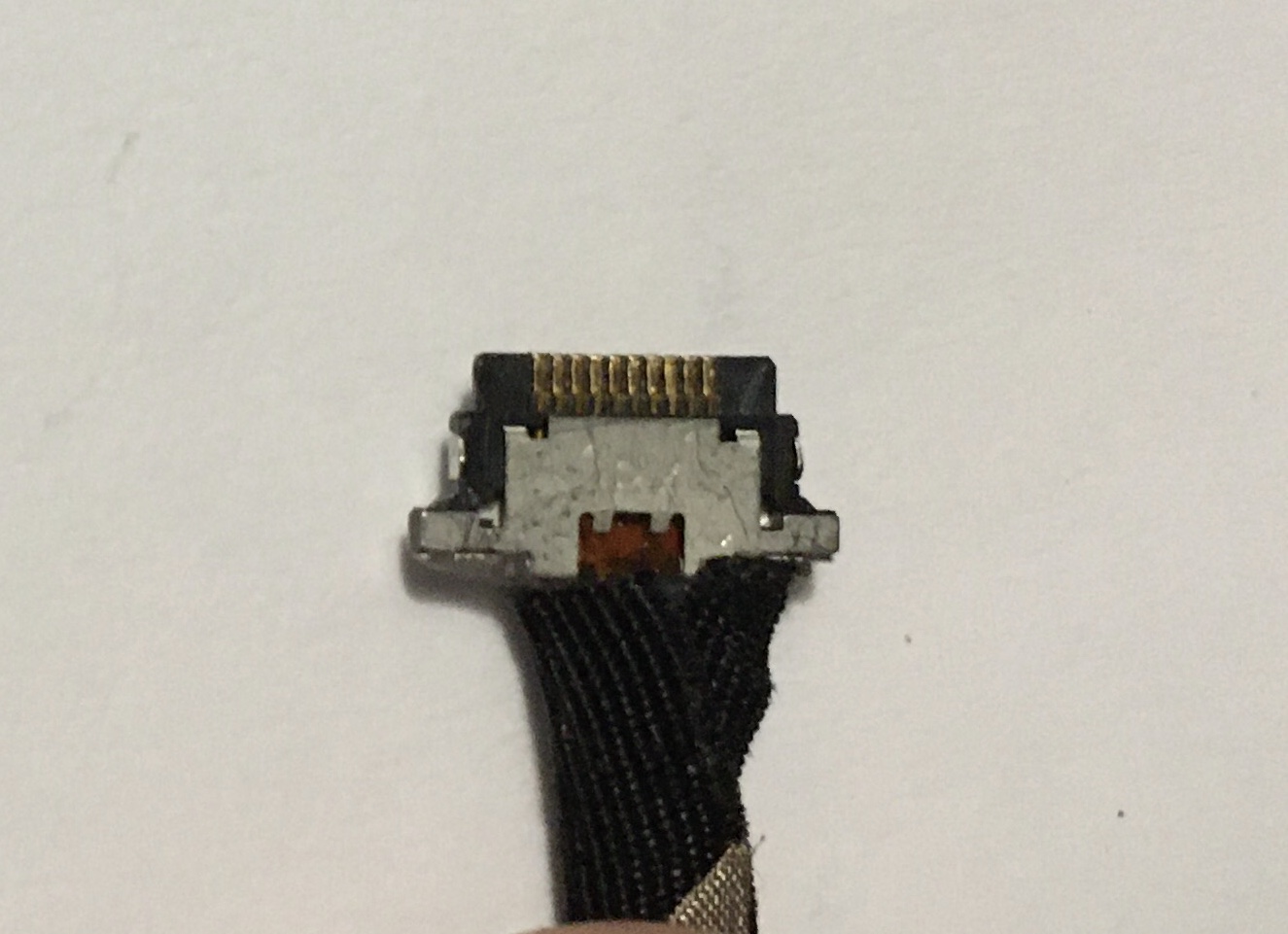

    The connector in the pics is silk screened '1..10' and there are 10 solder contacts (not 5).
    Can you share clear pics of the mating cable for CN1 ?
    Respectively, you should have 10 contact points to review for the pointing widget.
    Most likely, the fault is probably a broken connection between the 2 parties.

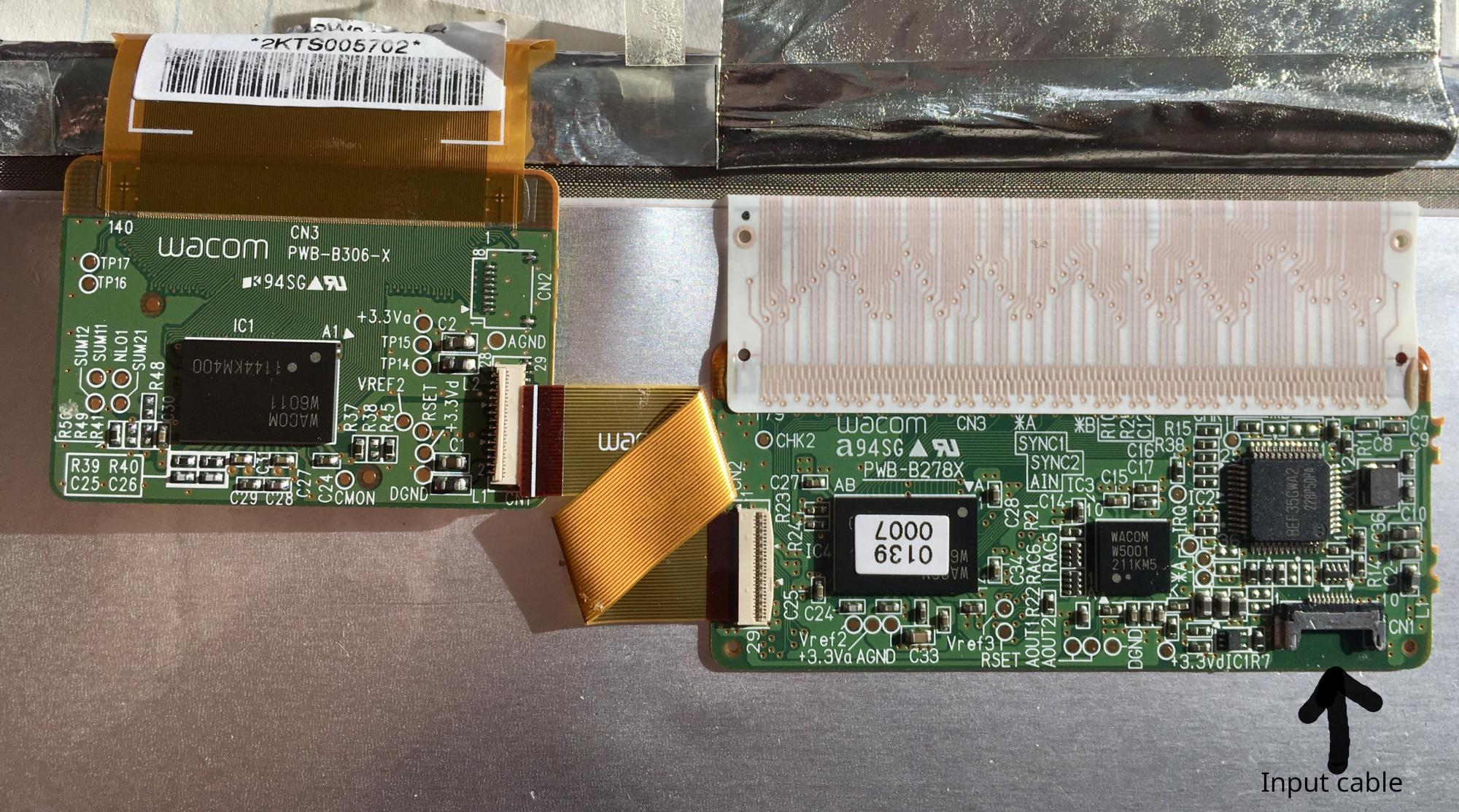

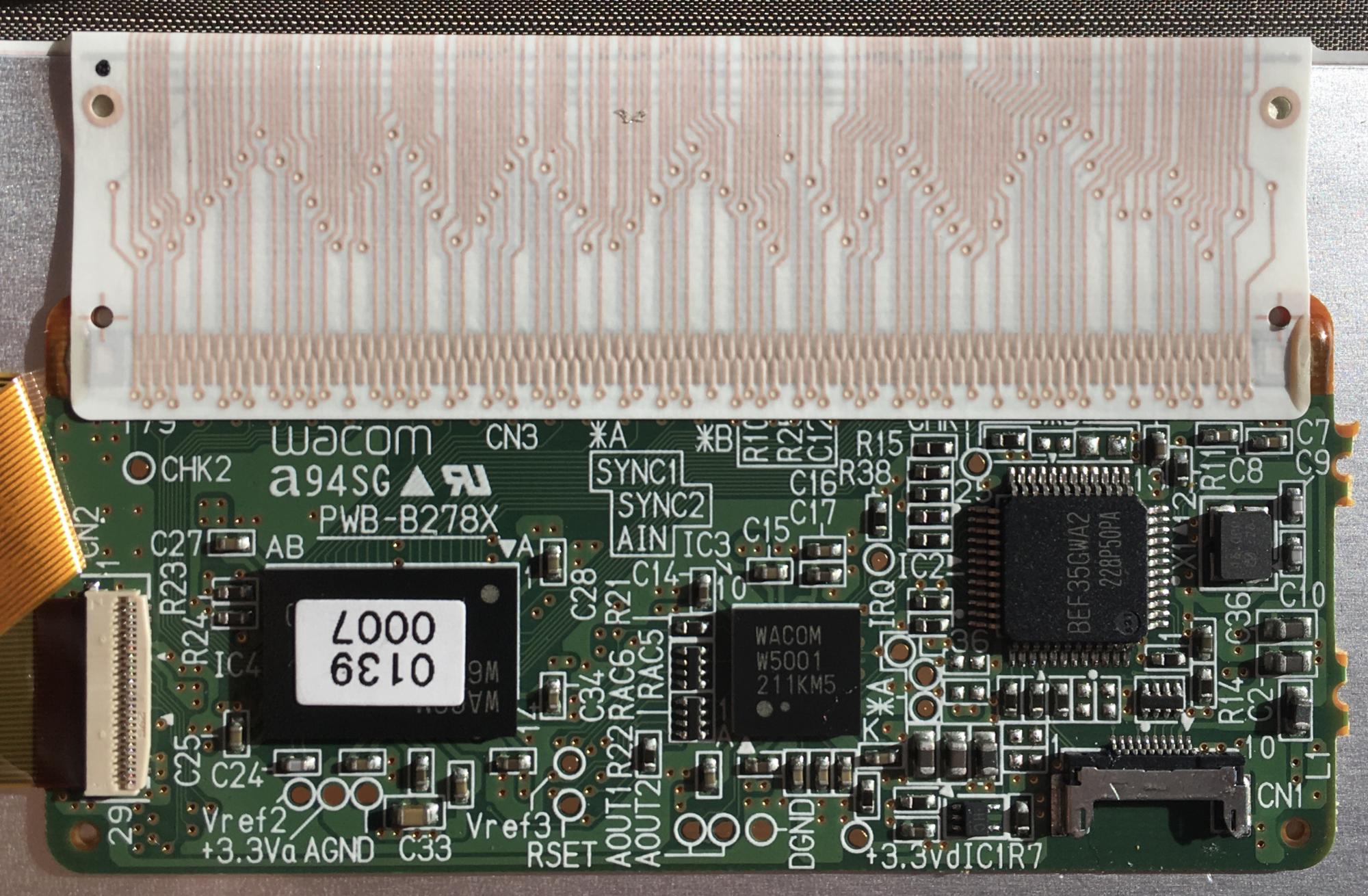

      Re: ThinkPad X230T digitizer and pen not working anymore!
      Thanks for your reply @mon2.

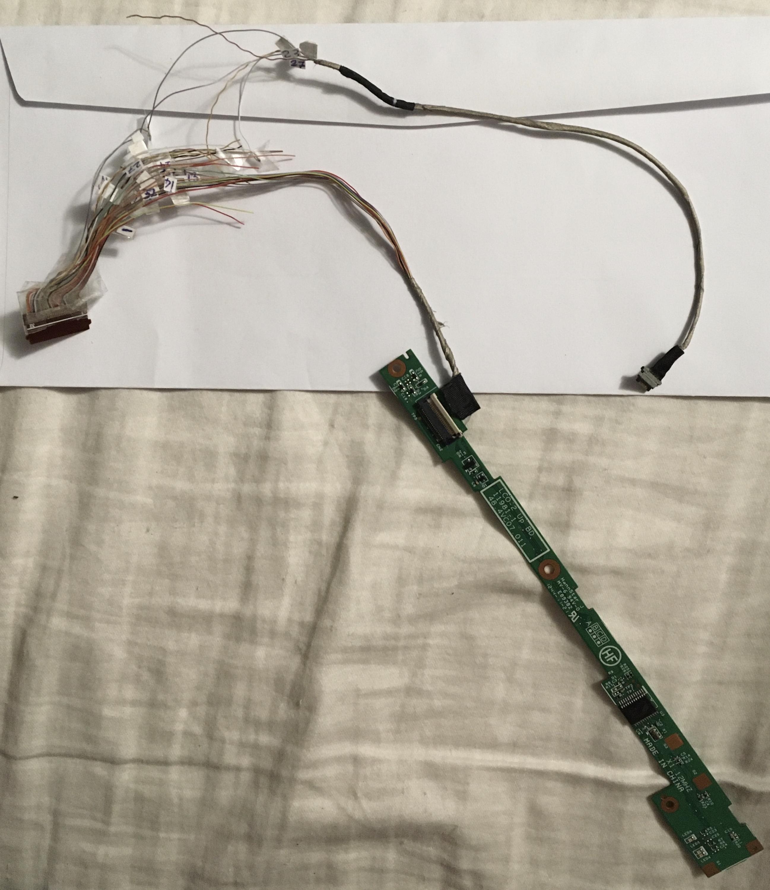

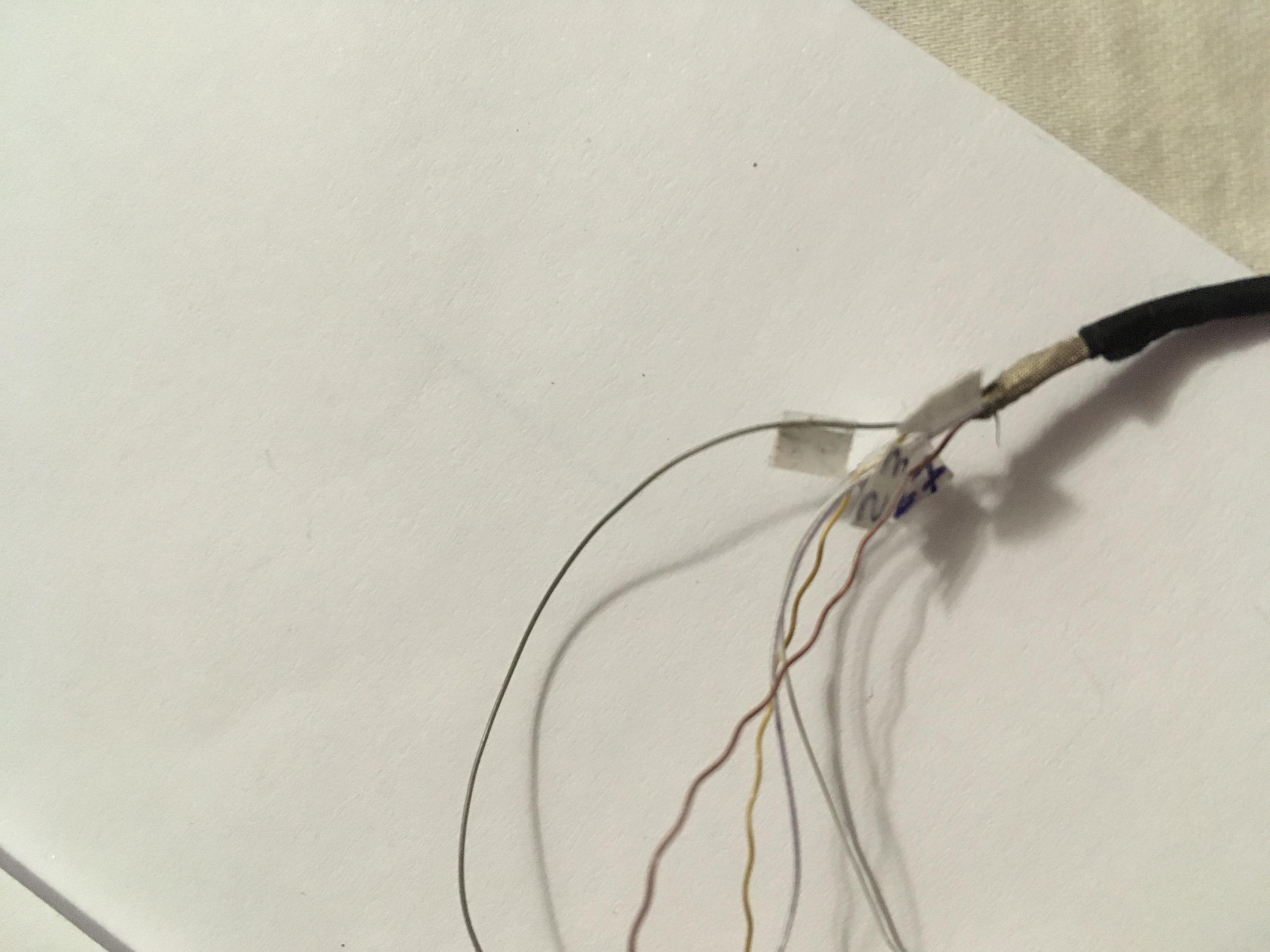

      I have attached a few photos, close-up from CN1 mating cable as well as the whole cable to give a better idea. (Please let me know if they are not clear enough and I can take better photos)
      As you can see in the second photo, there are only 5 thin wires that go into CN1 (digitizer/touch pcbs).
      Looking at the whole cable: the big end on the left connects to the laptop motherboard. There are 32 thin wires which are grouped into 4 bundles. Let's call them A, B, C, D:
      bundle wire# description
      A 1-14 Tablet buttons and front speakers
      B 15-22 fingerprint reader
      C 23-27 digitizer
      D 28-32 microphone
      You can see I have cut bundles B and D. Could this be the reason? Even though they go to other areas of the laptop that have nothing to do with digitizer!
      Also a few of the cables are loose now, when I had them running in laptop I made sure they are connected. Also using a multimeter, when I connect positive probe to +3.3Va and negative probe on AGND or DGND, I can measure 3.3v flowing into digitizer pcb.

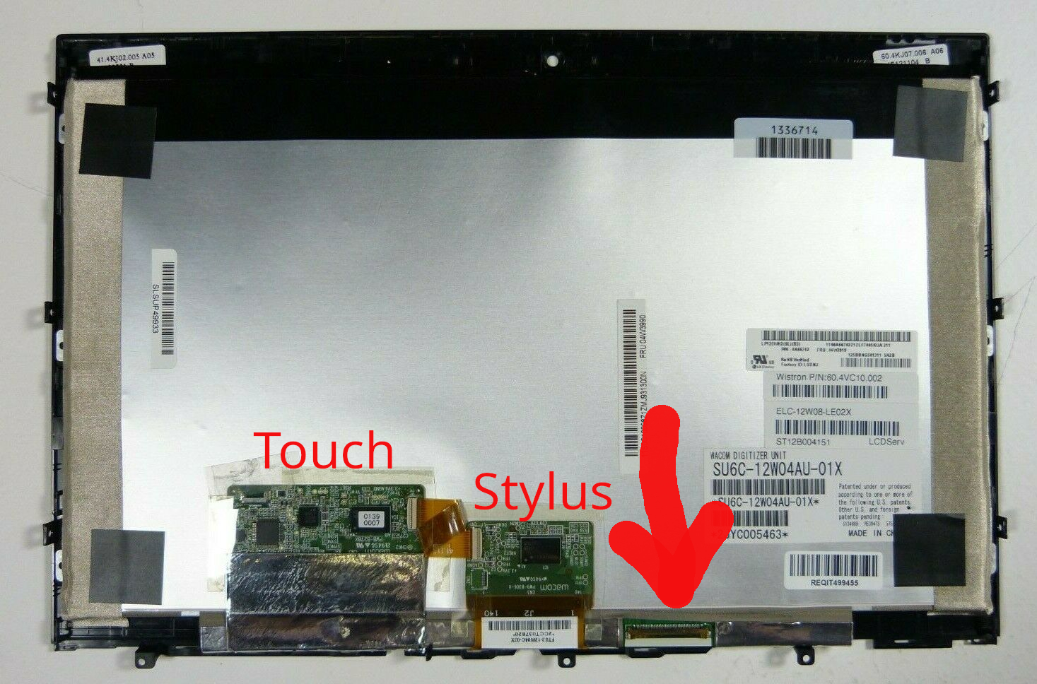

        I also found it odd that there are only 5 wires for both functionalities of touch and digitizer?! To me, these two are more complex and intuitively, I imagined there would be more wires needed! Especially when you look at connector between two PCBs (photos in my first post), there are 14 pins.
        My guess is: some data feed comes from the connector below marked with red arrow, maybe?!
          The connector with the red arrow is the video display connector.

            Right. And that doesn't contribute anything to the digitizer issue, correct? (LCD works flawlessly when I turn the laptop on)
            I am clueless what might have happened? Did I fry the pcbs by not having a GND wire and just these four wires flowing in? (USBP4+ USBP4- STOP VCC3BLEDBD)

                        Luckily I'm not in a rush as I have other laptops and PC. I am quite confident it's not the flex cable as all the traces match up and it looks good. My suspicion is that turning the laptop without GND thin wire killed one or some of the small components on the pcb. Which I'm not sure if this type of frying pcb is even possible. Thank you @mon2.
                        It's kind of a good learning experience too and if I can revive the touch and pen functionalities, it'd really make me happy and feel accomplished. That being said, if I can't I can send it to you.
