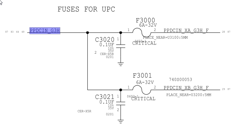

    hi folks
    I got this Macbook Pro A2159 that is no power. When I plugged in the charger with the ammeter, it wont glow s and no readings at all
    I check the unit for some short on the PPbus but is is ok, PP3V3_UPC_XB_LDO on the CD3217 measures 50ohms
  • mon2
    • Dec 2019
    • 14002
    Re: A2159 (820-01598) no power missing 5v 20v
    1) Post the voltage of PPBUS_G3H @ Fuse F7000, pin #2.
    2) Post the voltage of PPDCIN_G3H. See attached for fuse locations.
    3) What is the history of the unit ? Any liquid damage ? Check for possible corrosion on the logic board.
    4) Are you using the original or recommended Type C power adapter for this logic board ?
    5) The default output from the Type C adapter is 5 volts - do you see this voltage @ PPDCIN_G3H ?
      missing measures only 0.001V
      also missing measures 0v
      no signs of corrosion or liquid spill on the board, customer said they charged it on the generator power source
      yes
      no it is missing

        Post the voltage readings for
        PP20V_USBC_XA_VBUS (with your power adapter connected)
        and
        PP20V_USBC_XB_VBUS
        • ronelex
          • Oct 2016
          • 195
          • Philippines
          and
          PP20V_USBC_XB_VBUS
          this are 0v also, no short to the ground
          • mon2
            • Dec 2019
            • 14002
            Remove all power.
            Confirm that the Type C paddle boards are firmly seated onto the logic board.
            Assuming that they are, the details are pointing to a defective external power adapter.
            Hope you can source another Type C power adapter and test it again. Post your results.
            You do not have to use the Apple official power adapter - we are using the CUI brand Type C adapter for most of our testing but it will be practical if you can source a 60W or ideally 100W Type C adapter. This way, you can test anything from Apple (or other vendors) without concerns.
            There should be many such power adapters available in your many local malls.
