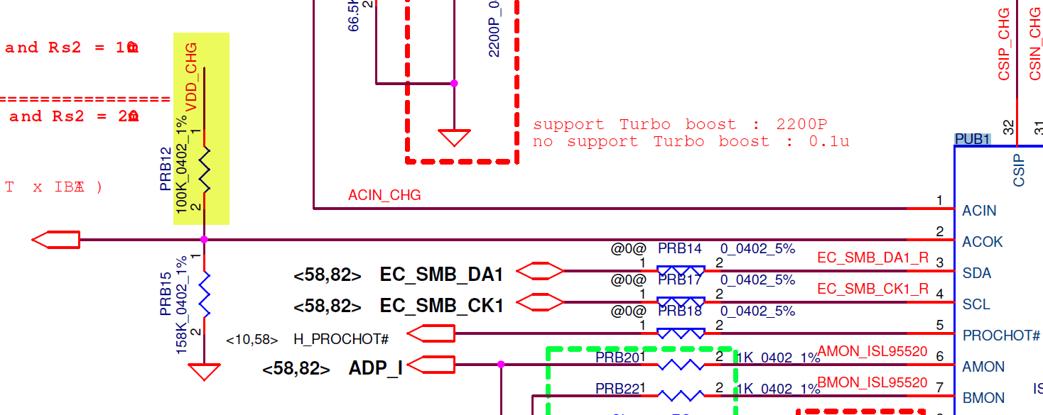

                                PQB11 is an N-channel mosfet and the GATE needs to be a more positive voltage that what it is passing between SOURCE & DRAIN to turn on. So for this case ~25V will be a good value.
                                With the GATE @ 4.66V, this mosfet will remain OFF.
                                The GATE voltage is created an a boost / charge pump inside the PUB1 device.
                                1) Confirm that PUB1 is soldered on properly. Flux it -> reflow it till it dances over the SMD pads with a gentle nudge of the tweezers. Never push the device with force otherwise the SMD pads will tear off, making it difficult or impossible to repair.
                                2) Test again.
                                3) See attached.
                                Pin # 2 of PUB1 is ACOK. Confirm the voltage @ PRB12, pin # 1. This should be ~5v13 = same voltage as pin # 19 of PUB1.
                                Remove all power. Check the resistance of PRB12 which should be ~100k.

                                  • mon2
                                    • Dec 2019
                                    • 14369
                                    Re: Acer AN515-54 won't power on, no leds, no fan spinning, black screen
                                    Mosfets with the high Mohm readings are good. Even with K readings or "OL" (over limit for the selected scale on your meter) are fine.
                                    Yes, if you can, replace PUB1. You can protect the surrounding parts with aluminum foil or polymide (kapton) tape so they do not go flying off the PCB.
                                    Flux and high heat with low to medium air pressure to remove without tearing off the PCB pads and to apply the fresh device.
                                    After the replacement, measure and post the voltages present on PUB1 with the charger. Do inspect for any visible solder faults before applying power.
                                    Take your time for a quality soldering of the PUB1 device.
                                    • madfreak
                                      • Aug 2012
                                      • 135
                                      • Poland
                                      Hi, it is exactly like You said. The soldering of PUB1... i have overheated that chip the first time when i replaced him probably or the soldering was poor.
                                      After double check the soldering of the PUB1 ( but i replace him to the new one ) that IC ( second new one ) came back to life
                                      I think that nfortunately the PCH is bad on 99% because that is only thing which is heating after voltage injecting and after connecting charger.
                                      But after all... there is a progress ... the LED-s are ON and the computer reacts to the power button...but the fans are not spinning and nothing more is happening ( black screen and so on ).
                                      I will try with a PCH replacement i think in near future so i will look for a motherboard to get that PCH chip.
                                      Thank You once again for a help, and if there will be a progress i will let You know.
                                      Have a wonderful day
