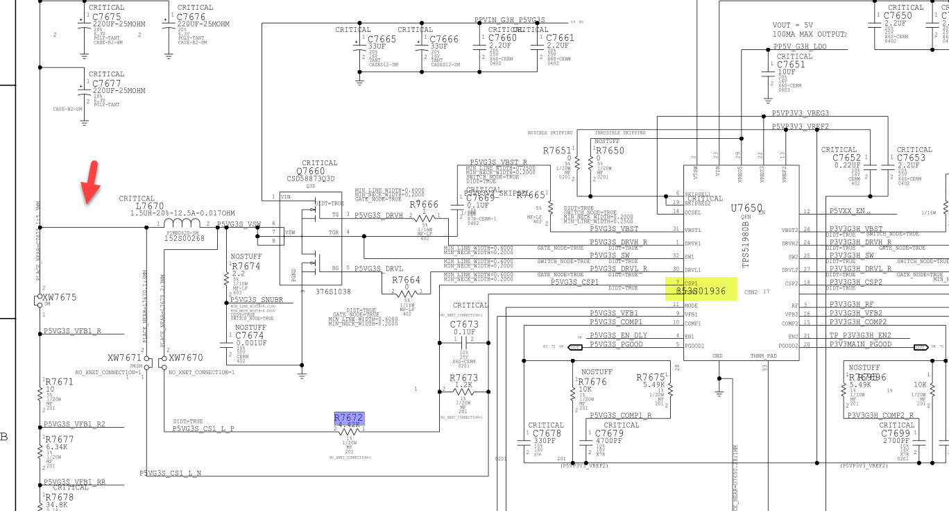

        So I got the laptop. Seller either didn't know or lied, either way there was corrosion from liquid on about 5 spots. Seems like water as there was no gunk or sugar.
        On first try, the input (original 96W charger) read 5V, 0.4A.
        After a thorough ultrasonic clean and dry, I get 20V and jumping current between 0.04-0.09A. So at least I got PD negotiation back.
        I have gone over the board under the microscope and I do not see any obviously damaged/burned parts.
        There was only a smoke trail on the thunderbolt connector itself, looks like a short from 20V (pin 57) to gnd (pin 1), possibly the charger took the hit.
        I have not found any blown fuses.
        Here are the bus voltages based on other threads:
        PPBUS_G3H 12.26V
        PPDCIN_G3H 20.30V
        PP20V_USBC_XA_VBUS 20.30V (depending on which is connected)
        PP20V_USBC_XB_VBUS 20.30V ^
        PP3V3_G3H_RTC 3.3V
        PP3V3_G3H 3.3V
        PP5V_G3S 0.02V jumps to 5V every 3 seconds or so, 21kOhm to gnd
        What should I look for next?

          Pins 7 & 8 of U7650 are responsible to measure the current of the PP5V_G3S rail. Confirm the voltage readings for each leg. Specifically, need to be sure that R7672 is present.
          Without power, measure the resistance of R7672 to confirm it is 4k42 (according to the schematics).
          If either of these legs is broken due to corrosion, then the U7650 regulator will enter chirp mode if it believes to much current is being drawn by this rail.

            Re: A2159 dead, no known damage
            R7672 0.945k
            P5VG3S_CSP1 (pin 7) pulsing 5V, pin 8 same
            No corrosion, both look ok.
            Edit: R7673 is 0.945k as well,
              The resistor readings are not correct for either resistor.
              Recommend to carefully remove each out of circuit and measure them again. These are 1% tolerance so should be close to the schematic values. The lower values may be throwing off this regulator.
              Respectively consider to replace with fresh 0201 1% parts.
