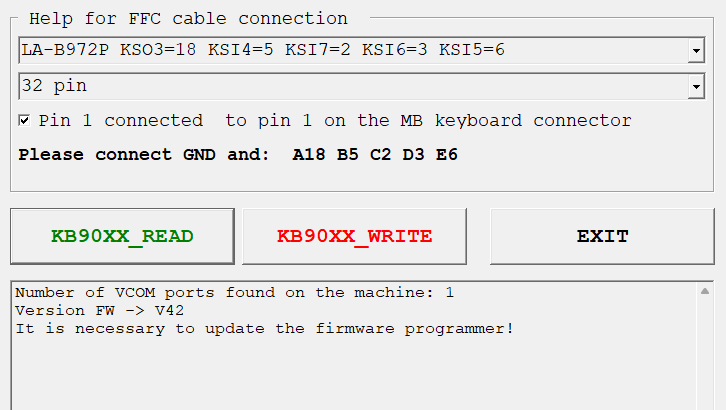

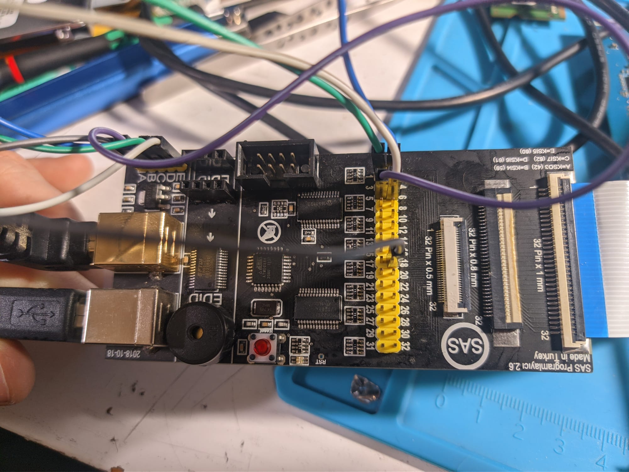

    Vertyanov Ver 4.C
    I'm trying to write a ENE KBC on a HP 15-R212NL, the problem is after I connect everything to the programmer and when I press read it says that I need to update firmware programmer and I don't know how to fix it...

    Its not a Vertyanov its a clone.Lots of members here have one, i don`t know how they go about updating the firmware because if its updated with the real vertyanov firmware it can brick it https://www.badcaps.net/forum/showthread.php?t=77094 .Contact SAS support,there might be a manual firmware update for it ?

      Thank you very much about the information, I'll contact them. Have a good day!

        Re: Vertyanov Ver 4.C
        Did you get a reply from sas?
