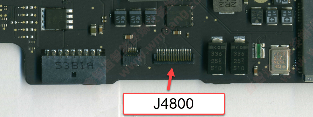

            4) Use alcohol and with Q-tip, clean up the solder connections on J4800. You may have corrosion on this area. Trackpads / keyboards are a major area of faults. You can remove the cable to J4800. It is not needed to test this logic board with fan spin and power on.

              4) I am use alcohol and the board is not wet, but I nevertheless cleaned almost everything, yes I pulled out the board and left only the cooler and the power jack.

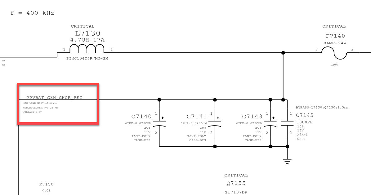

                      PPVBAT_G3H_CHGR_REG 0v
                      Can you recheck this value ? This is the voltage from PPBUS_G3H which is working on your board.
                      L3095 is @ 0V ?

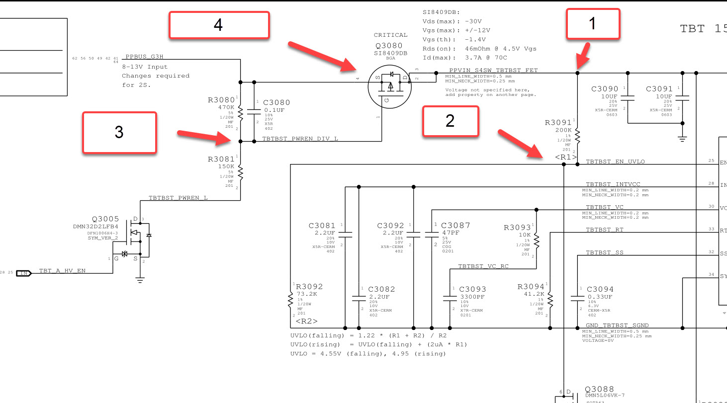

                      Check & post the voltage for the ENABLE pin 25 (TBTBST_EN_UVLO) of this IC.

                        Yes on PPBUS_G3H I have a 8.6v. You mean problem in PBus Charger IC ISL6259 ?
                        I checked on F7140 , and have 8.6v
                        On pin 25 have 0v

                          See attached. Post the voltage readings.

                            Re: A1466 M/B 820-00165-A no power
                            1) 0v
                            2) 0v
                            3) 8.2v
                            4) 8.6v
                            Thanks to everyone who helps to lift the motherboard

                              Voltage on Pin #1 - Q3005 ?
