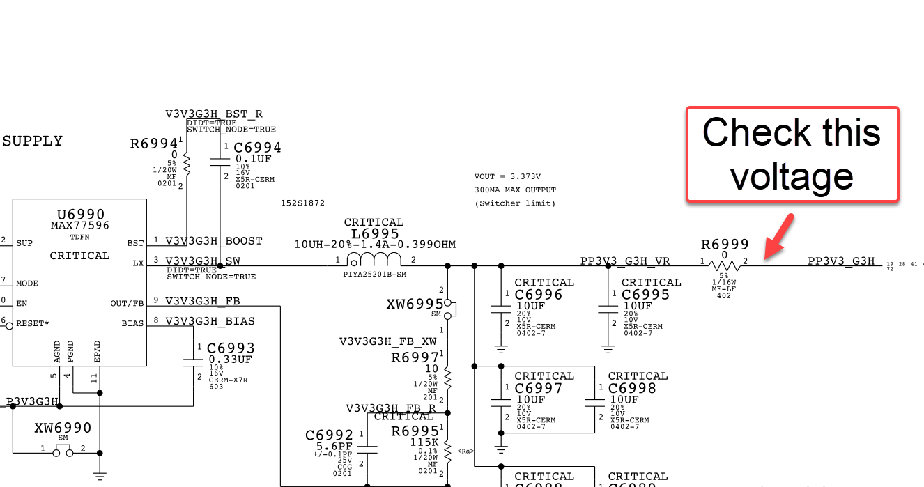

    1) Confirm that U6990, pin # 2 is 3v42 = PP3V3_G3H and this is a critical rail. It must not be 0V anywhere on the logic board.

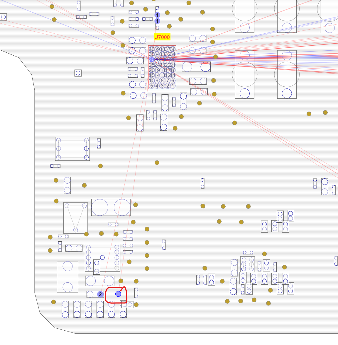

      so what ive done from https://logi.wiki/index.php/CD3215_Bootup_Sequence
      i took the table and tested all the points from it.
      step 7 states u6903 which isnt on the board so i tested a test point of PP3V3_G3H from u7000 (illitrated in the screenshot attached. )
      1) the voltage for pin 2 of u6990 is 4.84v
      2 the voltage for r6999 is 3.42v
      bare in mind this is on u3100 whereas on u3200 its 0v on both would this mean my cd3215 on u3200 gone bad and needs replacing
