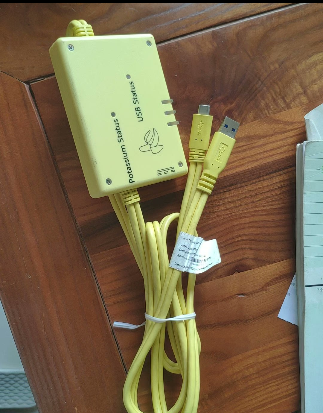

                            • kevingill
                              • Jun 2013
                              • 152
                              • England
                              #94
                              Re: Macbook M1 Unlocked!
                              Originally posted by kjchatman
                              the tethered jailbreak offered by checkm8 is complete waste of time is you're gong to resell the device
                              You would think that complete jailbreak of the MacBook via checkm8 would allow some sort of fiddling with the activation lock? I mean, you've got full control of the Mac?
                              It's also interesting to see that System Information shows Activation Lock Status as Disabled. However, a hard power off will still ask for original owner Apple account details.

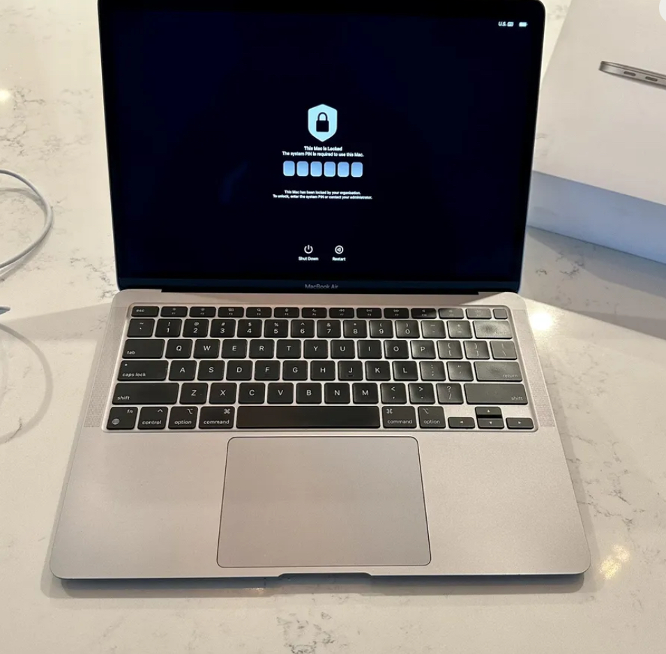

                                        • Pedro147
                                          • Sep 2016
                                          • 148
                                          #100
                                          I bought this 820-02016 A2337 on eBay yesterday knowing that it had some lock that looks like the old EFI lock of earlier models. sickw(dot com) shows board as iCloud and MDM unlocked, so what is this lock shown in this device please. I am assuming that without the appropriate PIN code I will never unlock it? Thanks, I hate all this locking cr*p like we all do. Sorry for imgur photo link, I can never work out how to upload images here https://******/sMUzq9J.jpg
