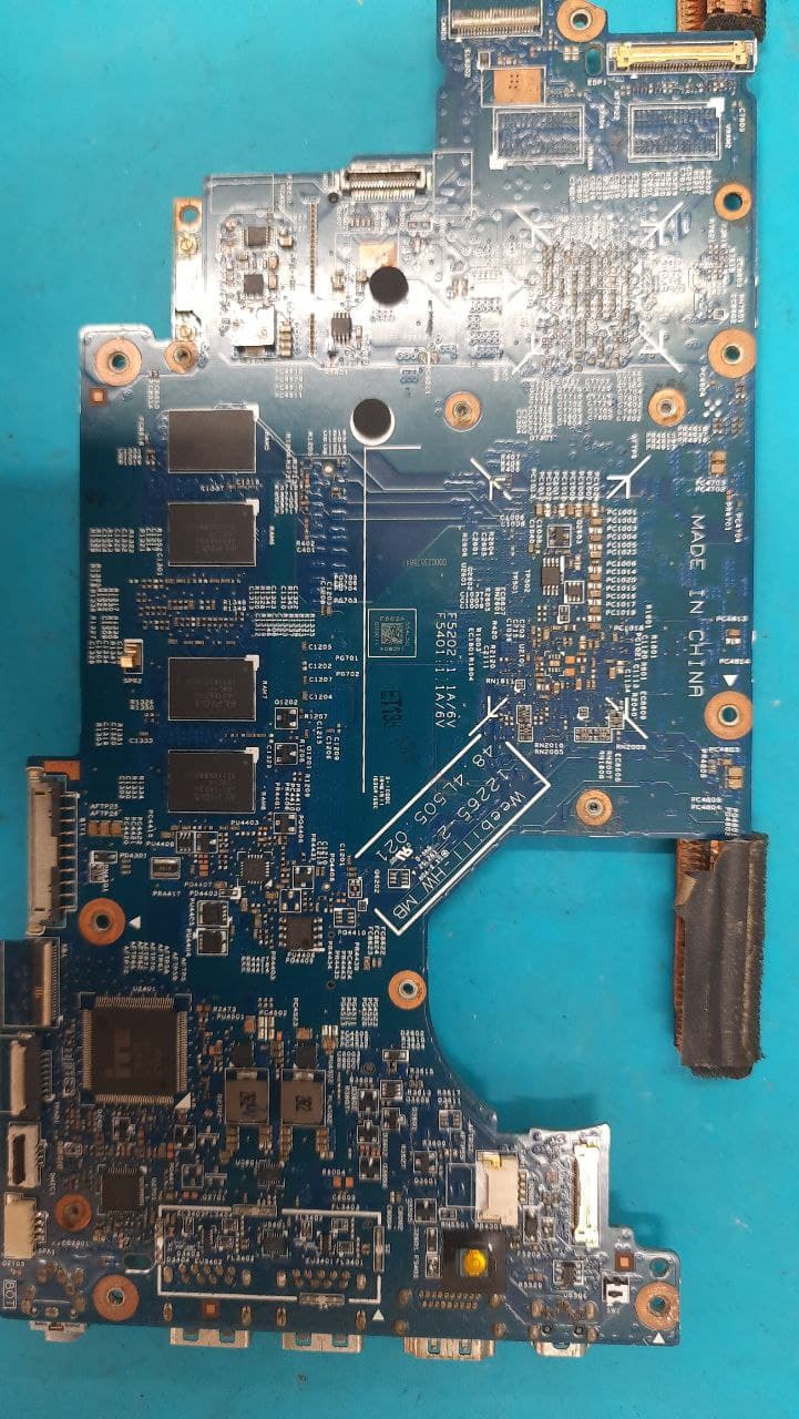

Acer Aspire S3 MS2385 Dead
  • Anirudhvl
    • Feb 2018
    • 25
    • India
    Acer Aspire S3 MS2385 MB Part No. - Weebill - HW MB 12265-2 is not responding to power button. Taking 2mA, getting 3.3v, 5v LDO and 1.8v at IT8587E 12 pin. After pressing pwr btn it goes to 3mA, and 3.3v and 5v output at coils, can seen near the IO(Look at the MB image).
  • mcplslg123
    • Jun 2015
    • 7262
    • india
    Re: Acer Aspire S3 MS2385 Dead
    Check RTC circuit.
