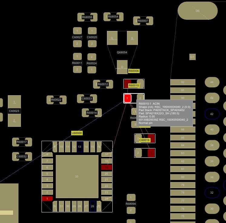

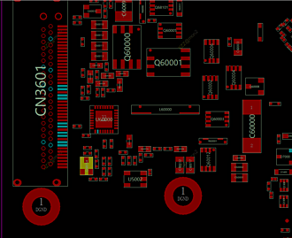

    HP ELITEBOOK 850 G5 ISL9538h area resistor value
    wish you have a safe and good day.

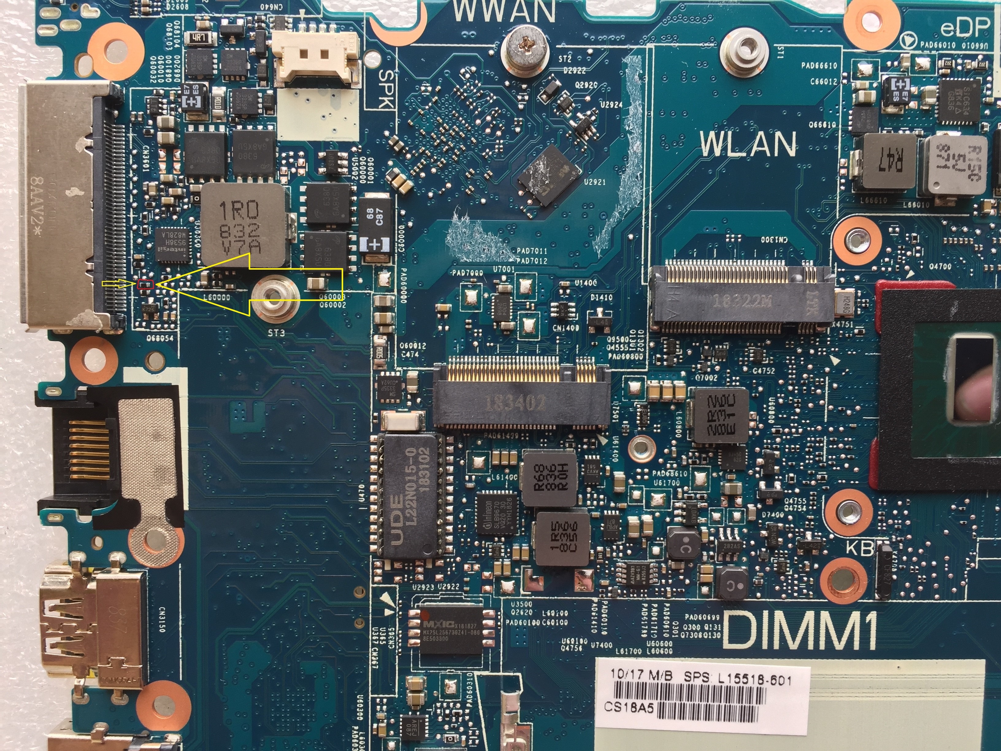

    I recently recevied this HP 850-G5 laptop with blow/bad isl9538H.
    Ordered the new ic replaced it still no standby 3.3v or 5v with only 20v@0.0017A drawing. Digging hard for ISL9538h datasheet and realized the CSIP&CSIN current sense line has 2 resistors value goes off. By any chance anyone know what value of this 2 resistor in the CSIP&CSIN lines are.(RED circle)

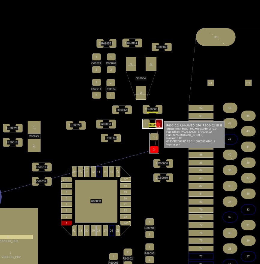

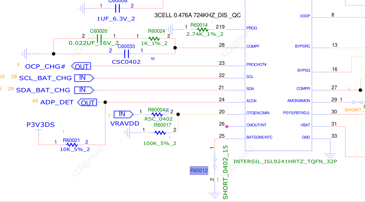

    Re: HP ELITEBOOK 850 G5 ISL9538h area resistor value
    reference from DELL laptop isl9538h datasheet. It seems to be low resistance or 0 0hm from my guess.

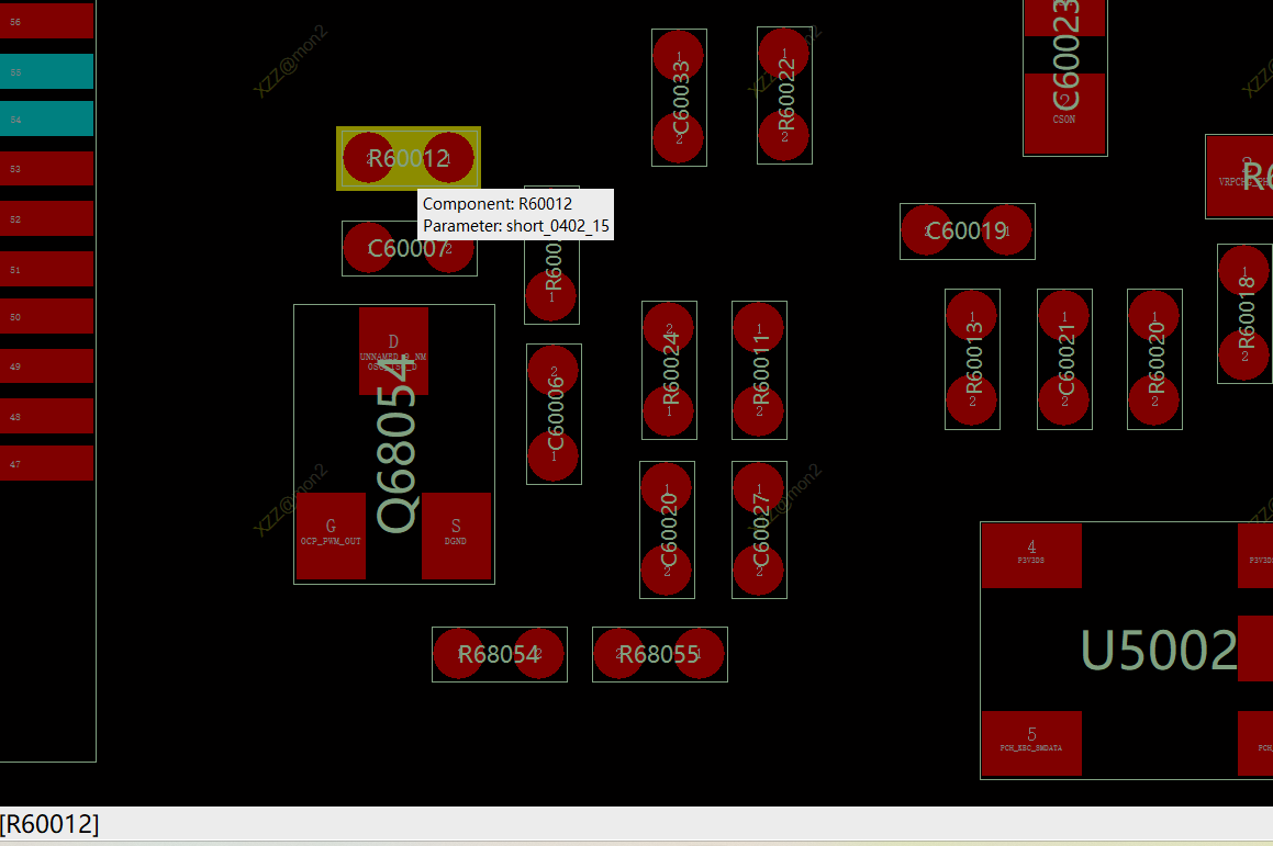

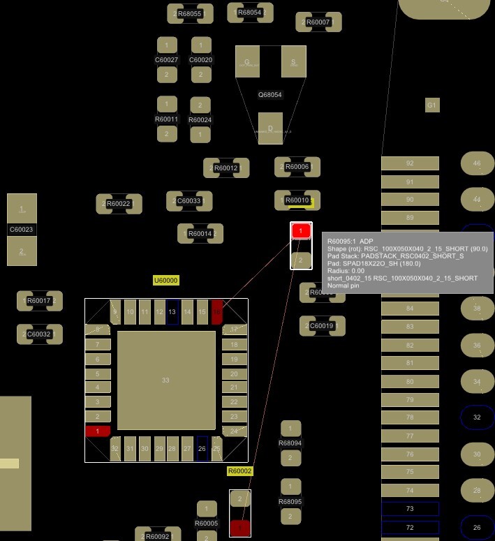

      measured in main
      Left 50 ohm
      Right 25 ohm
      • mcplslg123
        • Jun 2015
        • 7262
        • india
        I beleive anything around 10-30 ohms will do. value for both resistors should be same.

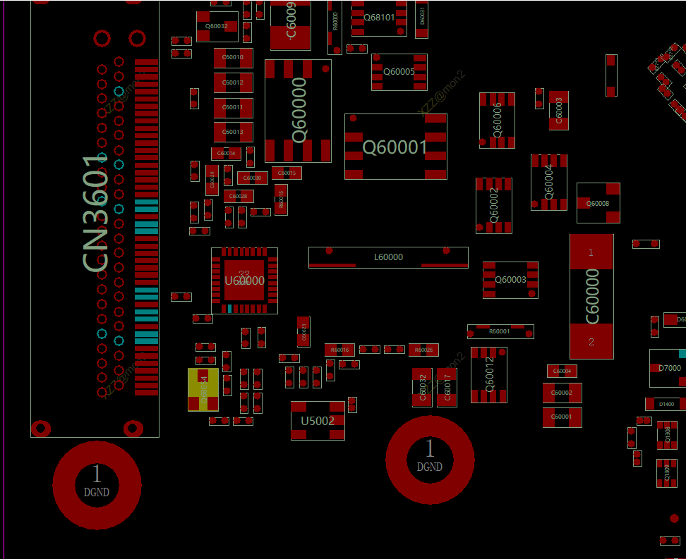

          ISL9538h ic 19 pin (ACIN) single voltage divider resistor value plz
          • mon2
            • Dec 2019
            • 14542
            See above schematic, prb05 and prb07 build a voltage divider for the acin pin.
