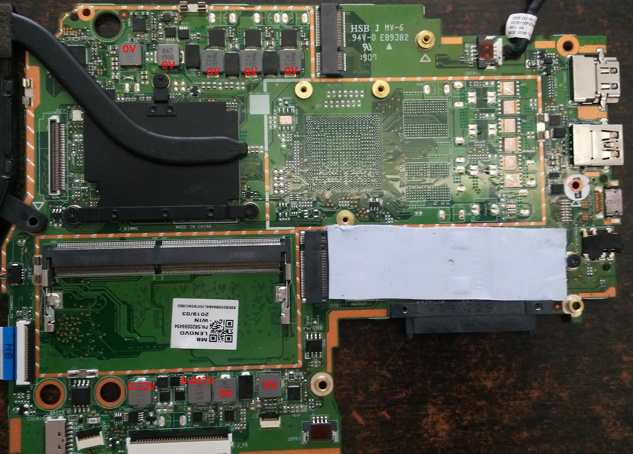

      2)
      Here are the measurements (same order as in screenshot/boardview, from left to right, top to bottom)
      L6300: 0V 35.1 Ω
      L6703: 0V 12.8 Ω
      L6701: 0V 4.7 Ω
      L6704: 0V 4.7 Ω
      L6702: 0V 6.7 Ω
      L5901: out of scale (showing 1. on 20MΩ scale)
      L6001: 0.017V 20.3 Ω
      L6002: 0V 7.92 kΩ and raising up
      L6100: 0V 120 Ω
      Using a manual range DMM.
      3) no new liquid damaged reported or observed. Will try to reflow U6001 on monday.

        Re: Lenovo Ideapad 330S-14IKB Not Powering On
        Coil readings look ok. Low voltage rails will have low resistance values.
        Power down and check the resistance of each mosfet starting with Q5901 & Q5902. Often one of these bad boys get nuked to halt the party.
        ACOK = logic LOW = power good indicator. However, this open-drain pin will only present a HIGH if the +V3.3AL (+V3P3A_EC) is working which it is not...
          @mon2, coil readings dont look good to me. L6001 is for +5V rail and resistance is 20.3 Ohms. Clearly shorted. Seems like you missed it.

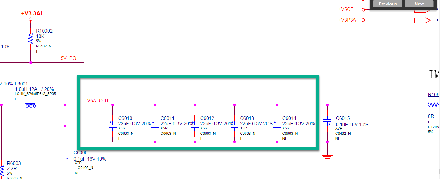

              • mon2
                • Dec 2019
                • 14719
                14 Ω on the side of the +V5 power supply. (so short on this side)
                Yes indeed.
                See attached. Lift up one side of L6001. Then check the resistance again -> still 14 ohms ?
                If yes, then it is down to the highlighted caps in the box.
                Consider to remove each of the caps from the logic board and test the resistance again.
                If you wish, you can certainly remove one cap at a time -> check the resistance -> repeat if required.
                Suspecting it is one of the 22uf caps but you can also remove the 0.1uf.
                Edit: C6014 & C6015 = NI = Not installed (?) so the cap check list is even shorter...
                      Same after lifting up one side of L6001 and after removing the caps. That leaves pin 10 (VOUT) on U6001 so the 5V power supply seems bad, at least, and needs to be replaced.
                      • mon2
                        • Dec 2019
                        • 14719
                        Yes, if the external caps have been ruled out then through process of elimination, U6001 needs to be replaced.
                        If there is any doubt, consider to flux & reflow u6001 to make it 'dance' for good solder joints. Check the resistance again but sounds like this regulator is damaged. Best to order some spares in case this issue repeats.
