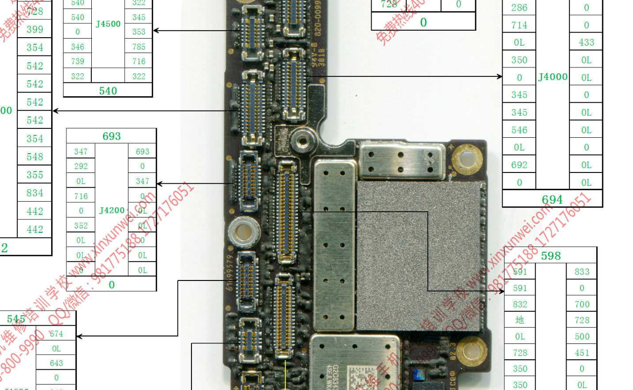

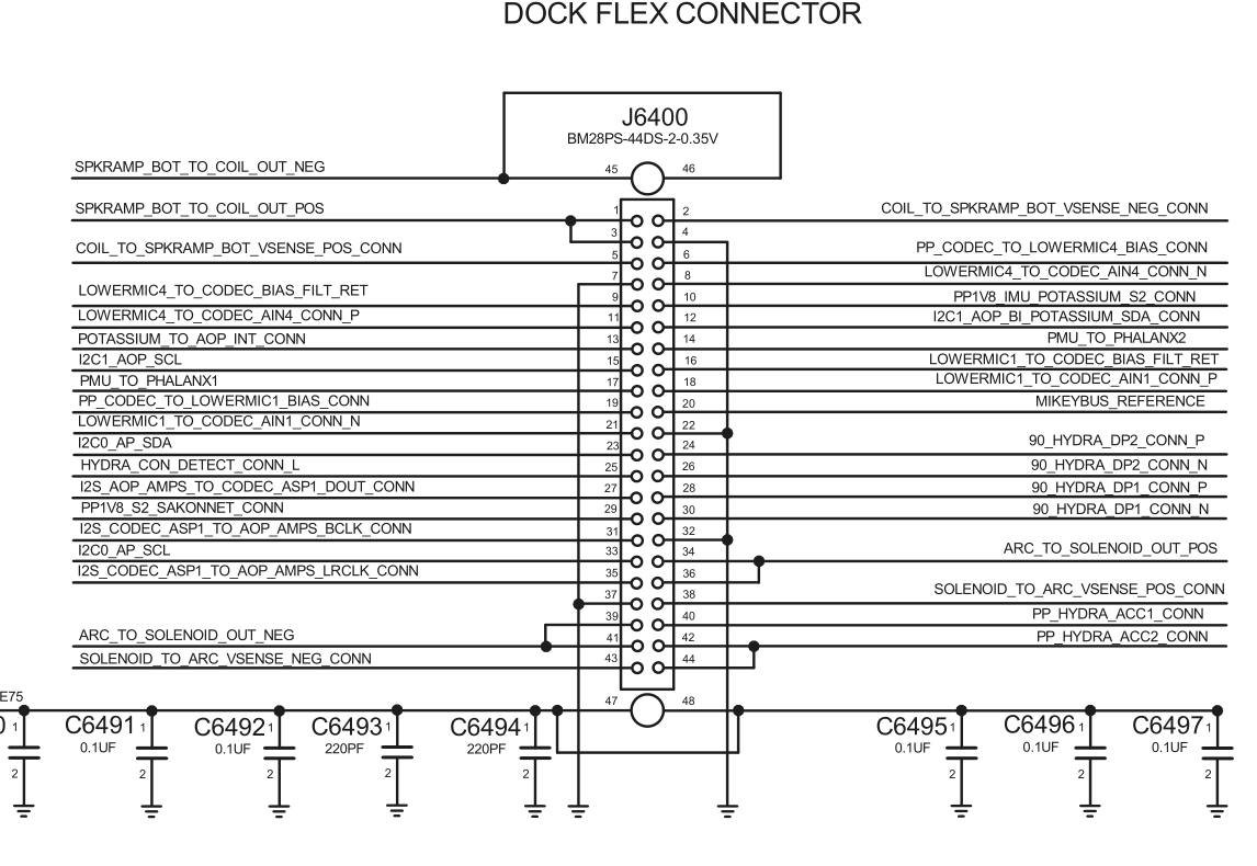

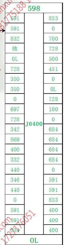

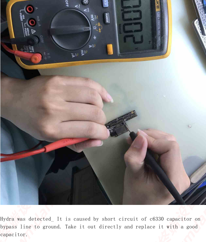

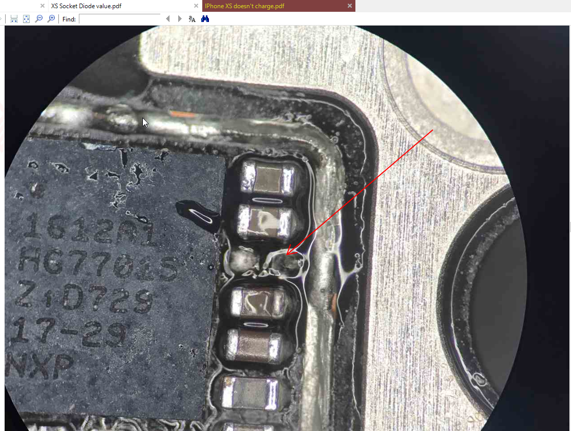

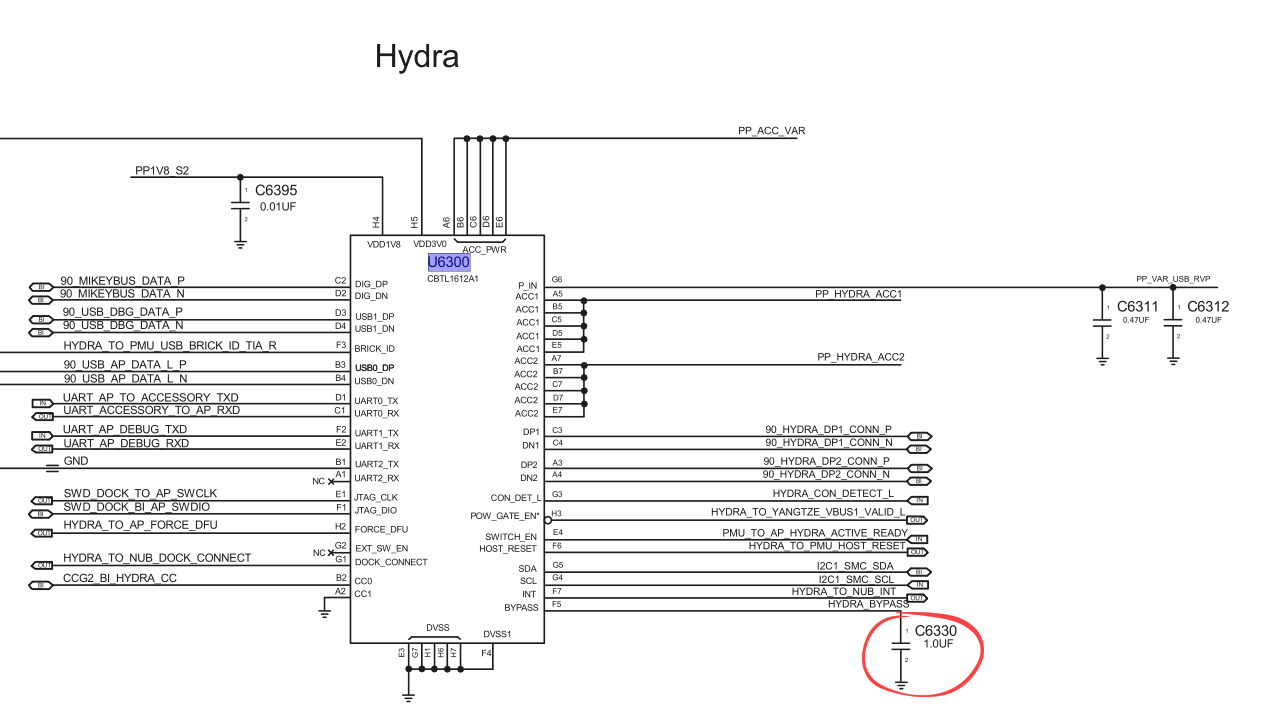

        Sharing a case of bad cap causing this issue.
          • 21968
