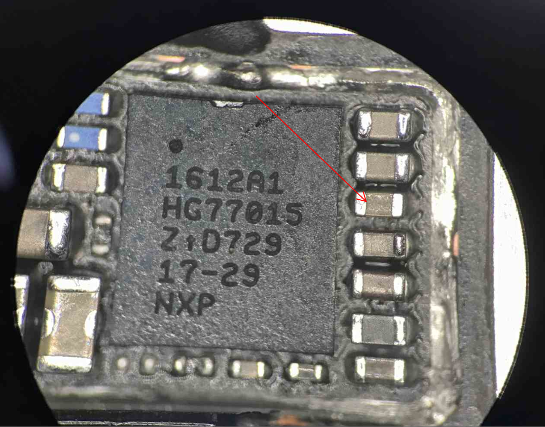

        Attached is a repair case where the tech found that a capacitor nearby the tristar chip was shorting and causing a similar issue. So in this case, the capacitor only was replaced. This tech had the phone with the CHARGING ICON so maybe not the same issue as yours.
        If you see no USB activity during attachment to iTUNES then I suspect the tristar chip as the fault.
        So this is the 'hydra' chip. This is the charging chip according to the websites.
        See here:
        https://logi.wiki/index.php/iPhone/i..._Compatibility
        The p/n is 1612A1 on the XS model and is fairly easy to source from Aliexpress or similar.

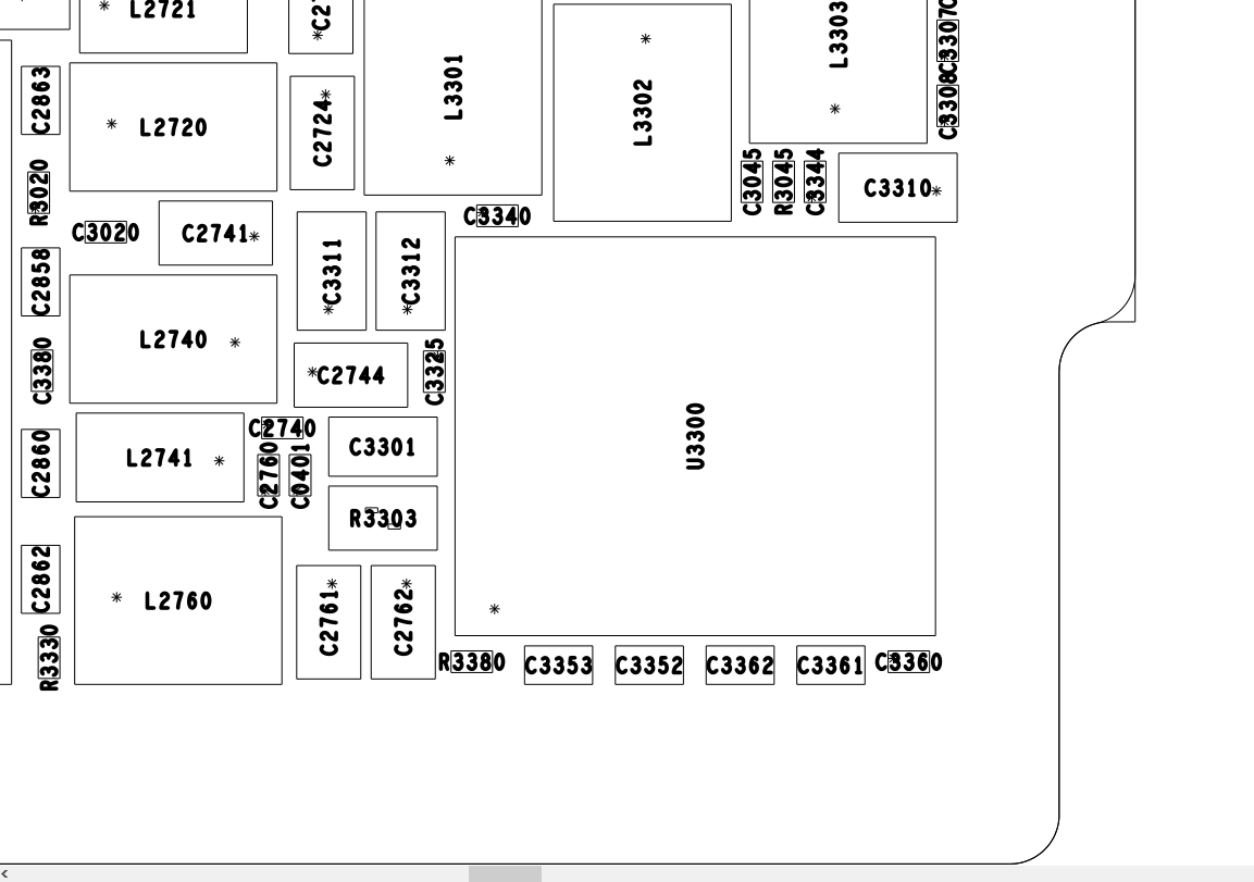

                    There is a dedicated charging IC @ U3300 on the XS model that is usually replaced for similar cases. The IC is about $2 USD in China but again, you need a special heating plate to desolder the many joints in this stacked up design.

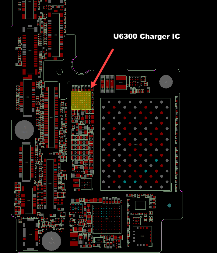

                    a) USB not detecting is related to U6300 = Hydra (aka tristar) MUX IC
                    b) not charging is U3300
                    These are only suggestions from assorted readings so please proceed with caution.
                    In the meantime, try the following:

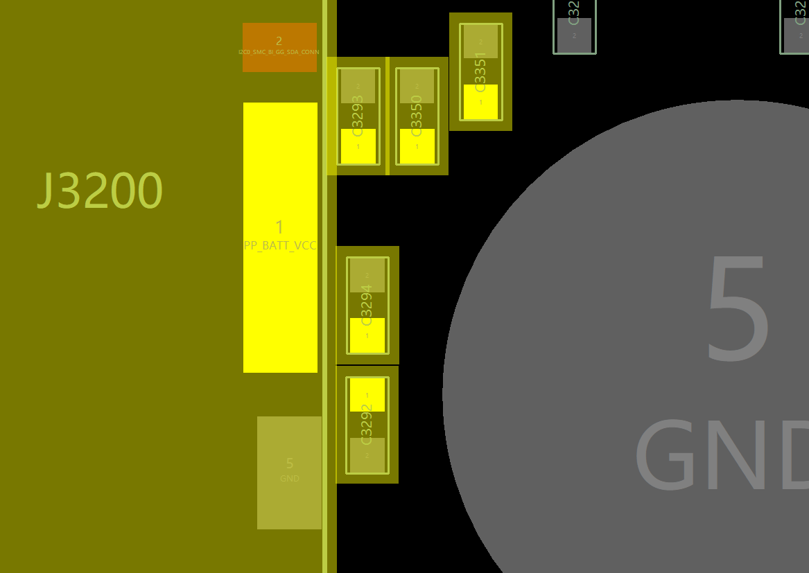

                    1) remove the battery from your phone
                    2) place your meter in resistance mode (ohms)

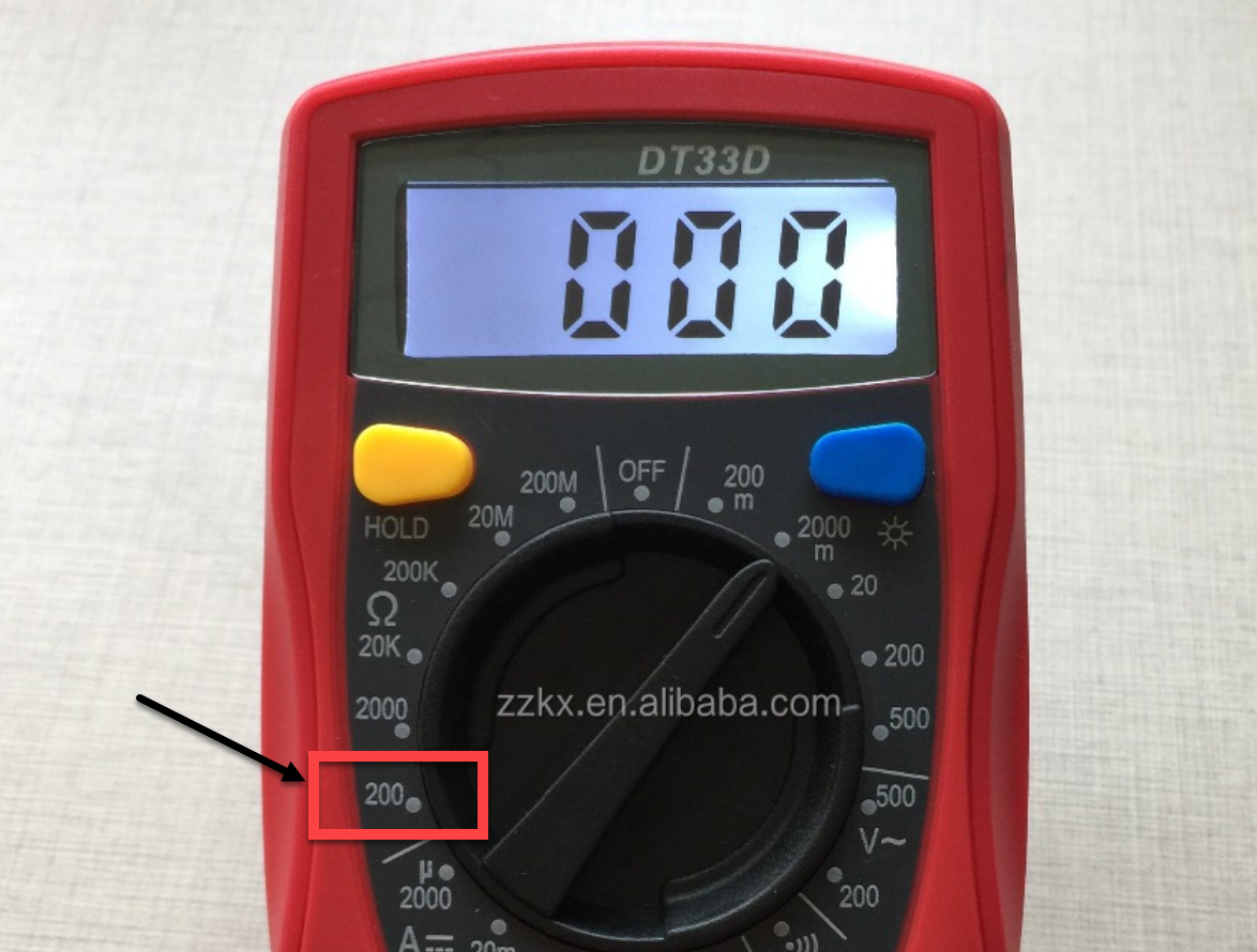

                    3) then black lead to ground (see my last diagram below). red meter lead to the pin # 1 of the battery connector J3200 (PP_BATT_VCC).
                    What is the resistance reading in ohms ? Checking for a low resistance reading on this rail for a possible short to ground of a local capacitor.

                        I tried testing the resistance, however, no value is appearing on my multimeter. The ground on the battery connector is fine but pin 1 is not giving me a value

                          On the resistance checking, use the lowest setting on your meter. Let us assume it is 200 ohms as an example. Then check the resistance.
                          Does your meter report any reading that is under this setting of 200 ohms ?
                          If yes, what is the value ?
                          If it is higher than this max setting then you are likely ok on the capacitance checking for shorts. This test is to confirm if you are facing a short circuit to ground due to a faulty capacitor on the logic board and on this voltage rail.

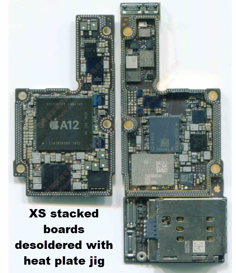

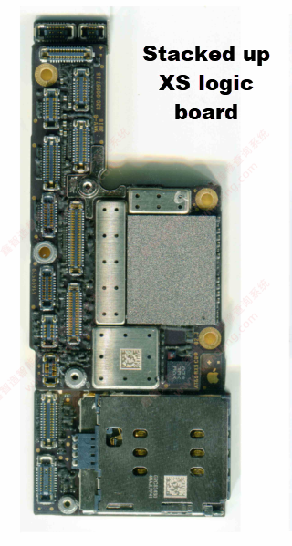

                          The next very serious issue is that you have a dual stacked board - the jig is not cheap to separate the 2 logic boards. Aliexpress has these as well and they are hot plates made in the exact shape of the XS logic board. You apply power and the boards will heat up at the designed locations to allow you to separate the 2 logic boards. After this separation, you can access the tristar (HYDRA) chip for replacement. Then reverse the procedure to test again.
                          I think the pricing for the jig is coming down so you can shop around.
                          Review this video which offers the process that you may be facing:
                          https://www.youtube.com/watch?v=y0U1sKoVmUE&t=2346s
                          Perhaps even consider to send to Ben - I believe he is in Germany. Not sure of pricing. This way, he can diagnose and return to you with a fully working phone. It will be worthwhile to consult with others but logically believe that you have at least an issue with the Hydra chip and perhaps also with the charger IC. Both are about $2-$5 USD each but the tools and labor are the real expenses. It really sucks that the IOS update caused this sequence of failures. Again, concerned about the complexity and how deep you wish to explore this repair. There are risks involved but also rewarding if you get this working.
                          Here is a vendor that is selling the motherboard jig to desolder & solder back the stacked logic boards (similar to what Ben is using in his video) @ about $50 USD with shipping

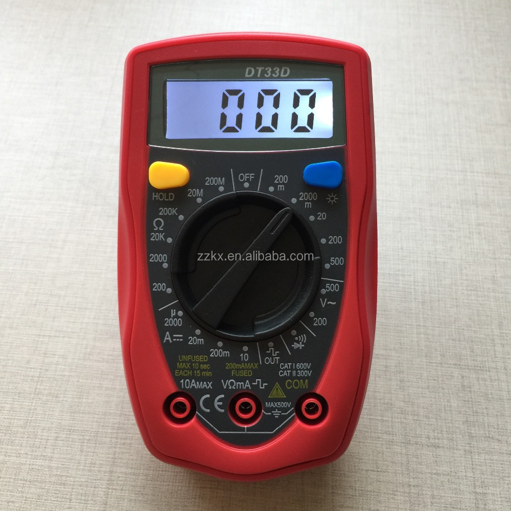

                            Okay so I tried the resistance again with my multimeter (attached a picture below) and set the value to 200 ohms.
                            The reading is: 126 Ohms

                              Can you confirm that you used the ohms settings as per attached pic ?
                              126 ohms is ok. It is not a short to ground.
