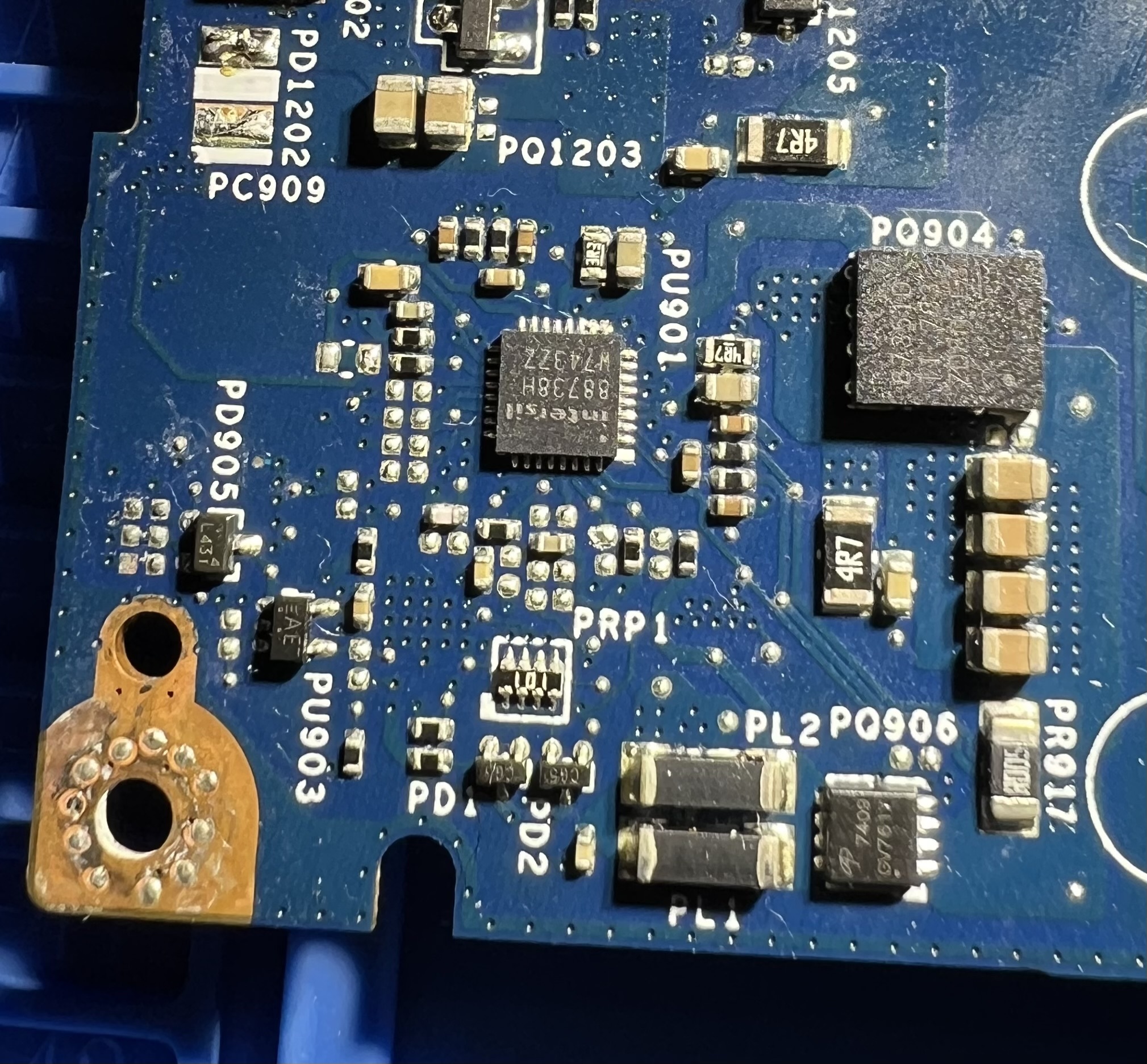

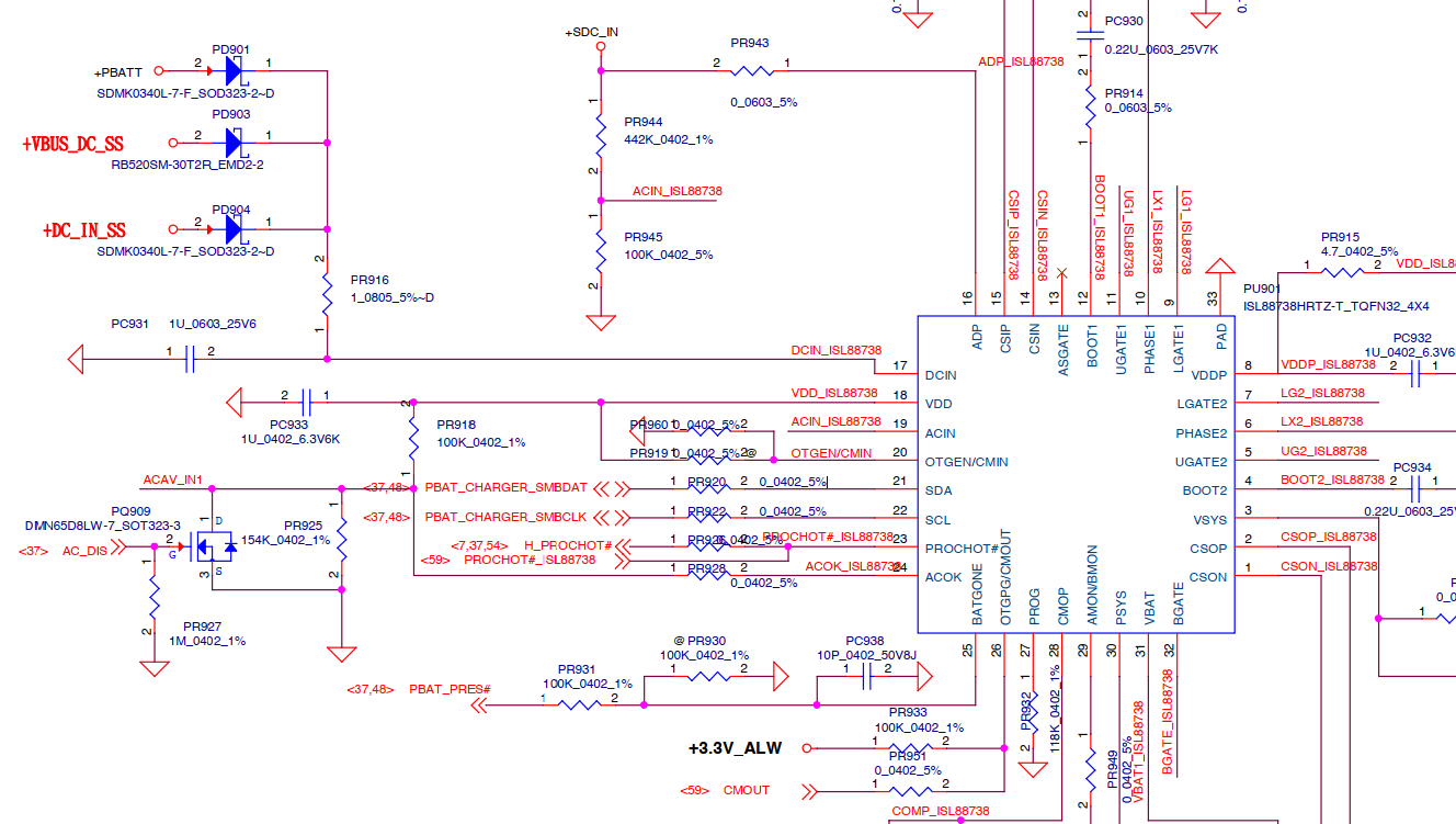

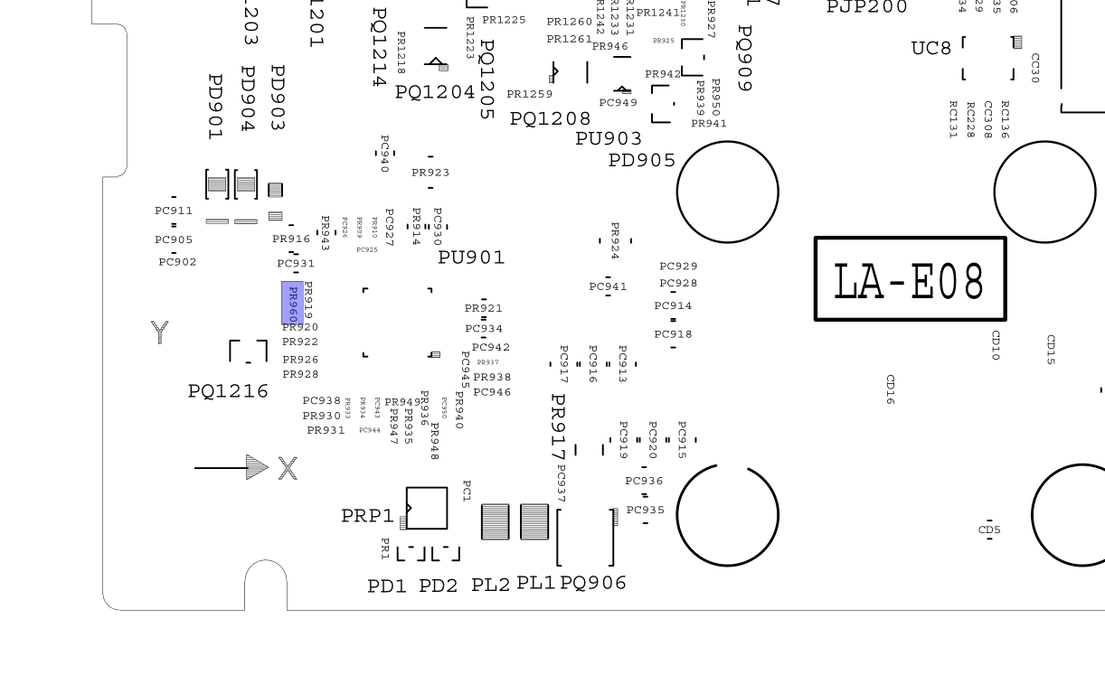

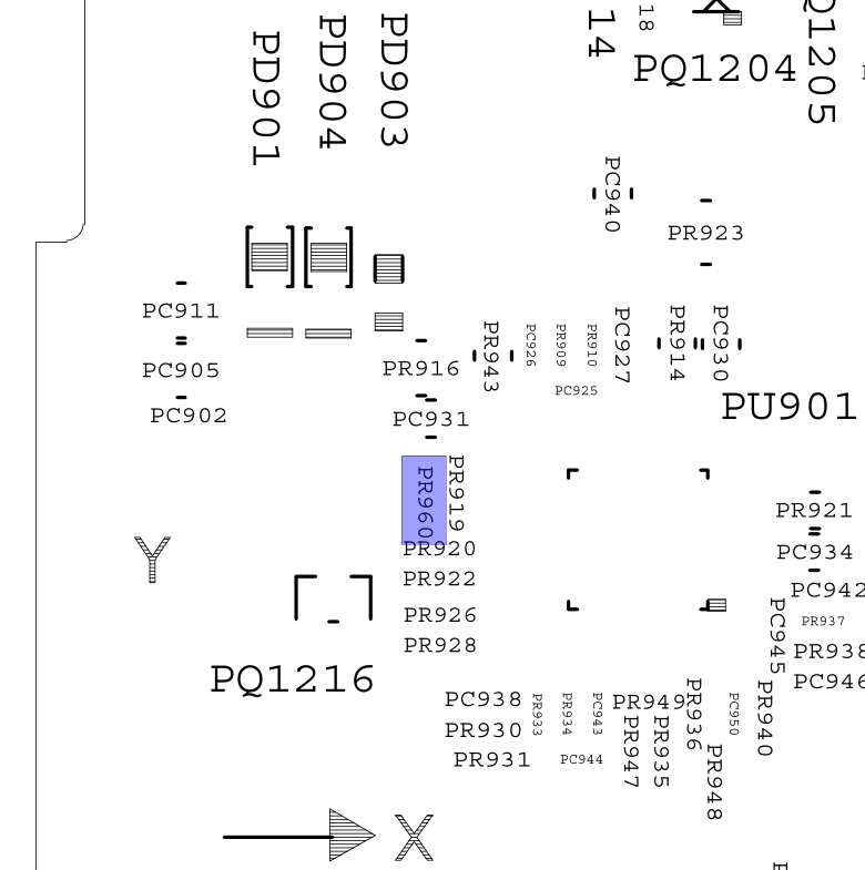

        Looking at all the pins on PU901 (ISL88738), I can see that PIN 20 (OTGEN/CMIN) is shorted to ground. PIN 18 is NOT shorted. Which makes me think (being a novice) would it not be best / less intrusive to first take off PR960, as it is either this resistor or PU901 which is shorted?
        Trouble is that I have no idea where PR960 is on the board... anyone with a boardview who can help?
        Alternatively, i am sure others may just say go straight for the charger IC and replace PU901?

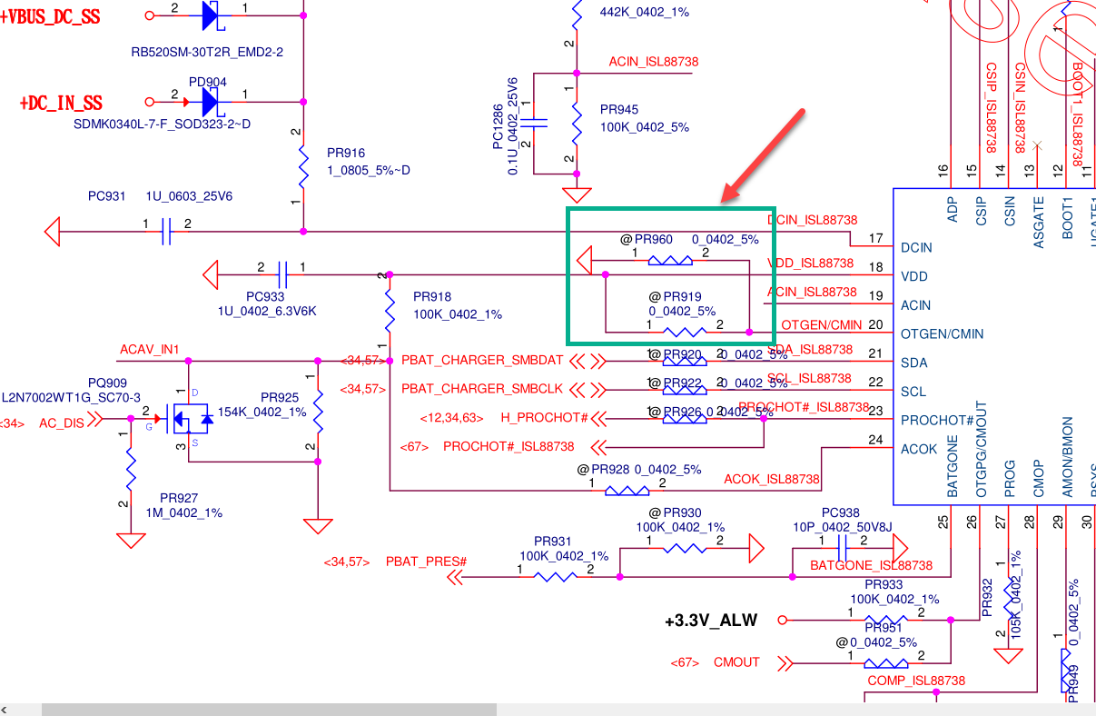

          Re: Dell Latitude 5480 - No 3v & 5v
          see attached.
          Also from my understanding, either PR960 OR PR919 will be stuffed.
          PR960 (0 ohm, 0402) shunts this logic line to ground.
          PR919 (0 ohm, 0402) shunts this logic line to Vdd (+V).
          So both of these parts should not be stuffed on your PCBA. Please confirm.

          • elfelvin
            • Jun 2021
            • 15
            • England

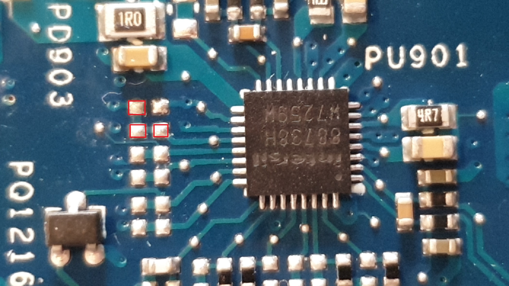

            I dont have any physical resistors in these locations, all I have are tracks.
            I have highlighted the "test points" which are grounded.
            This surely means that PU901 is at fault, as there is no PR960 / PR919?

              It can be rezerve for different use. How many volts do you see on the PR901 resistor? Is there AC_OK 3.3v on the 3 pins of the pu901 IC? In order to output ALW voltage in Pu100, there should be 3.3V at 12 pins (from IO)

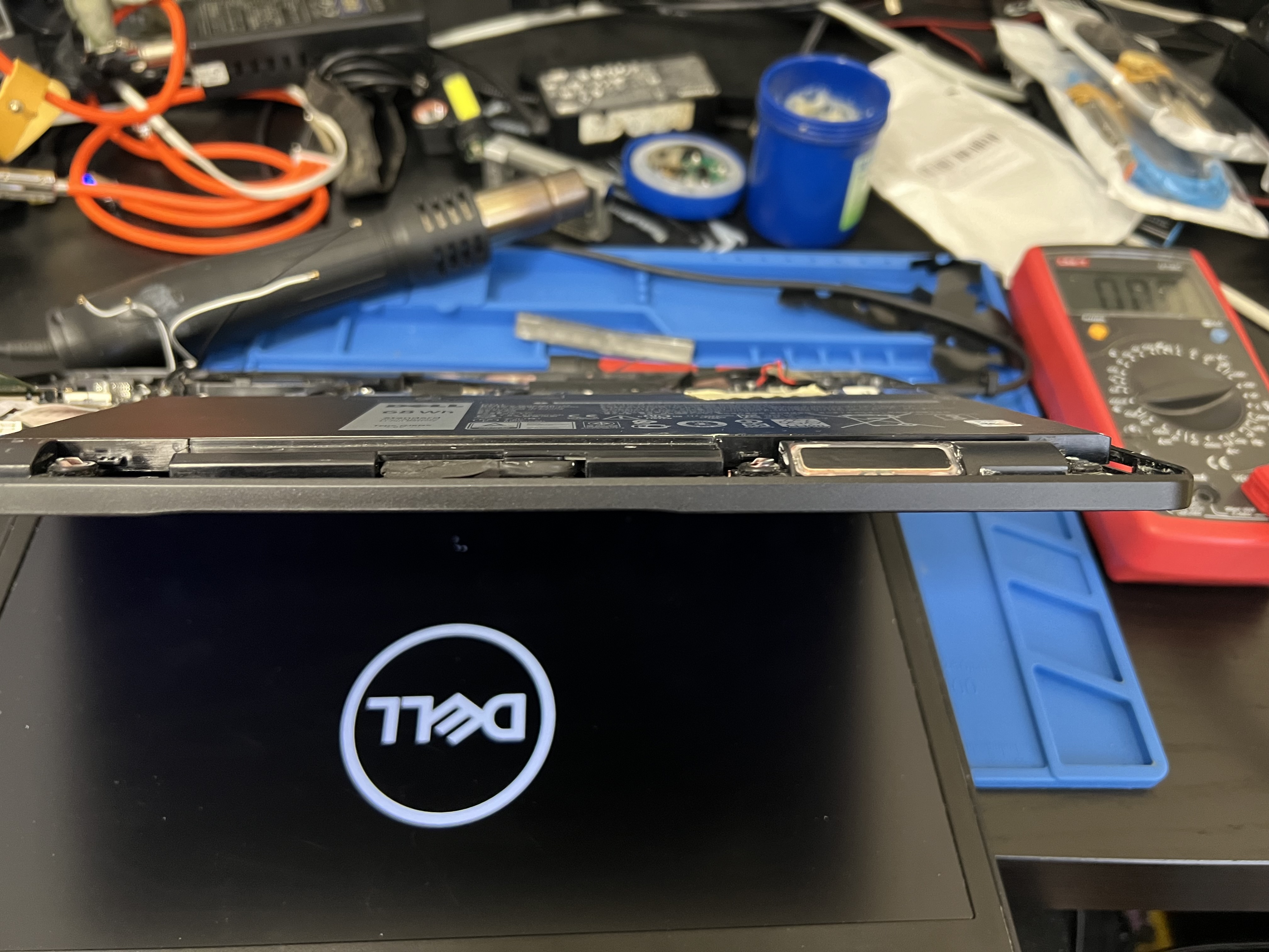

                      I believe the issue is with PR102.
                      When i measure continuity between pin 2 on PR102 and PWR_SRC, I get nothing. There seems to be a dry joint between pin2 and the board. I will confirm the outcome once this has been fixed.
                      • elfelvin
                        • Jun 2021
                        • 15
                        • England
                        I replaced PR102 with a 499K and now both 3v and 5v rails are working. The laptop powers on and peace has been restored in the world.
                        Thank you to all that commented, hopefully the diag helps someone in the future!

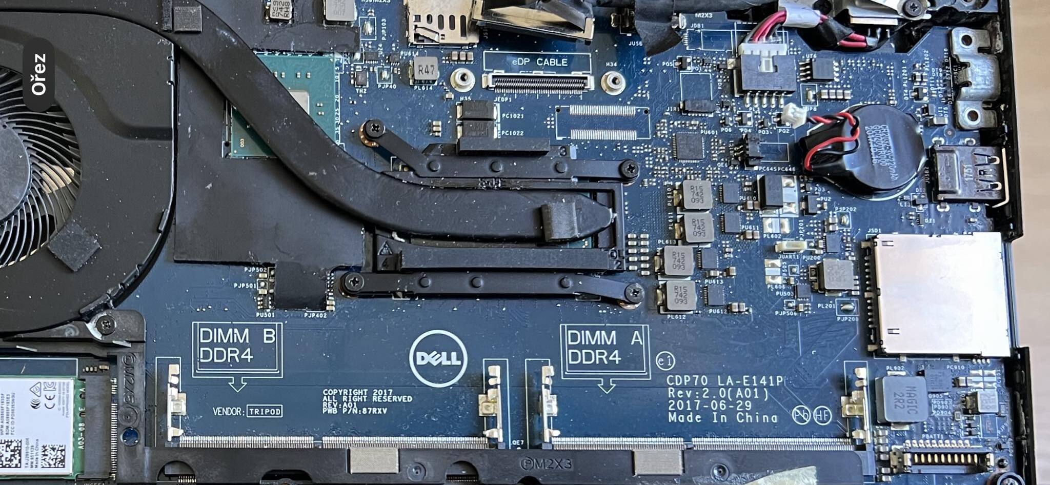

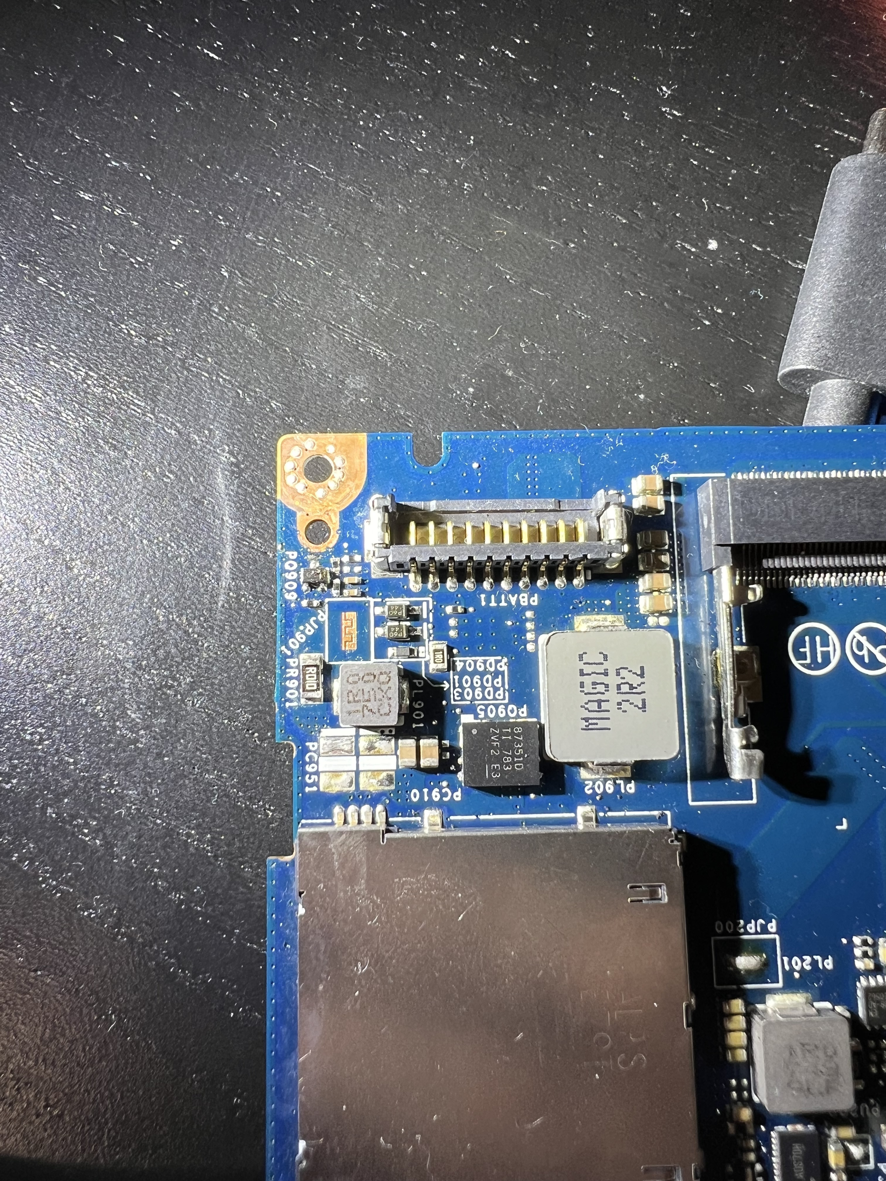

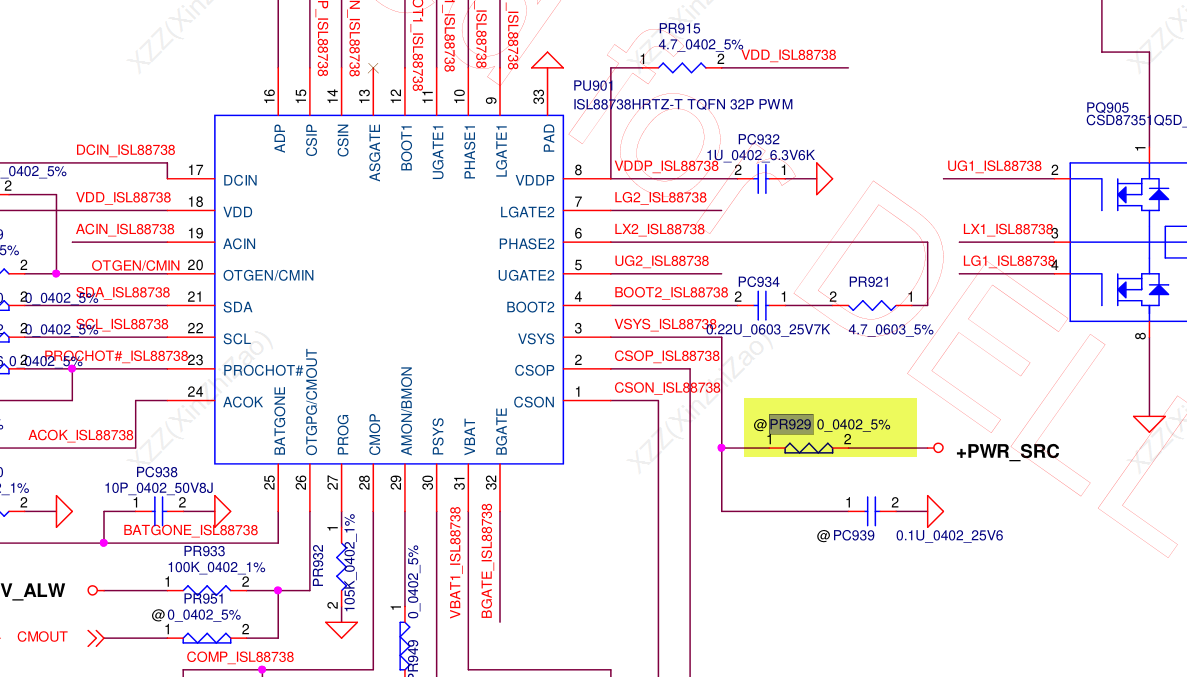

                            I have similar problem, laptop was water damaged.
                            After cleaning it woks from battery/not charging, but only until battery died.
                            I replaced some rotten resistors, now its recognized by USB-C charger, but it's stils dead.
                            I got 3,3V, but not 5V ALW.
                            On PU901 PIN3 i got 0V. I can't find PR929 on that board.
                            What can cause such problem?
                            What program you use for opening .cad BDV files?
                            Thanks.

                              Honziq - which model of laptop? Which silk screen markings are on your board?
                              Found it. PR929 has an '@' symbol = do not stuff on the PCB. So this part is missing by design.
                              Locate PU901 on your logic board -> locate pin # 3 -> share pics of this area. With PR929 missing on the board, this implies that there should be a solder blob to feed +PWR_SRC onto pin # 3 but confirm it. That is, there should be a pcb 'jumper trace' to bridge the adapter voltage onto pin # 3 of this charger IC.
                              Click image for larger version  Name:	PR929.png Views:	0 Size:	213.6 KB ID:	3255092

                              • Honziq
                                • May 2014
                                • 58
                                • Kazaksa
                                Markings are CDP70 la-e141p.
                                I don't have quality photo, but i will send it as soon as possible.
                                Pin 3 goes immediately to another layer of PCB.

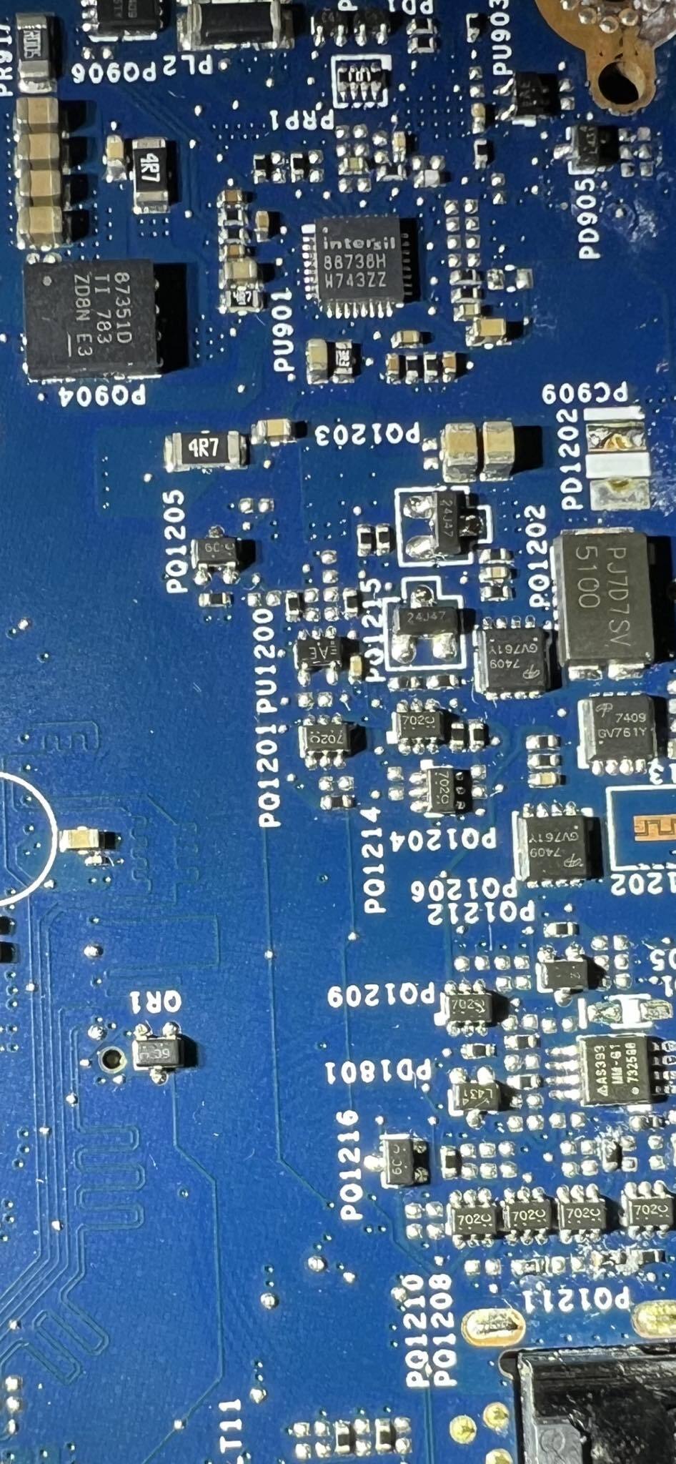

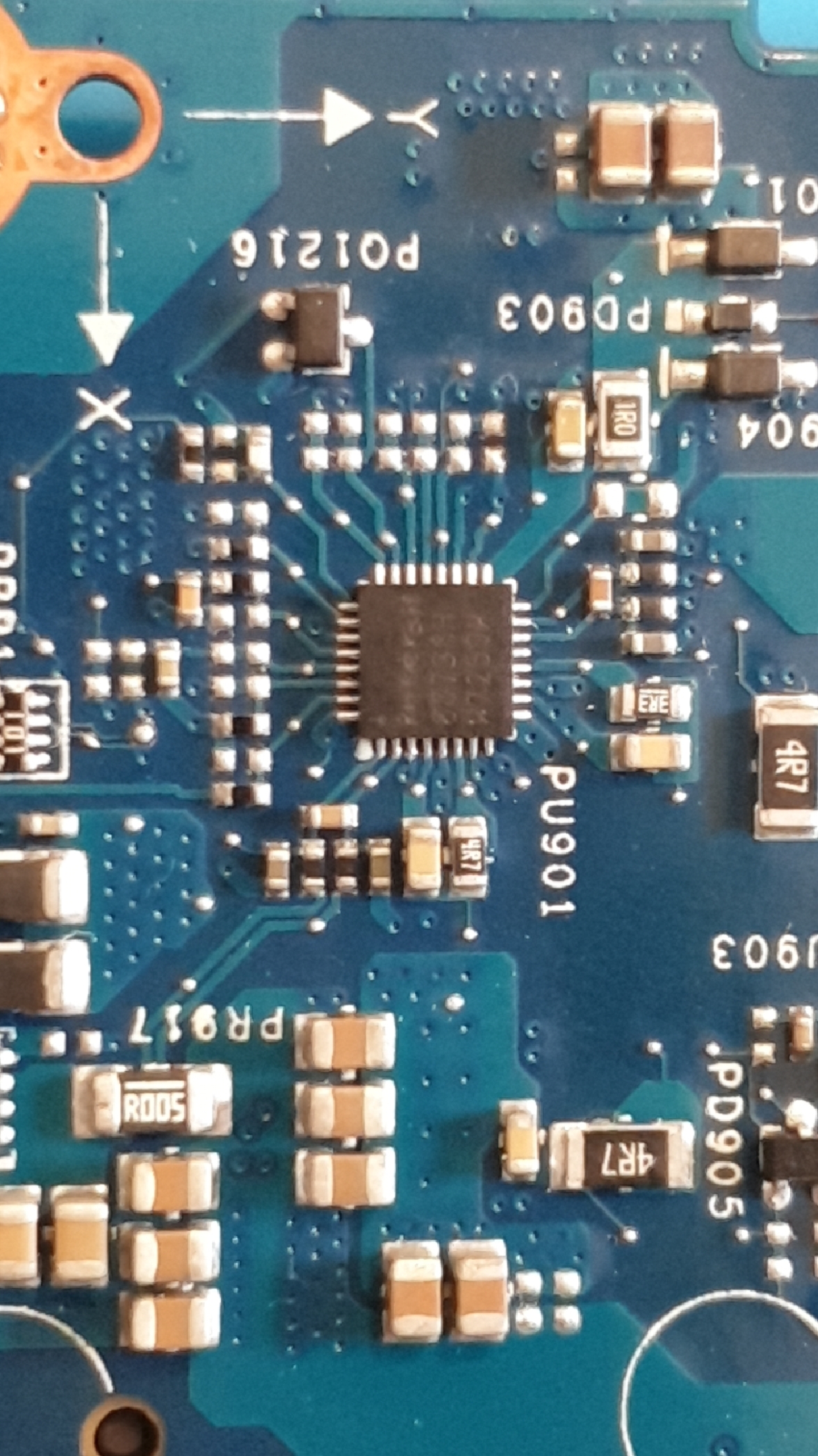

                                • mon2
                                  • Dec 2019
                                  • 14094

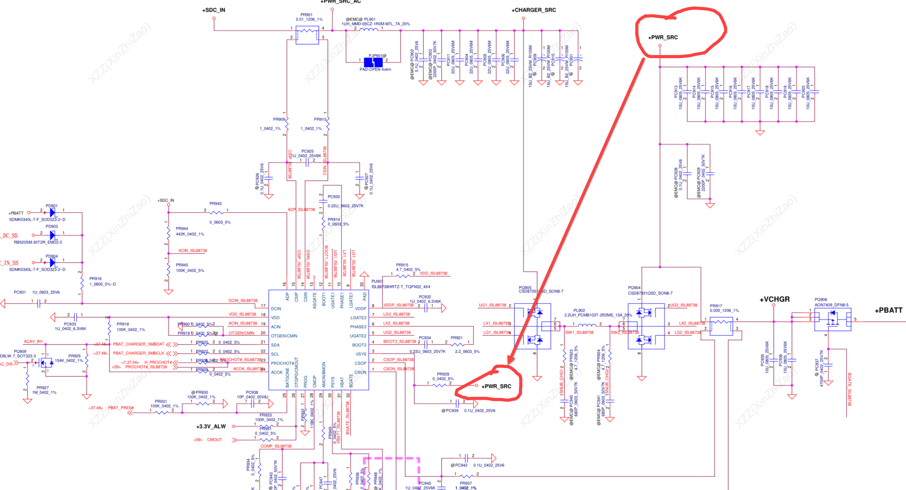

                                  See attached. The case is similar to the OP. This rail is at the end of the main power path from the external power adapter. If it is not enabling, you must review the voltage from the source to this area. Need to check each mosfet in the path. Since the battery was able to power the board, we know the main power rail is not shorted and the fault is between the DCin power connector and this target +PWR_SRC junction.
                                  Start with reviewing the voltage to ground of
                                  PQ905, pin #1 ; this must be the raw voltage from the power adapter
                                  PL902 ; either side of the inductor
                                  PQ904 ; pin #1 = +PWR_SRC
                                  There are 2 mosfets inside of PQ904. Each is a suspect. Remove all power. Meter in resistance mode.
                                  Measure the resistance across:
                                  source / drain
                                  source / gate
                                  gate / drain
                                  for each of the 2 mosfets inside this package. Checking for a low resistance which means this mosfet is defective.
                                  • Honziq
                                    • May 2014
                                    • 58
                                    • Kazaksa
                                    Thank You very much.
                                    That mosfets I tested before, they are OK.
                                    But I measure that voltages and on pin 1 of PQ 905 was 19V and behind PQ905 and on PL902 was 0V.
                                    So I desoldered it and solder it back and now board is booting.
                                    But PL902 making some weird loud whistling noises on boot. After some time it stops. And its only 9V on it.
                                    So it looks like a problem of some capacotors around.
                                    Or do you have suggestion why it making that loud noises?
                                    Thanks.
