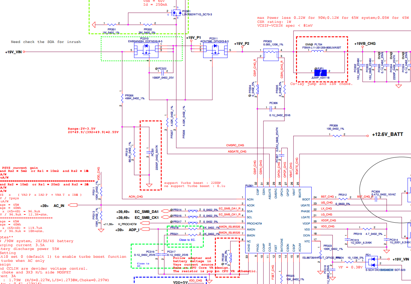

    Hello, I found a bad cap and removed it, the 19v rail is now not shorted to ground anymore. This short killed the first mosfet each time I replaced it. And not anymore. So I was thinking the laptop was fixed. But no. I pluged the charger and the first 2 mosfet seems ok, but blocked. And shunt resistor is shorted at its two pins (not to ground).
    I supect now a bad solder on one component (my fault) or another component dead following first badcap ? I dont know.

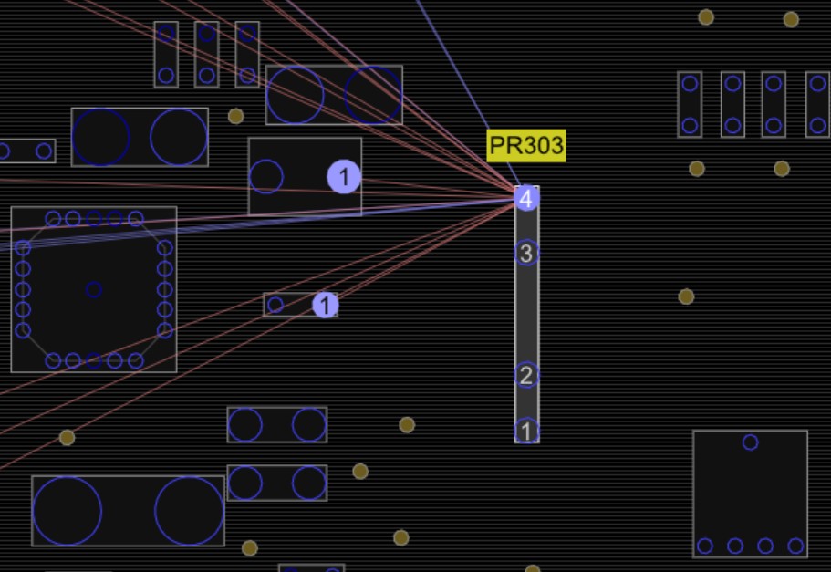

    For diagnose, I'm blocked on the boardview, I dont understand why shunt resistor have 4 differents pins ? This resistor on board has only two pins obviously, but the boardview show 4 pins not linked 2 by 2. It show 4 pins. The schematic show two pins… and two other linked in dotted lines. I dont understand ?
    Could you explain pls ?

    The 4 legs are to alert you that this is a shunt / current sense resistor. Replace it if needed with the same number of pads and resistance as the original. It is required to properly gauge the current through this power rail. The resistance should be the same as the original.

      Ok, thanks, I guess I understood the principle of shunt (for measuring current), that's why I expected to find continuity on the boardview, between pins 3 - 4 and between 1-2. But on the boardview the four go in four directions, without any link between us. Dotted lines on a schematic ok, but on a boardview… made for testing continuity, it's very troubling. True or false ? (I suspected something hided in multilayer).
      So, I consider on the boardview : 1-2 same pad and 3-4 same pad too.
      I guess this shunt resistor is OK because it's should be strong. But maybe I'm wrong ? Have you already saw shunt resistor dead ? I guess a mosfet will blow up before ?

        Rare for such resistors to be damaged. For now, do not worry about this part. Still required to be on the logic board so the local switching regulator can monitor the current being consumed by this voltage rail via the voltage drop across the shunt resistor.

          I have now a doubt between the first mosfet after power jack, and charging chip.
          I measured at this mosfet ;
          source : 19v
          gate : 4,8v
          drain : 3,1v
          At first, I concluded this mosfet has leak, and it’s dead, because I guess this mosfet has two states : open or closed. And closed state =0v.
          But, maybe it’s the charging chip wich trigger the mosfet by providing two states. For example : 0v (closed) or 19v (open). And if this chip has leak, the mosfet is triggered proprotionaly the voltage. That could explain the low voltage at the gate. In this case, it’s the charging chip wich could be faulty.
          How that’s works please ? Wich case is good one ?

                After, on the line from IC charging wich provide 19v to the source of first mosfet, I found 0.7v. On this line, I found a resistor wich seems in open line state. Unable to measure any resistance on any multimeter range. So, faulty I guess. It is usual issue for resistors to be open line pls ?
                  Re: (Acer Nitro 5) Shunt resistor– how to read boardview (and schematic) ?
                  Update : laptop fixed. I replaced bad resistor measured 9Mhoms finaly, instead of 4Khoms. This resistor is on the line : CMSRC_CHG, wich go from the source of two first mosfet to charging IC. I dont found what's it do in the circuit ?
                  At the end, I replaced 1 damaged badcap, wich causing issue, and 1 mosfet and 1 resistor. Thanks.
                    CMSRC -ACDRV charge pump source input.

                          1) remove mosfet1 (PQ310) - is +19_VIN stable from your adapter ?
                          2) with PQ310 left off the logic board, check for shorts to ground on all pins of PQ310. Leave PQ310 off.
                          3) check for shorts to ground on PQ311 (while mosfet is on the logic board). If there are shorts to ground, remove PQ311 and check again for shorts.
                          Check for shorts to ground on the current sense resistor @ PR303.
                          4) If there is a short to ground on PR303, remove it and check again for shorts.
