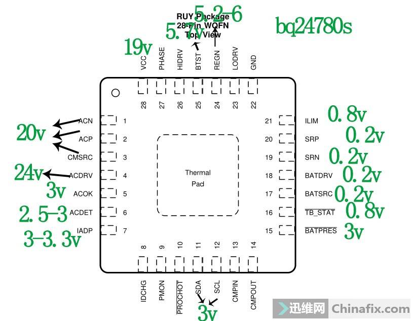

    Hello
    thanks for any clue on this charging problem!
    After 3 or 4 attempts of propper soldering the BQ24780 charger IC the laptop boots up propperly, almost fine for everything except for the battery charging part. It runs from AC only and also from Battery only. when the battery is connected linux says charging 10% but after an hour cells volts are 3.75v each and power supply only draws 390 mah so no charging at all.....
    the mosfets look fine all, charging coil close to battery connector is 11.1v when battery present and 10,9v with no battery present. in the charger IC bq24780s BATPRES is always 0vol..!
    Check voltage at battery connector pins
    With charge plugin only
    0,82V at +
    data and clk 3,2v
    pins in the charger shows:

    REGN Pin must be 6V approx. Check PD8901. If PD8901 is ok, then most likely Charging IC is bad or not properly soldered. Regn is internal LDO voltage of Charging IC.
    • ktmmotocross
      Boardkiller
      • Feb 2014
      • 3628
      • slovakia
      Re: Asus UX303UB charging problem green led blinking
      on that picture he wrote that REGN is 6V

          thanks to all .... yes regn is 6v as described. was inspecting the mosfets and they seem fine all of them 2 in the ac adapter area, 2 for charging and the bat/sys switching mosfet too... regarding soldering yes i think it is ok repased the legs one more time but seems to be ok... BATPRES always 0V...

            data and clock supposted to be 3V
            • marce002
              • May 2018
              • 316
              • Argentine
              yes they are..... also have battery % visible in linux so there is data feed
              look here, many pins with just arround 0.835v ... is it normal? since it is not charging it is....
              THIS IS JUST ADAPTER NO BATTERY MEASUREMENTS:

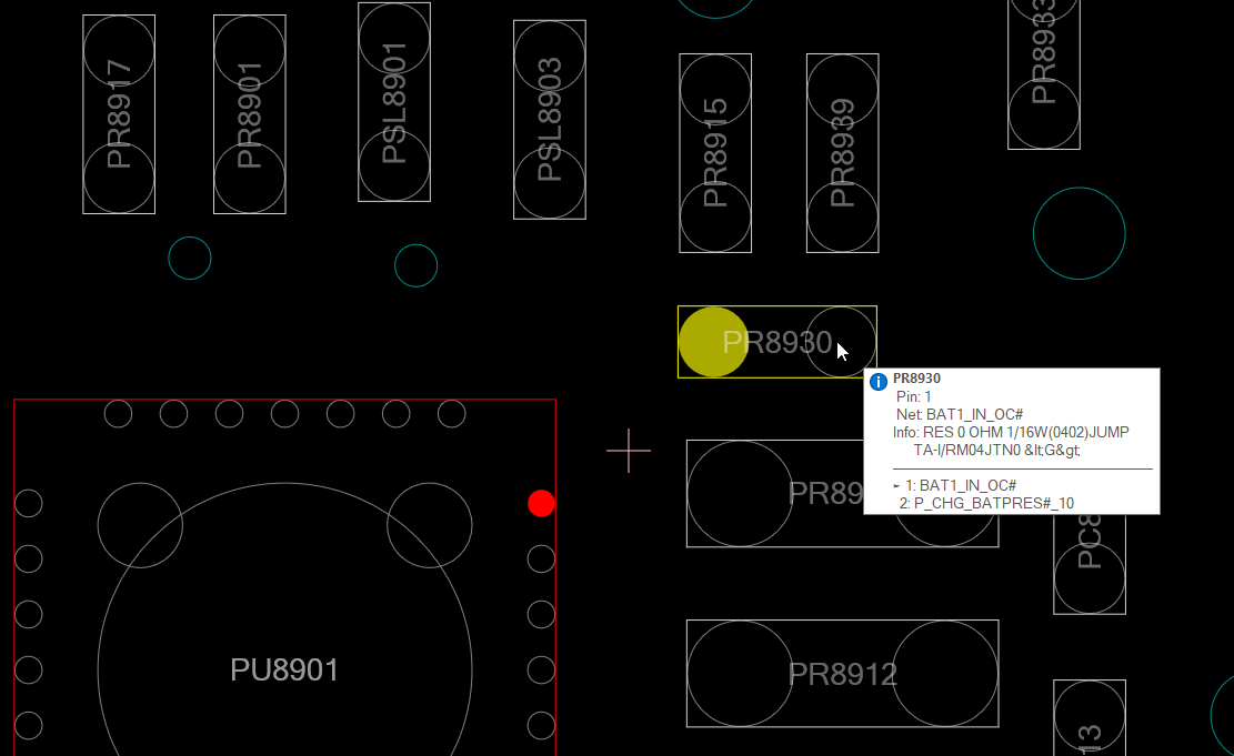

                    Forget that this is ASUS and no schematics are available.
                    #BATPRES is an INPUT to this battery charger IC. If LOW, the BATTERY is present.
                    Power down, remove the battery, check the resistance of PR8930. Value ?
                    Check and post the voltage reading on pin # 1 and pin # 2 of PR8930.
                    Then review and report the readings from the next pic. Check the presence of the resistor and cap that are close to the EC.

                      thanks mon2 , again, ... all my test NO BAT attached...since i stated before: THIS IS JUST ADAPTER NO BATTERY MEASUREMENTS and placed the picture with my volts NON battery plugged..
                      news :I have replaced the BQ IC and same measurements excepto now I HAVE 5V PROCHOT.
                      still have 2.6 ACDET , 3v in ACOK, "0V in BATPRES, the resistor PR8930 is 0.005ohm" and 0v each side, RES to ground each pin of PR8930 is 2ohm mmmm..... no battery attached....

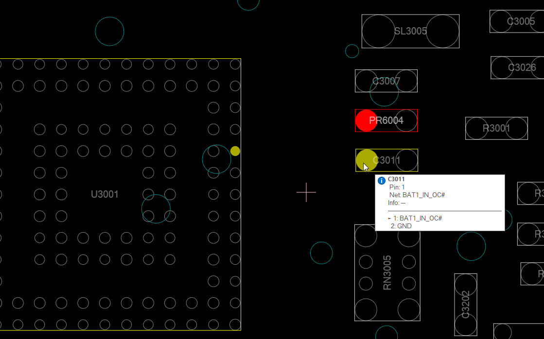

                      PR6004 is ok and 0ohm in the EC side, also caps nearby are ok.
                      remember the mother does work and turns on, is a no battery charging problem.... battery is ok since it worked from bat only..
                      mother blinks green line, consumes 300 500 mah ok
                        this is a 0ohm line straight from pin 15 BQ to the EC i can see..... since it has a ground resistance of 2ohm is the EC bad? weird to detect bat when there is no battery... dont know what to think, or is it the brand new installed BQ....mmm no clues, what else can i test mon2....

                          hi. I think our frame of reference was incorrect earlier in this thread.
                          #BATPRES is an INPUT to the battery charger. If this pin is LOW = "0" = 0 volts, then the battery charger is being configured with the knowledge that the battery is present in this box.
                          For this reason, I think it is ok to see this line as LOW from the EC.
                          Not sure if this pin is expected to be high but you can perform a quick test as follows:
                          Remove the 0 ohm resistor that is bridging the EC GPIO pin to the #BATPRES on the battery charger. After this resistor is removed, #BATPRES will be floating.
                          Next, take a 10k (or any similar resistor) and apply to #BATPRES pad; the other side of the same pull-up resistor to a +3v3 rail on the logic board.
                          What you are trying to do is to inform the battery charger that the battery is NOT present on the logic board but the hard logic low must be first removed.
                          Then the charger should allow for the passthrough mosfets to enable and power the logic board. That is the theory.
                          Can you try this idea and post your result? Please proceed carefully as to not damage the SMD pads or apply any shorts.
