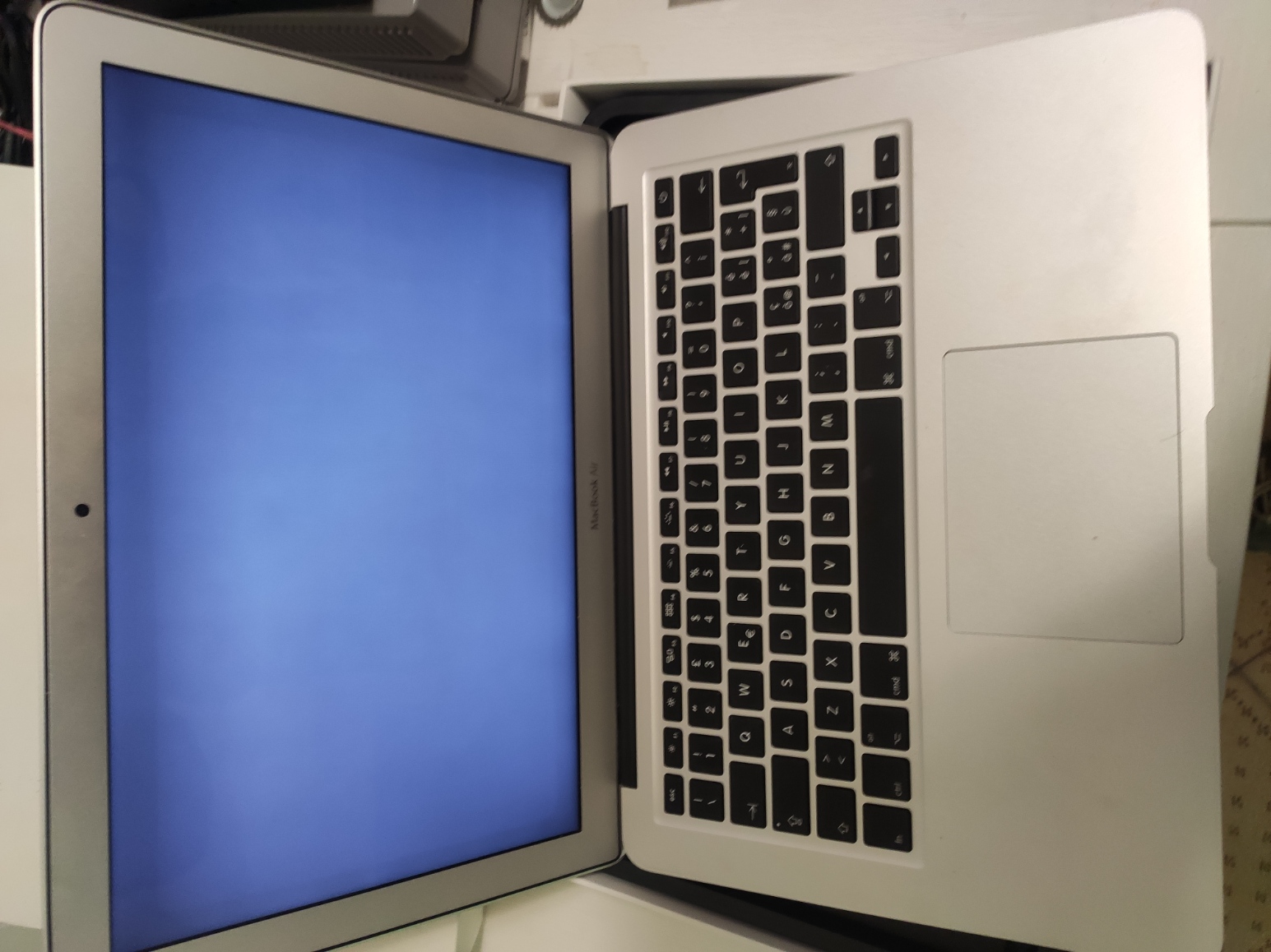

Macbook air 13" a1466 Grey screen
  • lordgeny
    • Apr 2016
    • 223
    • Italia

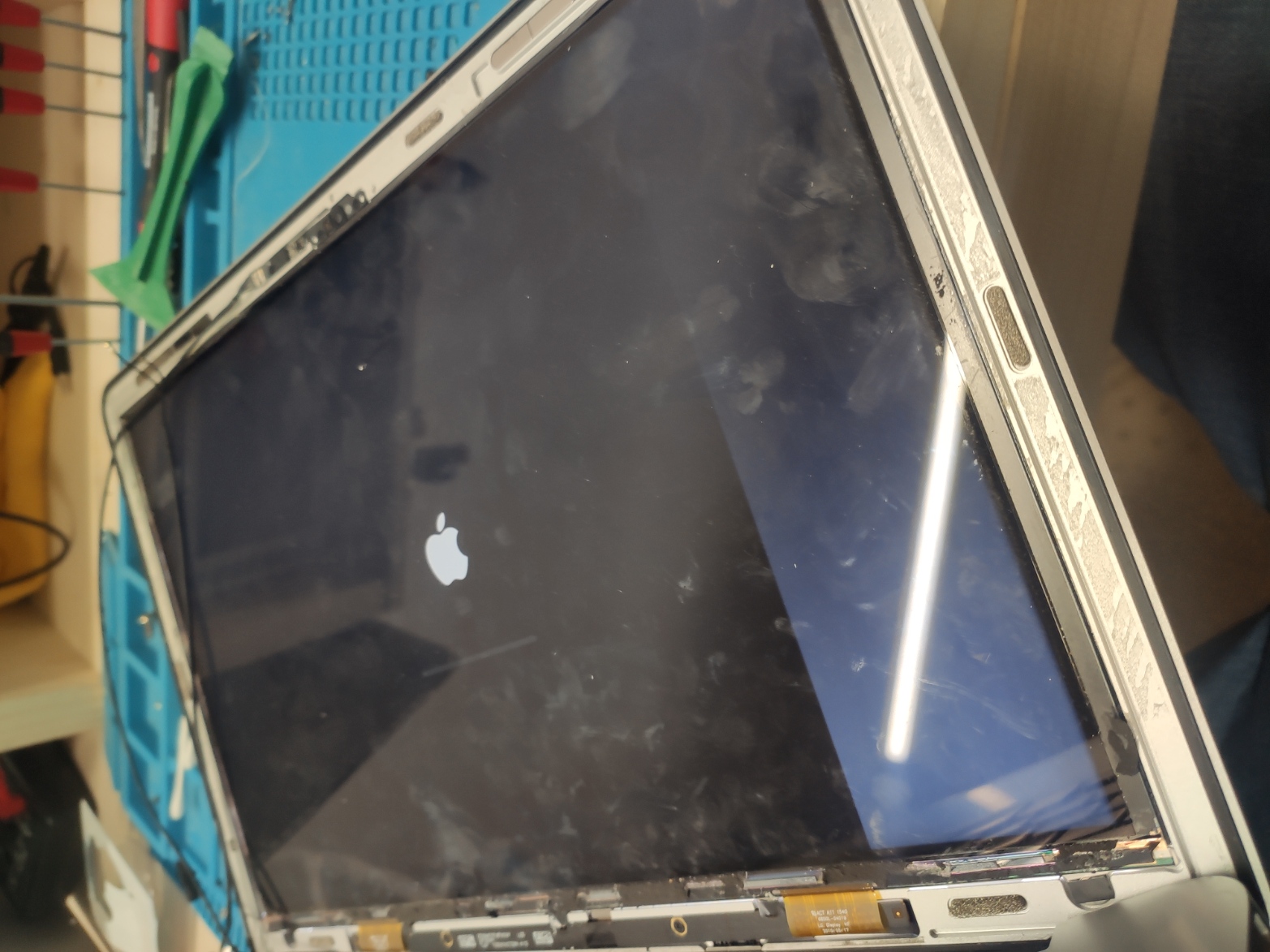

    Macbook air 13" a1466 Grey screen , work with ext screen, work with a 2012 screen (just for testing , wifi cable and data are not the same ) but lvds yes. and it worked .
    So i opened the screen and now display partial workin... can be the lvds cable ?

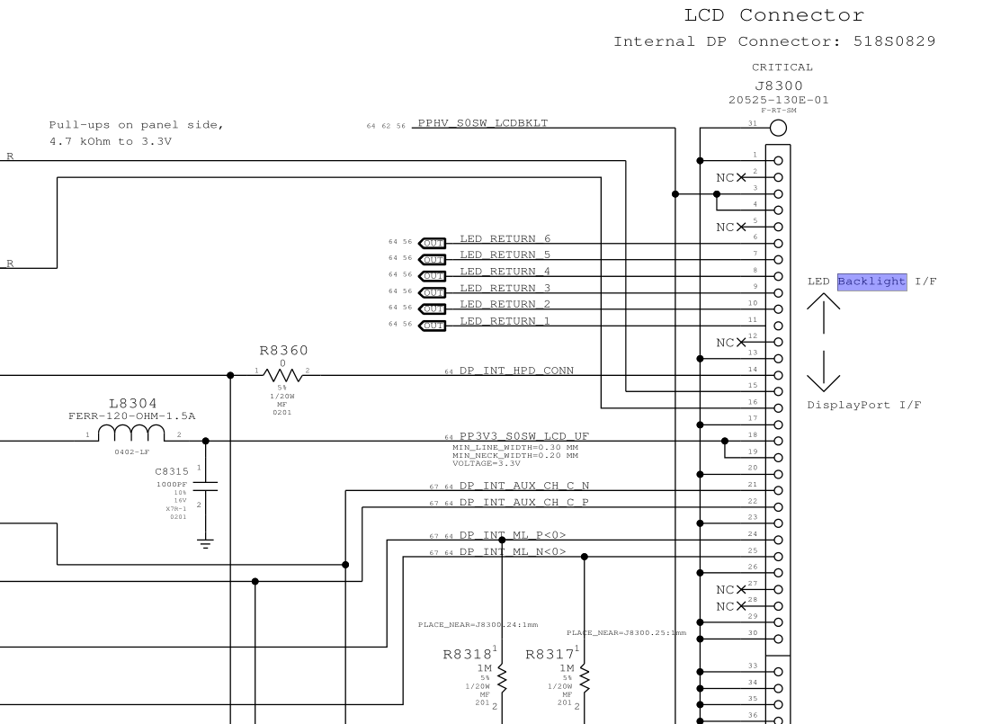

    Inspect the backlight LED return lines from the display to the logic board.
    I think some are not mating correctly which is leading to a partial proper backlighting.
    Once the computer is booted, can you see the graphics on the right side of your display ?

      Bad column driver on the panel.
