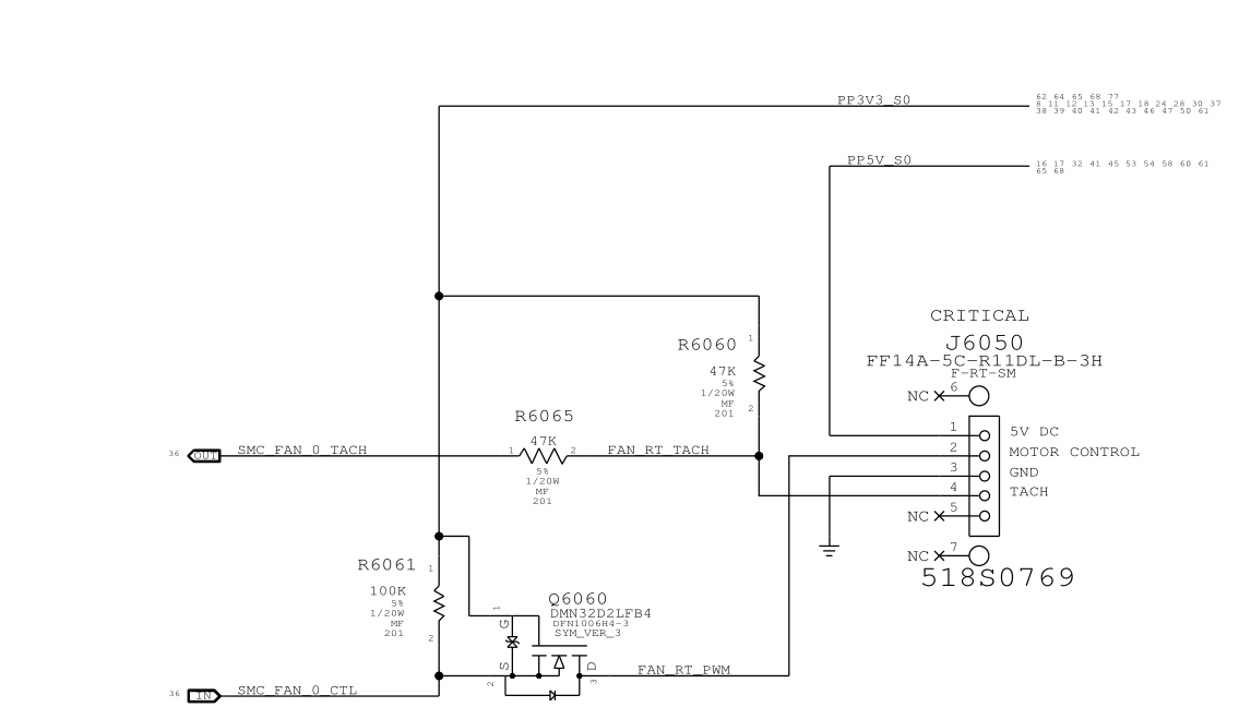

    Hi. Just received an A1502 (820-3476) that had a damaged LCD panel. The panel has been replaced, unit works fine - chime and all but have yet to see the fan turn on. Not a good sign. Temp is about 40 degrees C on the heatsink.
    Will check the mosfet @ Q6060 that is responsible for motor control (J6050).
    Have attempted PRAM reset - no difference. The fan / logic board look mint with no dust, no liquid damage / no liquid indicator triggers.
    Any suggestions?
    Update - fan just turned on via diagnostics. Perhaps a non-issue and the logic board was cold enough as to not trigger the fan?
    Please ignore (unless you believe this board is not behaving correctly).

      Are you 100% sure this is a 3476 and not a 4924? If yes run ASD to make sure the fan motor tests and CPU warm-up tests pass.

        1) No, we are not 100% confident of the board # as we could not locate the PCB etched markings on the topside (after the bottom lid is removed). The boardview locations for the LVDS, battery connector, fan connector all match the 820-3476.
        2) Did run ASD and the tests passed. The ASD testing process enabled the fan spin. The fan connector is factory tight - no one has been inside this machine before us. There is a large block bump pad on the fan FPC cable. Guessing it is to lift up the bottom lid and serves no other purpose.
        Just somewhat baffled that the logic board boots upon turn on and does so without a fan spin. Used to fan spin upon power on cycle.
        So, is it normal to not have the fan spin on power up (like all other inspected macbooks to date) for this A1502? It is our first A1502 in the shop.

            I too was trolled by an A1502 where the fan would not come on at startup. Mine was an 820-4924 that would come on and run for long periods without the fan. I loaded the Macs Fan Control app so that I could see the fan speed and the CPU temps. I could manually turn the fan on with the app so I could see that it was not a problem. For some reason this model will stay cool without the fan.
