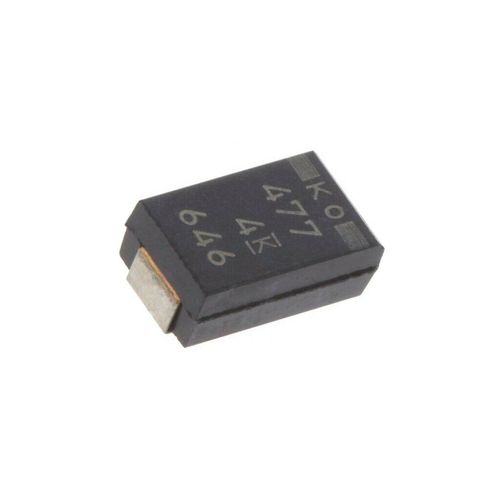

                                    #957
                                    Re: Toshiba Satellite - Locks up when plugged in
                                    I have an Acer Aspire 6935g which seems it needs replacement of the NEC TOKIN capacitor.
                                    330uf tantalum need to be SMD (https://www.ebay.com/itm/4-x-SMD-Tan...8/232303050868) or are ESR also OK (https://www.ebay.com/itm/4pcs-ESR-7-...332242655643)?
                                    Originally posted by jeremykum
                                    Actually 330uf x 4pcs isn't really sufficient in value, since OE907 new measured with ESR meter show almost 1300uf.
                                    Now 470uf tantalum low ESR is easily available, 4pcs of these last a long time before need to replace it again.
                                    Are these capacitors below, 470uf tantalum low ESR?
                                    https://www.ebay.com/itm/T520D477M00...m/193458822505
                                    • piernov
                                      • Jan 2016
                                      • 4437
                                      • France
                                      #958
                                      Take 4x 330uF aluminum SMD capacitors from CPU VCore section of a laptop donor board.
                                      NEC Tokin ESR is 1 to 2 ohms. ESR of replacement cap should preferably be close to 6 ohms so 4x in parallel means 1.5 ohm total ESR.
                                      • Aurumnus
                                        • Sep 2020
                                        • 6
                                        • Greece
                                        #959
                                        I don't have available a laptop donor board.
                                        I have to buy new capacitors from Ebay.
                                        This result comes from division 6/4=1.5?
