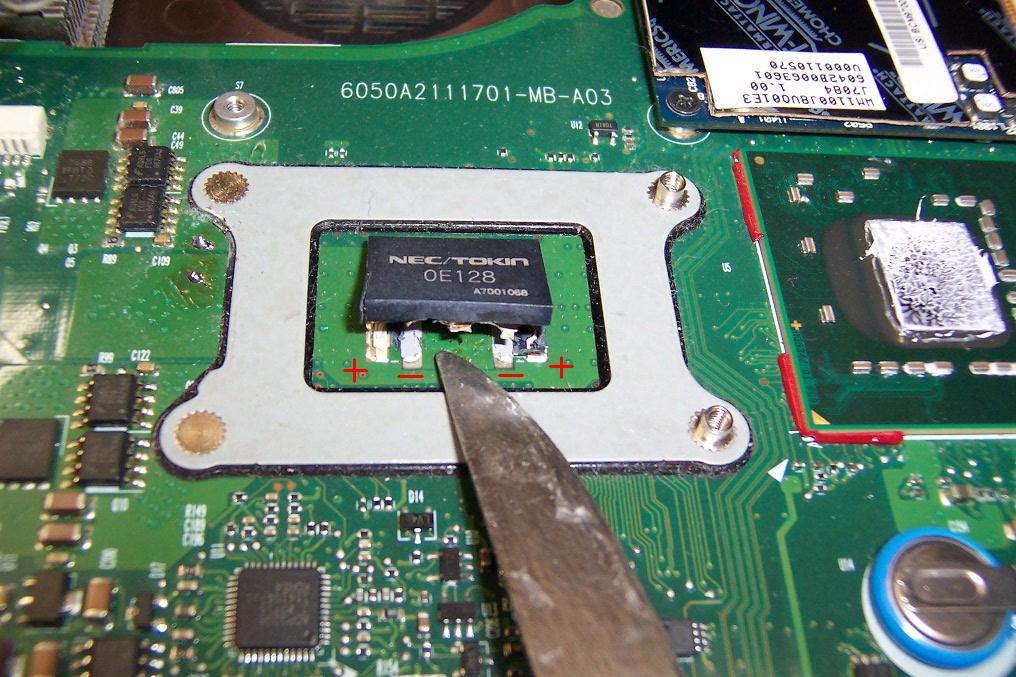

    The proadlizer capacitor can be pried from the PCB with a thin sharp knife. I found the solder to be brittle.
    The + terminal strips usually stay attached to the PCB and have to be removed seperately.
    I have been using eight of "GRM31CR60J107ME39L CAP CER 100UF 6.3V" from X-On.

      How long did it take to pry off? I know this would be an ideal way of removing a component but I do not have the equipment to remove such a thing properly. Any other details to help remove it.
      Also 8 x 100 , that is a heap less than the original - so it still works fine?

            I repaired the 8th one yesterday.
            The two (-) terminals are actually part of the same metal plate which lifts off easily when the knife point is inserted as shown.
            The edge of the knife is then used to first lift the ends of the remaining (+) strips from the PCB, then are easily peeled off.
            Watch out for fine tracks nearby that might be damaged by the knife.

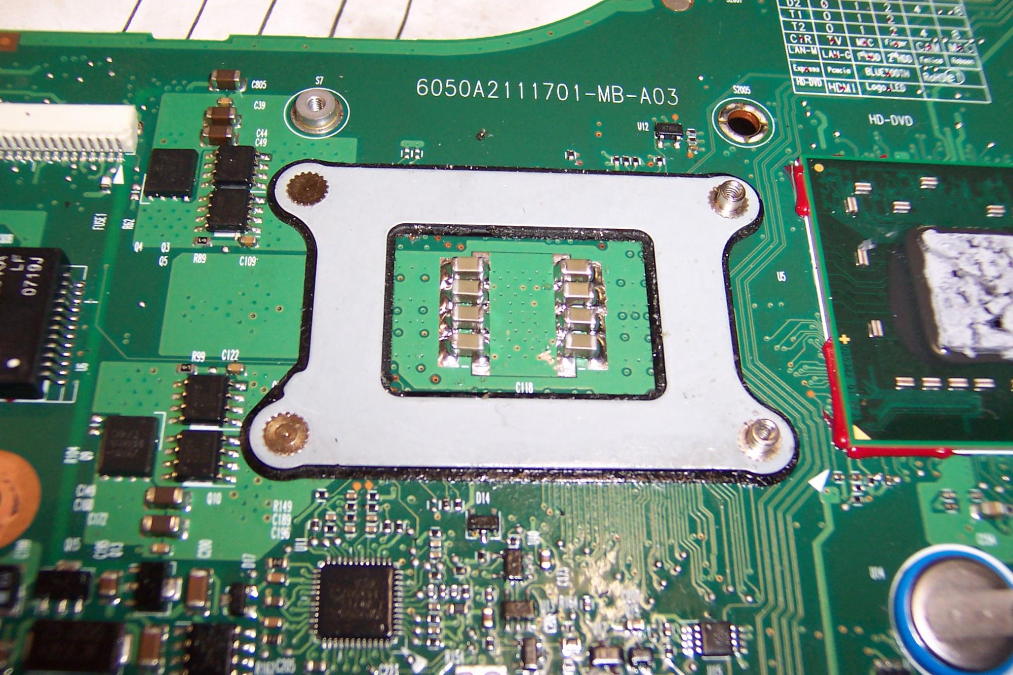

            I see some ripple with 6 capacitors and very little with 8 fitted.
            Dont mistake Vcore voltage changes for ripple. I have seen it change from about 0.7 to 1.1 volts, hundreds of times in one second when its power saving.

              The OE907 is removed, now waiting for some Caps to arrive from RScomponents - Capacitor,tantalum,SMT,T520,case V,10%,2.5Vdc,ESR0.009, 330uF.
              So I will end up with about 2.5v 1300uF ESR 0.002 - pretty close to the original in V and ESR (original is 0.0015) but with 400uF higher cap.
              rievax, shouldn't you be trying to have 1200uF total seeing OE128 is that value - you have 800uF (not sure of esr of the caps you have)?

                I might have less than 800uf because the capacitance decreases with applied voltage with these ceramic capacitors.
                I dont know the ESR. Ceramic capacitors usually have very low ESR.
                I have decided to keep all 8 of the A200 laptops for now for testing.
                I have seen no sign of instability yet.
                Surface mount ceramic capacitors can crack with temperature cycling. I hope this will take a very long time to happen.
                I like the Toshiba Satellite A200 alot because of the high sound quality. I had to replace the H/K speakers in 2 of them from EMPR.

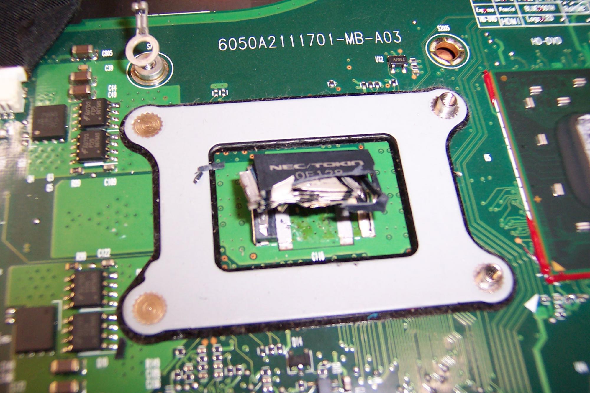

                    I used to leave the proadilizer capacitor in place and add 2 large electrolytic capacitors to the Vcore rail. I think this is the reason for the Vcore regulator failing in one of the A200s I did this to a year ago.
                    One of the high side MOSFETs had gone short circuit, attempting to apply the whole 19v to the CPU causing the power supply to overload and shut down.
                    I replaced the MOSFET and all is working well, the CPU had survived. Also replaced the proadilizer with the 8 100uf ceramic capacitors.

                      I have the EXACT same problem. Did you get a solution for your ISKAA LA3481P REv 2A?
                      This is the model that NOT have the NEC TOKIN.I got 15 small and one even smaller.
                      I have a PSAE4E-039018N5

                                          The oldest has been ok for 3 months. The 9th and final one would restart once only on cold mornings then be ok all day. Because I have run out of the ceramic caps, I have temporarily added an electro to the Vcore rail.
                                          So looks like I should be using 10x 100uf ceramic caps.
                                          I have left the CPU in the socket and there is no real need to remove the board from the lower case.
                                          No problem with the soldering using a 900M-T-3.2D tip with my Hakko 936A clone.
