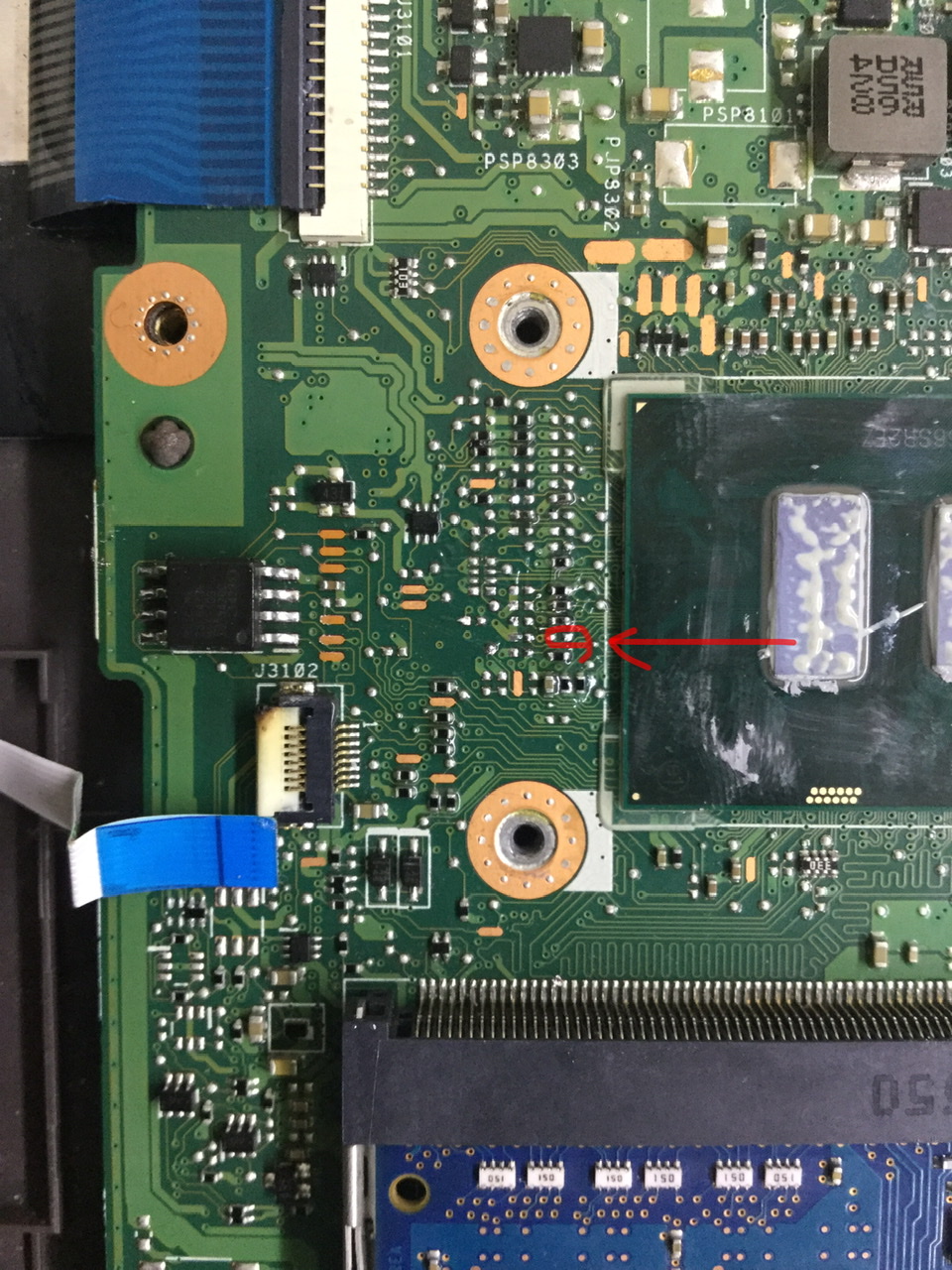

    Hi i was trying to disable onboard ram on asus x556uj motherboard but i dropped this tiny resistor and i can t find it .what is it's value ? And is it found on any asus laptop because i don t have the exact model and thanx

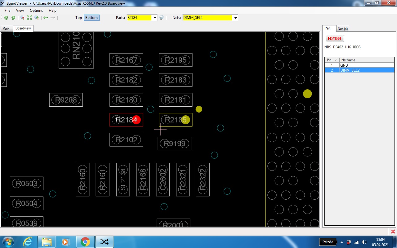

      soldaki R2184'e benzer olabilir.

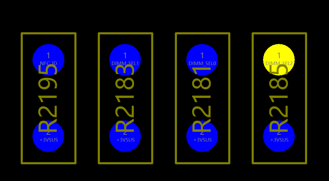

        as per advice from @khaak, value should be the same as R2181.
        Missing component is R2185.
        Remove all power, battery. Place meter in resistance mode and measure the value of R2181. Use the same for R2185.
        This part is 0402 size and 5% should be ok. (Thanks @Sametby for the size details. My boardview does not show this detail.)

          Thank you all for your help it was a 10 k ohm resitor the one nextto it mesured 9.67 k ohm i replaced with same valu and it worked onboard ram disabled
