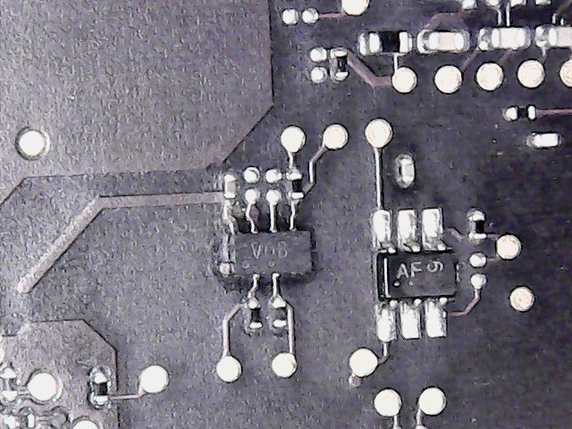

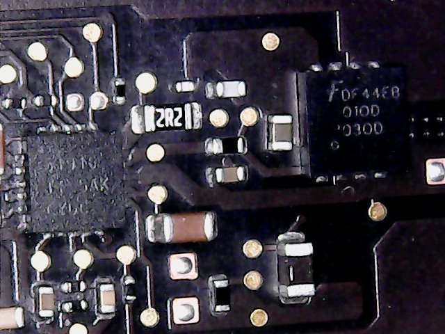

    In add, yesterday found a component near the lcd connector, that cant remind what it is... Measured around 6v then 12v then 0v then 6v again and repeat.

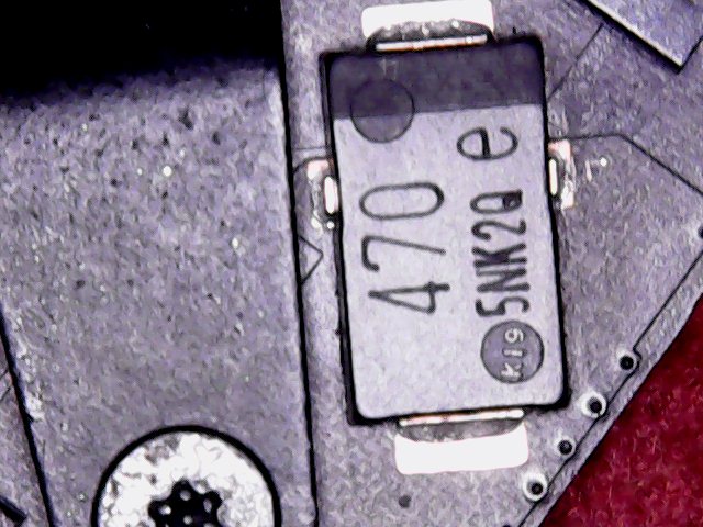

    In other hand I have a cap C1031 470uf CRITICAL, apparently in short. An smd tester shows me a short, this is the only one grand cap what I cant measure with tester without obtain a short, all other grand caps measure like the schematic and I not see any like this.

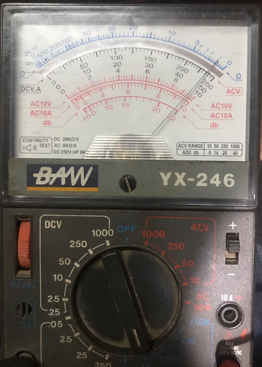

      Sorry, all measures are wrong because im using a needle tester for voltages resistances and consumptions. Calibration error.

        Re: Macbook A1502 820-4924-A only smc bypass (Schematics measures and boardview inclu
        C1031 is on CPU VCORE line, its normal to see low resistance. Where was liquid damage located on the board? Can you upload a picture.

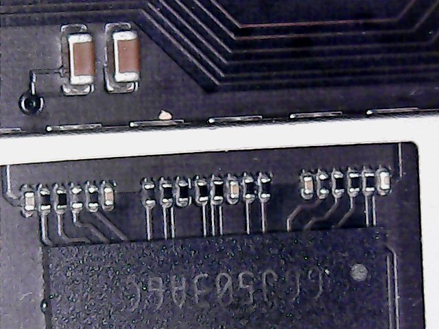

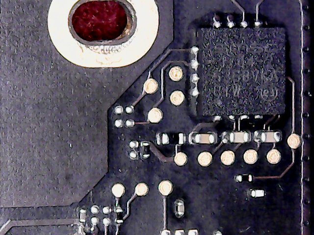

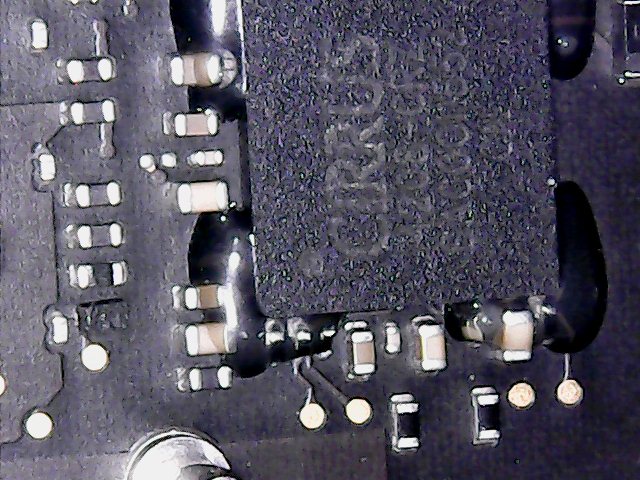

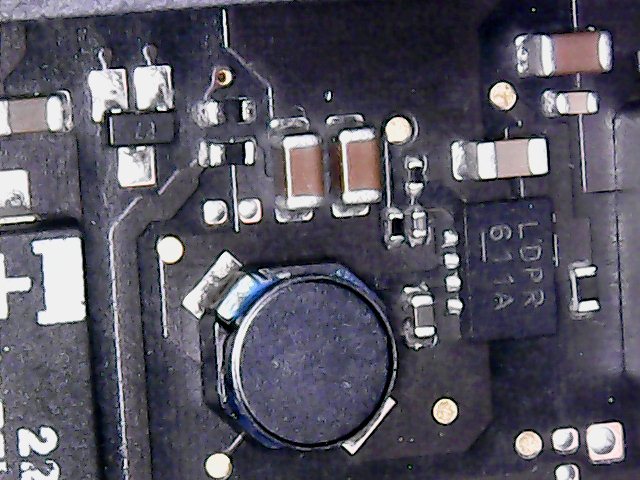

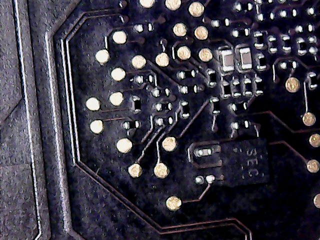

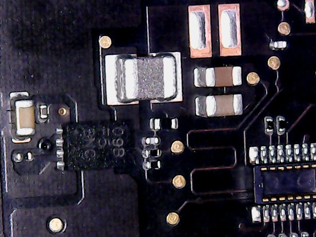

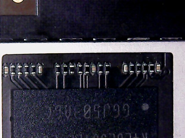

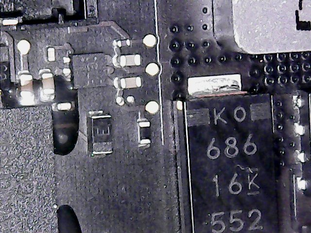

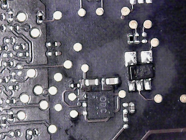

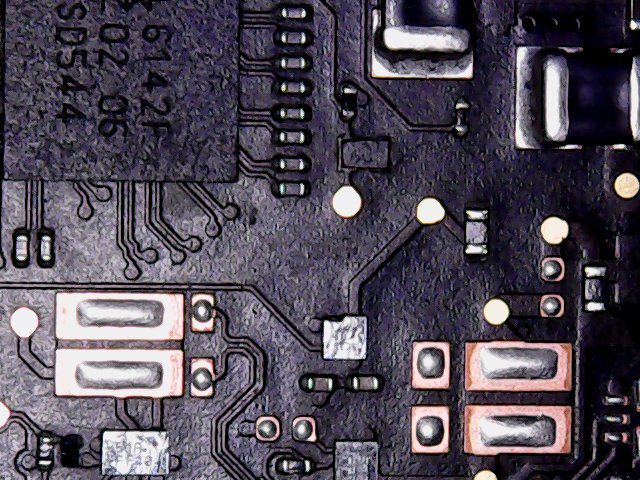

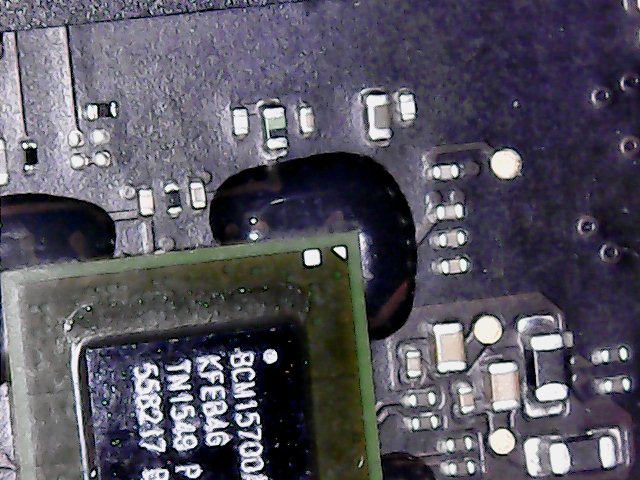

            Uploaded a capture of the c1031
            Do you wanna that ? or a general picture of the board?
            Has been wet on the upside near the battery and otherside also.
            CPU and RAM were safe, I guess...
            When I see that, case open, disconnect battery and cry...

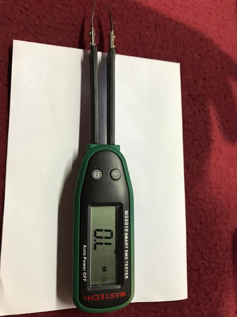

              A picture of the SMD Tester

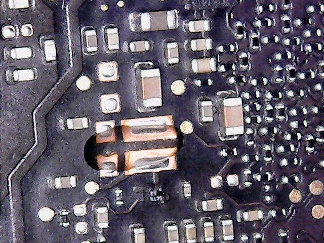

                Picture of the board (Both sides), especially where there was water. Do you have a bench power supply? If yes, what is the current draw of the board?

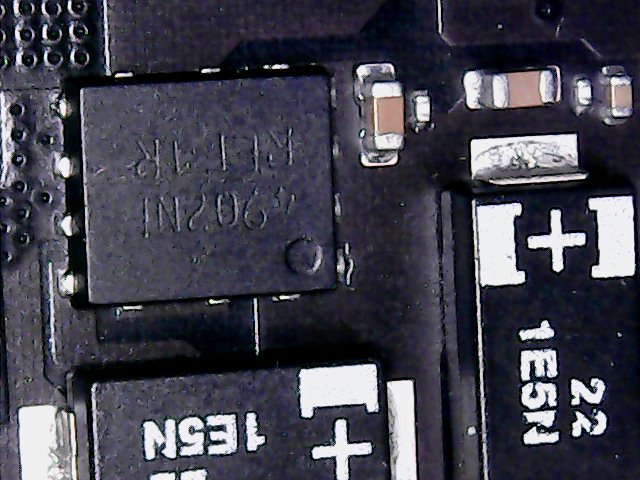

                            Today I tried with another original magsafe 2 60w. Only boot in SMC bypass, and Starts without battery on SMC bypass. Fast orange light, then green light (for about 2 seconds), then orange light and stays here.
                            Measures:
                            PPBUS_G3H - 12.9v
                            R3080 pin 1 --> PPBUS_G3H 12.9v
                            R3080 pin 2 --> TBTBST_PWREN_DIV_L 8.4v
                            C3080 pin 1 --> PPBUS_G3H 12.9v
                            C3080 pin 2 --> TBTBST_PWREN_DIV_L 8.4v
                            I see some brown in Q3080 surface
                            Q3080 pin 1 --> TBTBST_PWREN_DIV_L 8.4v
                            Q3080 pin 2 and 3 --> PPVIN_SW_TBTBST 0.5v (TP1-R3088-R3091 shows a peak on 0.1v and goes down to 0.05v then stays
