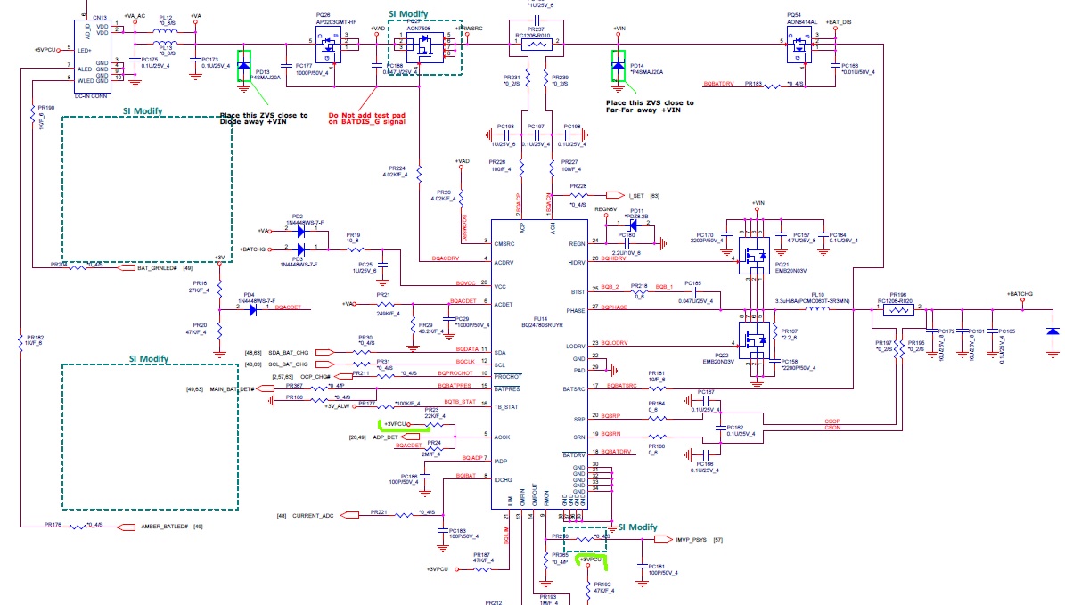

    I Have a zbook G3 dead APW70 LA-C391P Rev 1C , It doesn't work with the AC adapter plugged AT ALL, it doesn't charge the battery either.
    when i boot the charger i have light from charger connector but no reaction when i power it on, i tried to test it with another charged battery but the same issue, no reaction at all .

    The controller is a TI bq24780s, SIO is nuvoton npce586ha0mx
    https://cdn.badcaps-static.com/pdfs/...db6a5abfe2.pdf
    More testing i did and reverse engineering to find the components and some oddities, did a table with AC, BAT and BAT+AC:
    AC Only:
    As i stated in the previous post: internal rail is at 19V:
    ACN 19.9
    ACP 19.9
    CMSRS 19.8
    ACDRV: 24.6V
    ACOK: 0 V
    ACDEC 2.7V
    BATDRV: 3.7V
    VCC: 19,26V
    BATT(battery terminals): 3,7V
    PHASE: 3,8 V
    SDA 0
    SCL 0
    BATPRES_: 0v

      Seems like 3V LDO is missing. Check and confirm.

        Thank for reply,
        TPS51225
        VREG3 3V

          Then you need to findout why ACOK is 0V as well as SDA/SCL pins are 0V. Does the SIO getting power?? Is PSL involved as sio is Nuvoton??

            i am following the ACOK , i found that 3VPCU is 0V , 3VPCU is coming from where?

                You have not mentioned the mb part number so i dont know which schematic you are referring to. Post the link to schematic. 3VPCU-you need to look at 3/5V regulator.
