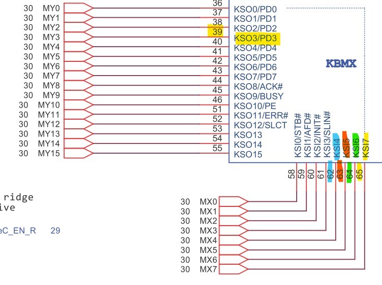

 I found this information on a board that uses this IC model, but I haven't been successful in recording it yet. We'll have to try again. We need to improve the information about this IC, as I haven't found much material available on the internet. But I hope this can clarify things.Kyboard pinn io pins KS03=23 (MY3) 39 KSI7=3 (MX7) 65 KSI6=4 (MX6) 64 KSI4=6 (MX4) 62 KSI5=5 (MX5) 63 RT809F pins PIN 01 KSI4 PIN 02 KSI7 PIN 03 No Used PIN 04 GND & KS03 PIN 05 KSI6 PIN 06 KSI5 PIN 07 (No used) PIN 08 (3v Power) Comment
