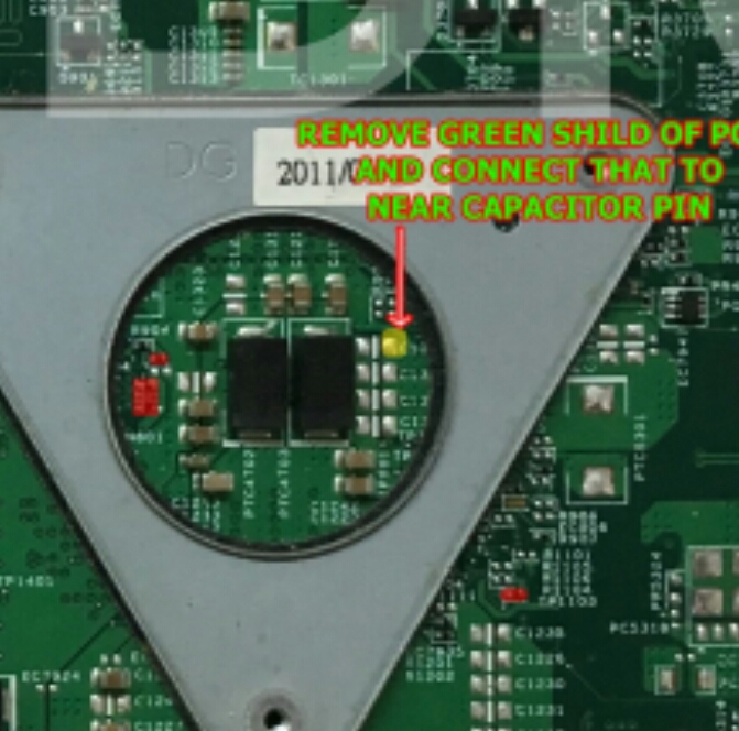

    hello!
    i'm kinda new to this and i found this picture/tutorial, can anyone give some simple instructions since there are some yellow squares that don't say what must be added and i didn't understand "remove green shild of pcb and connect to near capacitor pin"
    if someone could spare me some time to explain things it would be much appreciated.
    thanks in advance

    Re: DELL N5010 discrete to uma conversion
    This is very well explained
    Follow a,b,c,d,e,f,g,h,I,j.
    A is first step
    It is asking to remove and add some resistor and a crystal and remove a ic etc
    Find schematic and you will find same written in schematic with blue colour UMA
    A few extra added here rest is same as schematic
        thank you all for your answers, some letters can be found twice so if for example there's A with red and A with yellow that means i should take that component from red and move it to yellow respecting the same
        letter? am i understanding this right? and how about that "remove green shield...." sentence what should be done there? ( in simple terms please) and thank you
          Yes yellow is addition
          Yes red is to remove
          I think Green shild is light green lines which connect components
            i understand now thanks a lot, one last question what should i connect here? sorry if i asked a lot of questions
