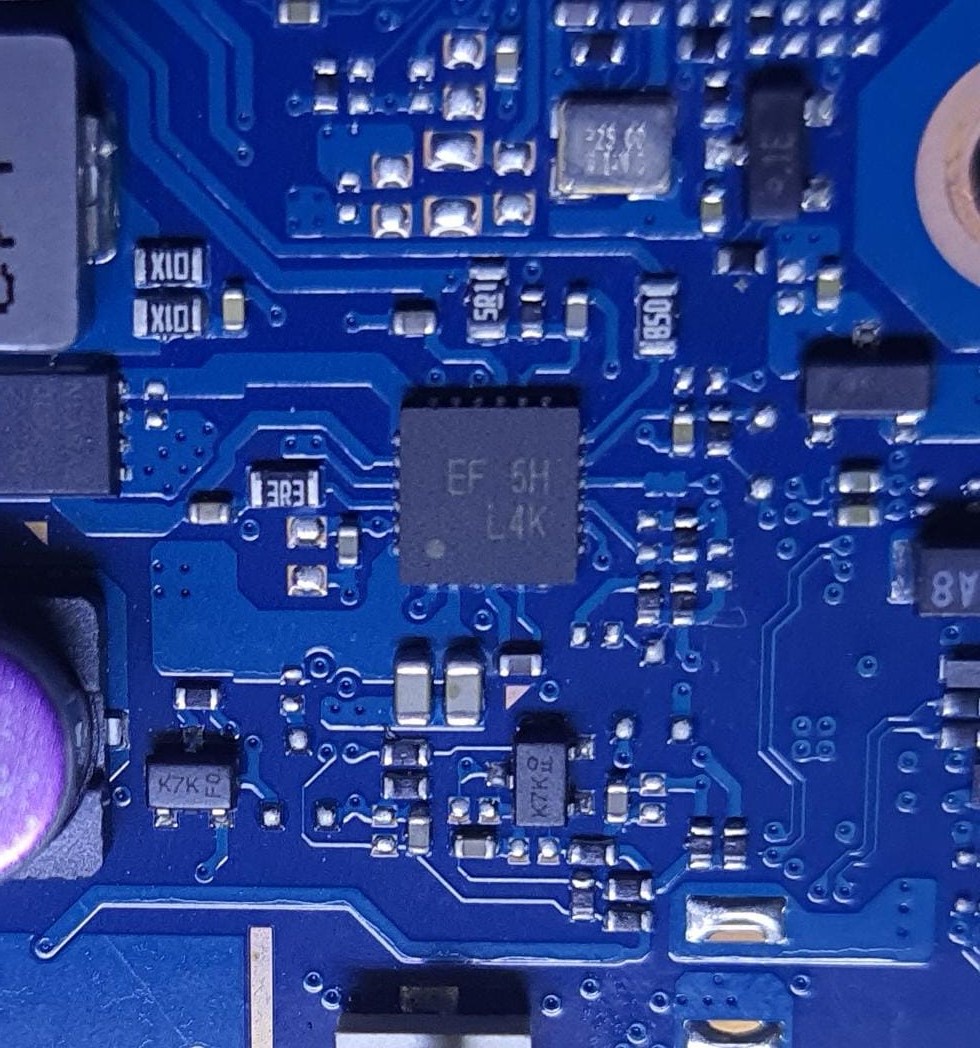

        Can anyone help me find the real name of this component?
        Samsung NP350xaa
        BA41-02639A
        apparently it's the buck converter of 1.2V Ram
        EF 5H
        L4K

          Your component is a RICHTEK RT8207LZQW PWM Controller.

            Thank you my friend

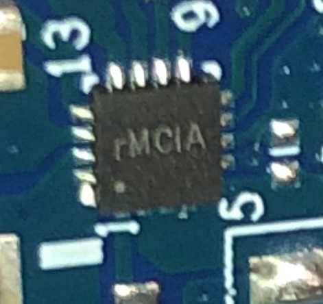

              Re: IC Marking Codes and Datasheets

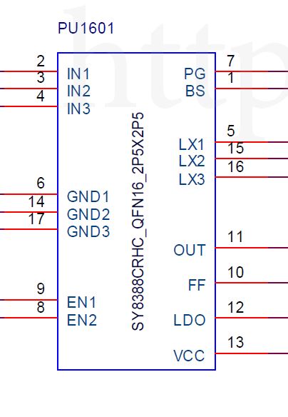

              SY8388CRHC QFN16
              Board: Lenovo NM-D031

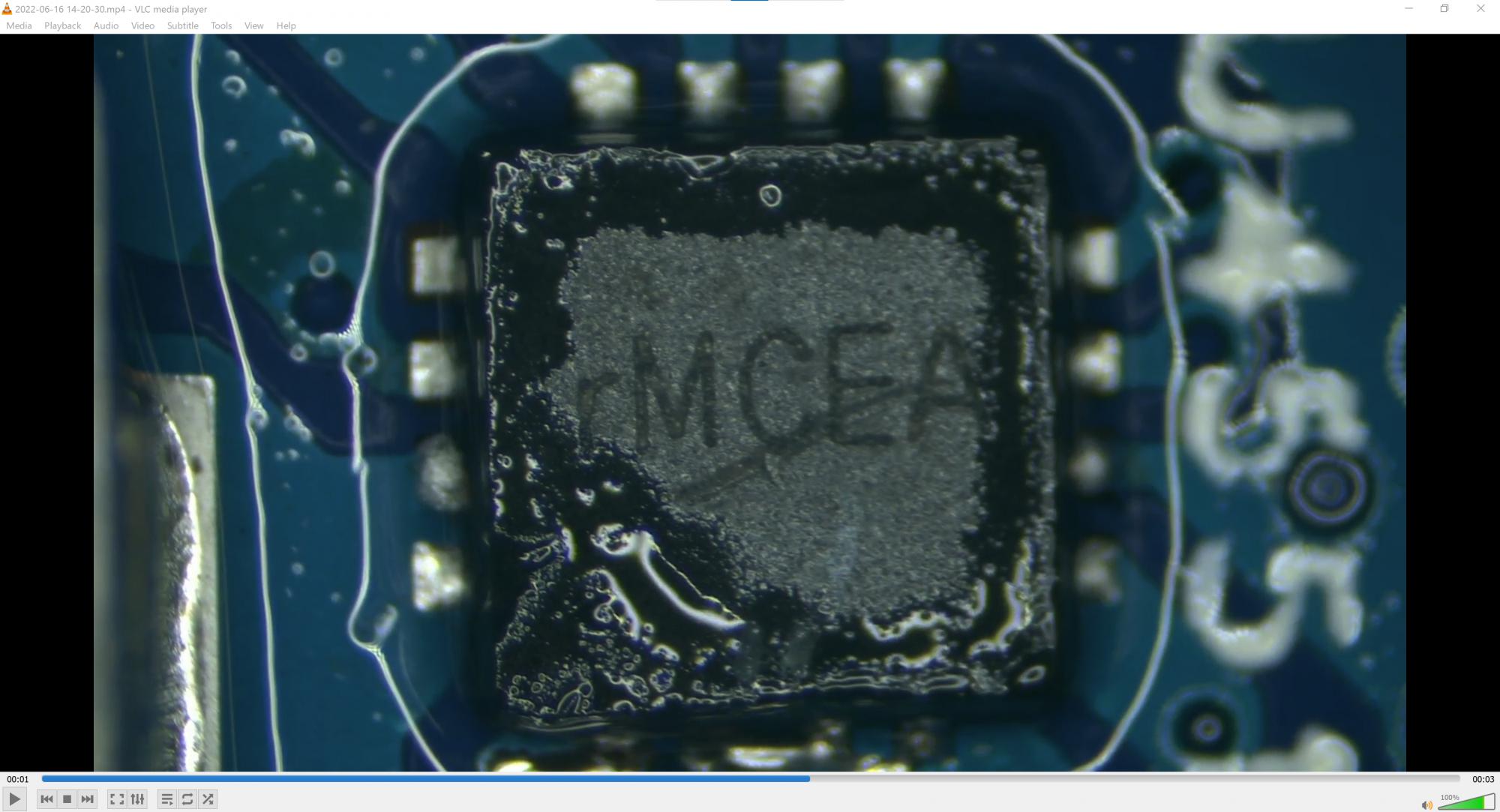

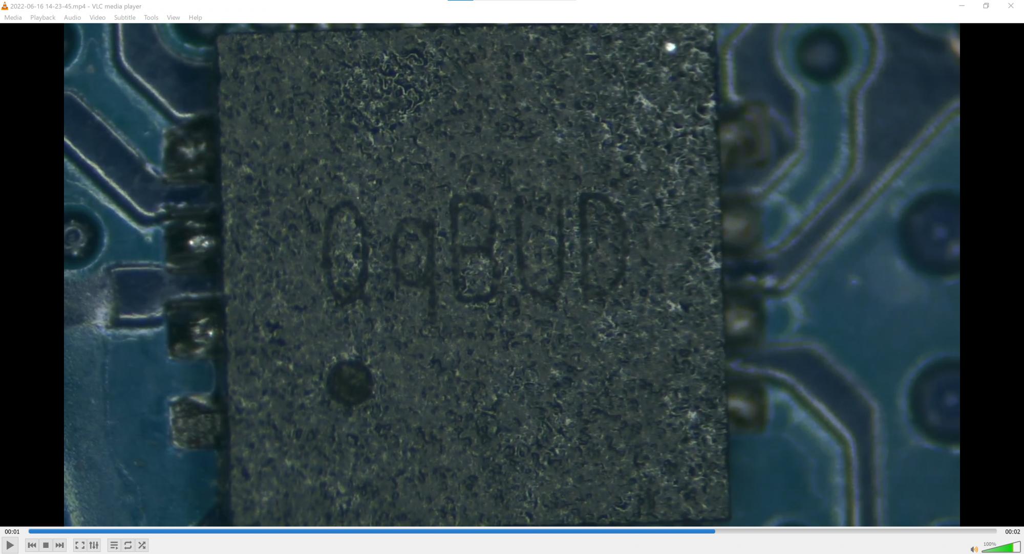

                      anyone know what these chips are? from a HP x360 convertible 14t-dh200

                        Both parts are made by silergy https://www.badcaps.net/forum/showpo...1&postcount=12

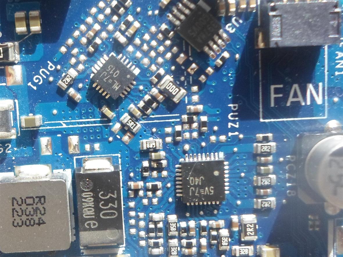

                          Please i need to know about this 2 ic
                          i can't found the shematic

                                RT6543agqw
                                RT3612ebgqw
