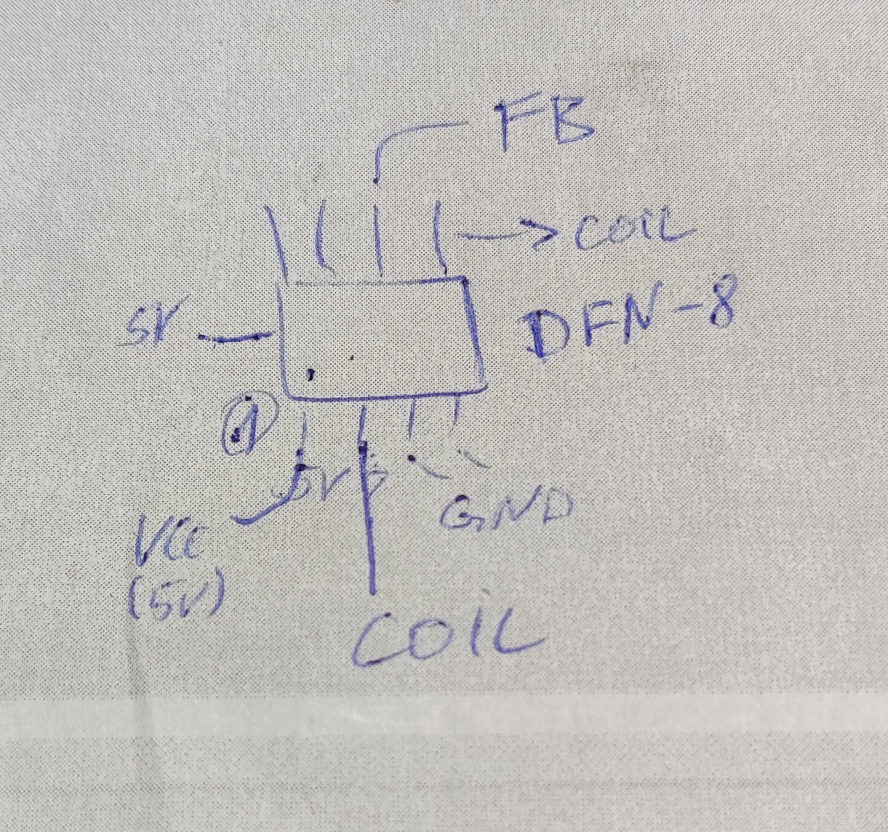

                      I need help identifying a chip with marking
                      A8D
                      S53
                      Package seems to be DFN-8
                      I'm attaching pictures, taken under microscope. I'm sure it's dc-dc buck converter, producing 3.3 volts. Also measured some components around and figured out the connection diagram (the last sketch)
                      Any help with identification or similar chip from other manufacturer is greatly appreciated

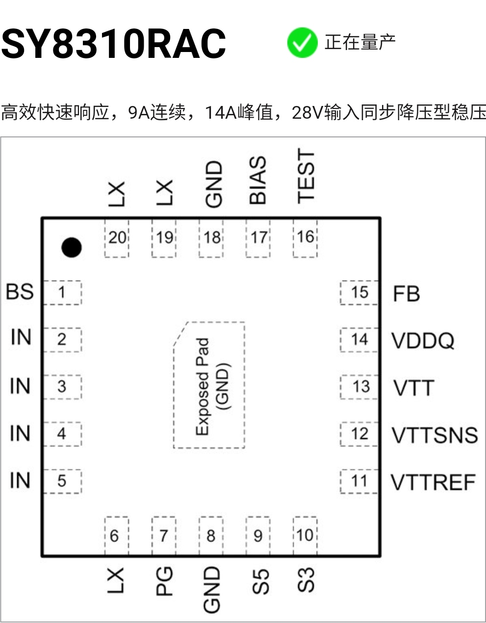

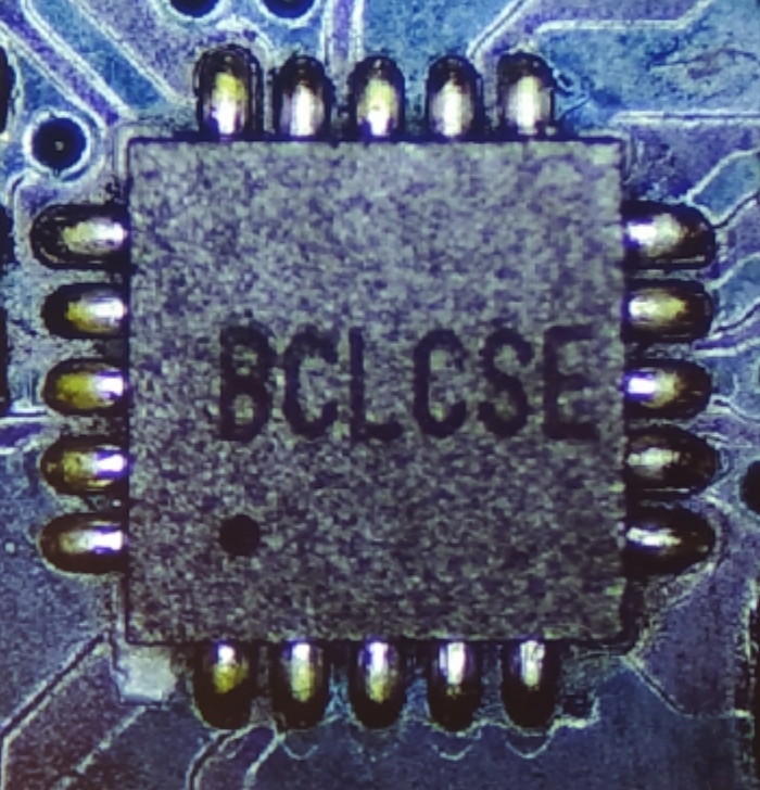

                        Would you Like to add Silergy SY8310RAC - Top Marking scheme likely BC**** , Into your Sheet?
                        Edit: Found on LA-J261P
                        FairRepair on YouTube
                          • 21606
                          #52
                          Re: IC Marking Codes and Datasheets
                          Added ,Thank You

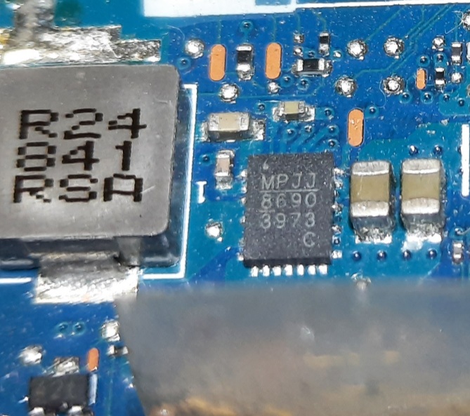

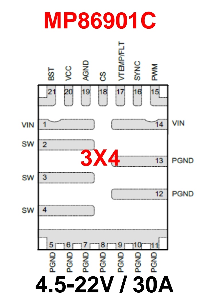

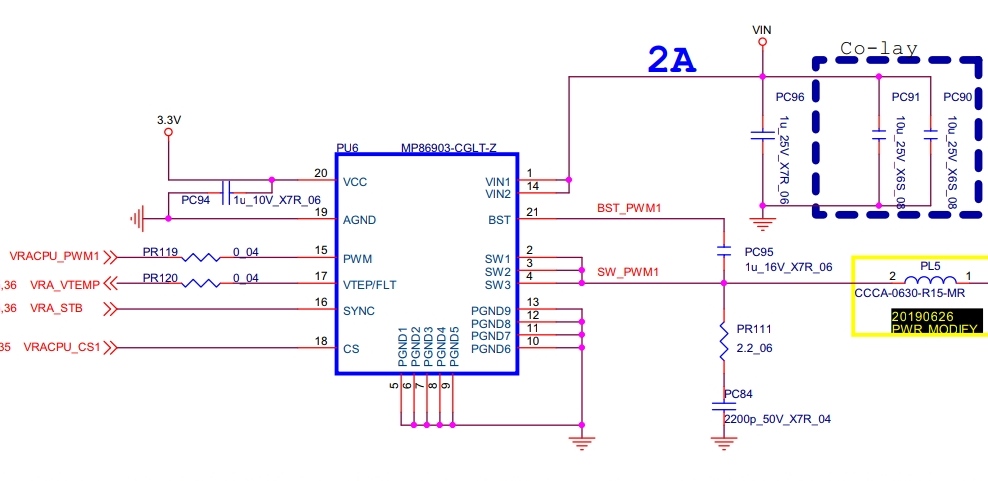

                            Are this mp86901 cglt-z?
                            Does anyone have its datasheet?
                              • 21606
                              #54
                              The part number seems to be MP86903-CGLT ,there`s no datasheet or any info about it at the MP web site.There`s a pinout in this schematic - https://cdn.badcaps-static.com/pdfs/...87452a14c3.pdf PU6 on page 87
                                MP86901CGLT-Z and MP86903CGLT-Z have likely identical Pinout

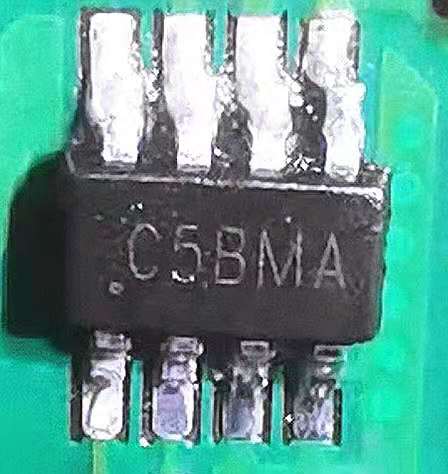

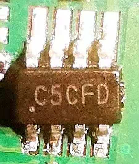

                                    hi, marking "C5BMA" and "C5CFD" the same ,please help me to find out
                                      • 21606
                                      #58
                                      What motherboard are these on.
