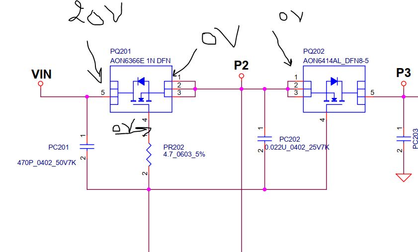

    hi guys
    i have a power problem with this laptop:
    no power at all
    the pins 5-6-7-8 on pq201= 20v
    pins 1-2-3 on pq201= 0v
    pin 4 = 0.021~~0.044v unstable
    no short on pq201 nor pq202

    Re: y520-15IKBN
    Voltage at charger ic pins ! did you find the requirements voltages to work !

      Re: y520-15IKBN
      These are very basic steps and @mazloum with 337 posts should be knowing this. Check basic requirements of charging IC as@lapfix has suggested such as ACOK,ACDET,ACN/ACP/CMSRC/REGN Etc.
