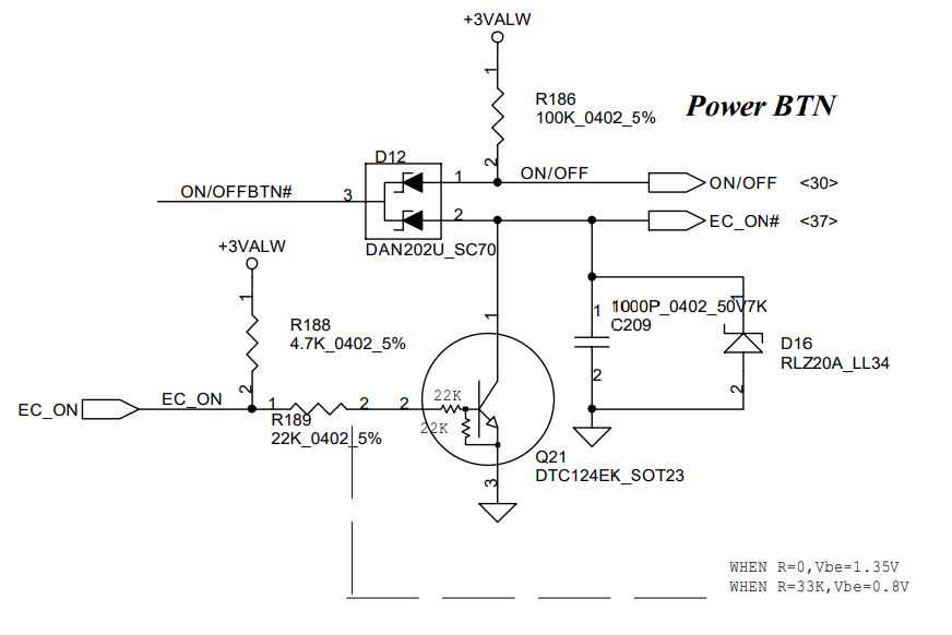

        You have a problem over there!
        There must be only 3.3v no 5v in any pins
        Do you have the board no.? here is a picture about the pwon circuit.
        I found one schematic, here it is my friend!

          WRONG. 5V is correct on pin 3-4(what @s_henya is counting as pin 1-2). Pin2 should have 2.4V approx. This mb has nuvoton sio and it has PSL Logic involved. So pwrbtn will not have 3.3V but should be 2.4-2.5V. On page 27, PSL logic is described. Start from there.
          • mcplslg123
            • Jun 2015
            • 7262
            • india
            Re: Dell Inspiron N5110 3.3v present but not on power button
            Sorry, Just read the entire post. You have 3V ALW on coil-so PSL logic is fine. No need to poke there. It has to be something wrong with RTC circuit.What is the voltage on G2101 Pad with RTC cell inserted?Check Q6001/Q6002 pins voltage.However, 5V on pwrbtn connector on pin3-4 is correct. So dont mess with it.

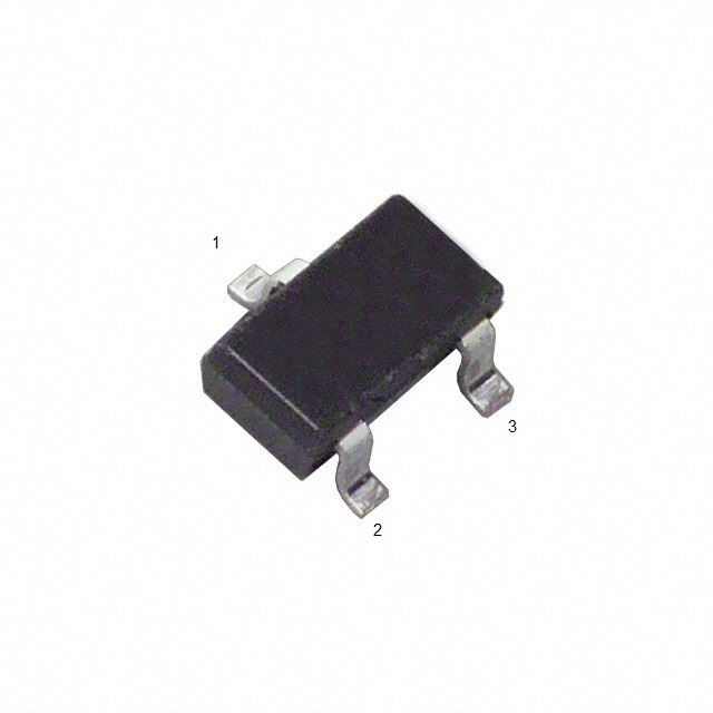

              Q6001: (S43)
              pin1 3.197
              pin2 3.028
              pin3 3.357
              Q6002: (K72)
              pin1 0 short to gnd
              pin2 3.028
              pin3 0 short to gnd
              so something is wrong with Q6002, should i try to replace it?
              i have no idea what is that transistor is, pin configuration, voltage and amps.
              i do have alot of spare boards, but i don't have the exact board to salvage.
                Thank you for the schematic

                    Did you checked R6006?? Remove Q6002 and measure resistance on mb pads. Perhaps you are getting voltage at the gate pin. Source is ground anyway. Drain is grounded as well which i think is wrong. Q6002 is N channel fet 2N7002K. You can search this code on other scrap boards with schematics to get one. G2101 is your RTCrst# pad. Its important to find it out.
